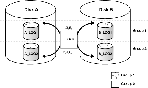

Multiplexing is implemented by creating groups of redo log files. A group consists of a redo log file and its multiplexed copies. Each identical copy is said to be a member of the group. Each redo log group is defined by a number, such as group 1, group 2, and so on.
In Figure 10-2, A_LOG1
and B_LOG1
are both members of Group 1, A_LOG2
and B_LOG2
are both members of Group 2, and so forth. Each member in a group must be exactly the same size.
Each member of a log file group is concurrently active—that is, concurrently written to by LGWR—as indicated by the identical log sequence numbers assigned by LGWR. In Figure 10-2, first LGWR writes concurrently to both A_LOG1
and B_LOG1
. Then it writes concurrently to both A_LOG2
and B_LOG2
, and so on. LGWR never writes concurrently to members of different groups (for example, to A_LOG1
and B_LOG2

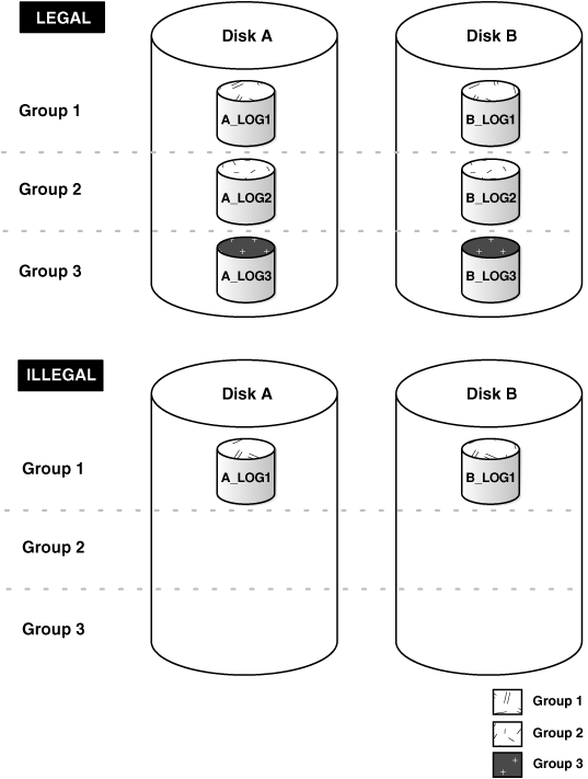

In most cases, a multiplexed redo log should be symmetrical: all groups of the redo log should have the same number of members. However, the database does not require that a multiplexed redo log be symmetrical. For example, one group can have only one member, and other groups can have two members. This configuration protects against disk failures that temporarily affect some redo log members but leave others intact.
The only requirement for an instance redo log is that it have at least two groups. Figure 10-3 shows legal and illegal multiplexed redo log configurations. The second configuration is illegal because it has only one group.
Figure 10-3 Legal and Illegal Multiplexed Redo Log Configuration
When setting up a multiplexed redo log, place members of a group on different physical disks. If a single disk fails, then only one member of a group becomes unavailable to LGWR and other members remain accessible to LGWR, so the instance can continue to function.
