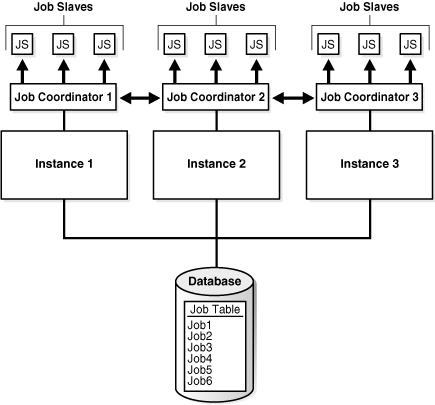

In a Real Application Clusters (RAC) environment, the Scheduler uses one job table for each database and one job coordinator for each instance. The job coordinators communicate with each other to keep information current. The Scheduler attempts to balance the load of the jobs of a job class across all available instances when the job class has no service affinity, or across the instances assigned to a particular service when the job class does have service affinity.
Figure 26-5 illustrates a typical RAC architecture, with each instance's job coordinator exchanging information with the others.
Figure 26-5 RAC Architecture and the Scheduler

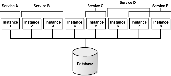

The Scheduler enables you to specify the database service under which a job should be run (service affinity). This ensures better availability than instance affinity because it guarantees that other nodes can be dynamically assigned to the service if an instance goes down. Instance affinity does not have this capability, so, when an instance goes down, none of the jobs with an affinity to that instance will be able to run until the instance comes back up. Figure 26-6 illustrates a typical example of how services and instances could be used.
Figure 26-6 Service Affinity and the Scheduler
In Figure 26-6, you could change the properties of the services and the Scheduler will automatically recognize the change.
Each job class can specify a database service. If a service is not specified, the job class belongs to an internal service that is guaranteed to be mapped to every running instance.
