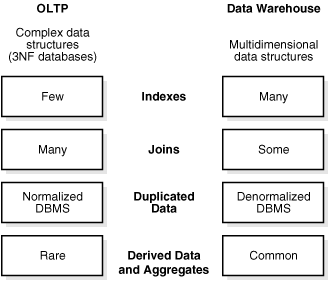

Figure 1-1 illustrates key differences between an OLTP system and a data warehouse.
Figure 1-1 Contrasting OLTP and Data Warehousing Environments
One major difference between the types of system is that data warehouses are not usually in third normal form (3NF), a type of data normalization common in OLTP environments.
Data warehouses and OLTP systems have very different requirements. Here are some examples of differences between typical data warehouses and OLTP systems:
Workload
Data warehouses are designed to accommodate ad hoc queries and data analysis. You might not know the workload of your data warehouse in advance, so a data warehouse should be optimized to perform well for a wide variety of possible query and analytical operations.
OLTP systems support only predefined operations. Your applications might be specifically tuned or designed to support only these operations.
Data modifications
A data warehouse is updated on a regular basis by the ETL process (run nightly or weekly) using bulk data modification techniques. The end users of a data warehouse do not directly update the data warehouse except when using analytical tools, such as data mining, to make predictions with associated probabilities, assign customers to market segments, and develop customer profiles.
In OLTP systems, end users routinely issue individual data modification statements to the database. The OLTP database is always up to date, and reflects the current state of each business transaction.
Schema design
Data warehouses often use denormalized or partially denormalized schemas (such as a star schema) to optimize query and analytical performance.
OLTP systems often use fully normalized schemas to optimize update/insert/delete performance, and to guarantee data consistency.
Typical operations
A typical data warehouse query scans thousands or millions of rows. For example, "Find the total sales for all customers last month."
A typical OLTP operation accesses only a handful of records. For example, "Retrieve the current order for this customer."
Historical data
Data warehouses usually store many months or years of data. This is to support historical analysis and reporting.
OLTP systems usually store data from only a few weeks or months. The OLTP system stores only historical data as needed to successfully meet the requirements of the current transaction.

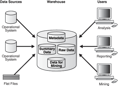

Figure 1-2 shows a simple architecture for a data warehouse. End users directly access data derived from several source systems through the data warehouse.
Figure 1-2 Architecture of a Data Warehouse
In Figure 1-2, the metadata and raw data of a traditional OLTP system is present, as is an additional type of data, summary data. Summaries are very valuable in data warehouses because they pre-compute long operations in advance. For example, a typical data warehouse query is to retrieve something such as August sales. A summary in an Oracle database is called a materialized view.

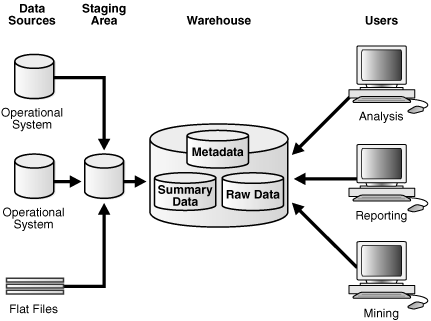

You need to clean and process your operational data before putting it into the warehouse, as shown in Figure 1-2. You can do this programmatically, although most data warehouses use a staging area instead. A staging area simplifies building summaries and general warehouse management. Figure 1-3 illustrates this typical architecture.
Figure 1-3 Architecture of a Data Warehouse with a Staging Area

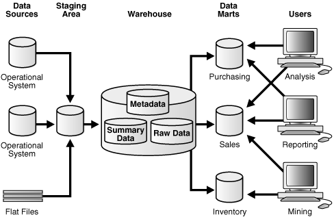

Although the architecture in Figure 1-3 is quite common, you may want to customize your warehouse's architecture for different groups within your organization. You can do this by adding data marts, which are systems designed for a particular line of business. Figure 1-4 illustrates an example where purchasing, sales, and inventories are separated. In this example, a financial analyst might want to analyze historical data for purchases and sales or mine historical data to make predictions about customer behavior.
Figure 1-4 Architecture of a Data Warehouse with a Staging Area and Data Marts
Data marts are an important part of many data warehouses, but they are not the focus of this book.You can extract information from the masses of data stored in a data warehouse by analyzing the data. The Oracle Database provides several ways to analyze data:
