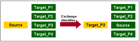

Figure 6-1 Overview of Partition Exchange Loading
In Figure 5–8, data from a source table Source
is inserted into a target table consisting of four partitions (Target_P1
, Target_P2
, Target_P3
, and Target_P4
). If the new data needs to be loaded into Target_P3
, the partition exchange operation only exchanges the names on the data objects without moving the actual data. After the exchange, the formerly labeled Source
is renamed to Target_P3
, and the former Target_P3
is now labeled as Source
. The target table still contains four partitions: Target_P1
, Target_P2
, Target_P3
, and Target_P4
. The partition exchange operation available in Oracle 9i completes the loading process without data movement.

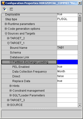

In the Project Explorer, right-click a mapping and select Configure.
Warehouse Builder displays the Configuration Properties window.
By default, Partition Exchange Loading is disabled for all mappings. Select PEL Enabled to use Partition Exchange Loading.
Use Data Collection Frequency to specify the amount of new data to be collected for each run of the mapping. Set this parameter to specify if you want the data collected by Year, Quarter, Month, Day, Hour, or Minute. This determines the number of partitions.
Select Direct if you want to create a temporary table to stage the collected data before performing the partition exchange. If you do not select this parameter, Warehouse Builder directly swaps the source table into the target table as a partition without creating a temporary table.
If you select Replace Data, Warehouse Builder replaces the existing data in the target partition with the newly collected data. If you do not select it, Warehouse Builder preserves the existing data in the target partition. The new data is inserted into a non-empty partition. This parameter affects the local partition and can be used to remove or swap a partition out of a target table. At the table level, you can set Truncate/Insert properties.

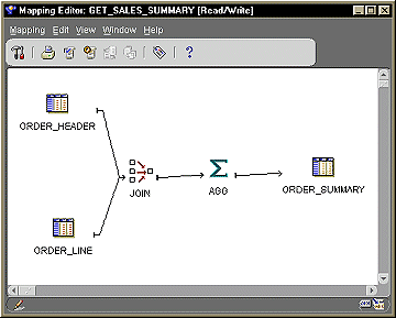

For example, assume that you have the same mapping from Figure 5–10 but would like greater control on when data is loaded into the target. Depending on the amount of data, it could take hours to load and you would not know precisely when the target table would be updated.
To instantly load data to a target using Direct PEL:
Design one mapping to join source data, if necessary, transform data, ensure data validity, and load it to a staging table. Do not configure this mapping to use PEL.
Design the staging table to exactly match the structure of the final target that you will load in a separate mapping. For example, the staging table in Figure 5–10 is ORDER_SUMMARY and should be of the same structure as the final target, ORDER_CUBE in Figure 5–11.

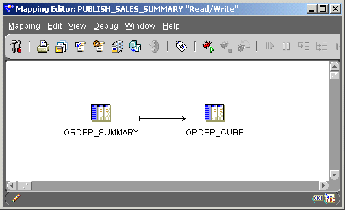

Create a second mapping that loads data from the staging table to the final target such as shown in Figure 5–11. Configure this mapping to use Direct PEL.
Use either the Warehouse Builder Process Flow Editor or Oracle Workflow to launch the second mapping after the completion of the first.

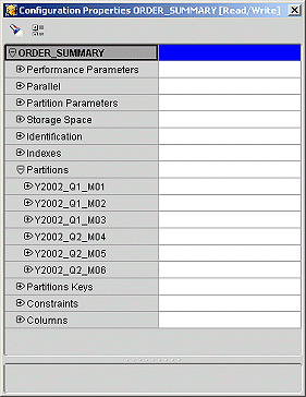

Warehouse Builder does not automatically create partitions during runtime. Before you can use Partition Exchange Loading, you must create all partitions.
For example, if you select Month as the frequency of new data collection, you need to create all the required partitions for each month of new data. Use the Data Object Editor to create partitions for a table, dimension, or cube.

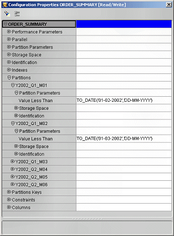

Figure 6–5 shows the property inspector window for table ORDER_SUMMARY. This figure shows six partitions that have been added for this table.
To use Partition Exchange Loading, all partition names must follow a naming convention. For example, for a partition that will hold data for May 2002, the partition name must be in the format Y2002_Q2_M05.

Figure 6-5 Configuration Properties for Table ORDER_SUMMARY
If you correctly name each partition, Warehouse Builder automatically computes the Value Less Than property for each partition. Otherwise, you must manually configure Value Less Than for each partition for Warehouse Builder to generate a DDL statement. The following is an example of a DDL statement generated by Warehouse Builder:
. . . PARTITION A_PARTITION_NAME VALUES LESS THAN (TO_DATE('01-06-2002','DD-MM-YYYY')), . . .
Figure 5–13 shows automatically generated configuration values for the Value Less Than parameter.
Figure 6-6 Automatically Generated "Value Less Than" Setting

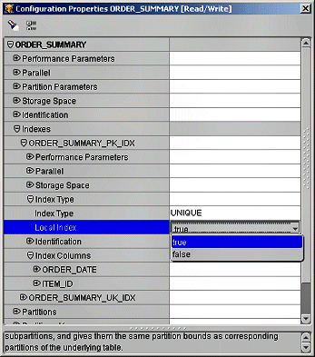

Figure 5–14 shows an index (ORDER_SUMMARY_PK_IDX) added to the ORDER_SUMMARY table. This index has two columns, ORDER_DATE and ITEM_ID. Configure the following:
Set the Index Type parameter to UNIQUE.
Set the Local Index parameter to True.
Now Warehouse Builder can generate a DDL statement for a unique local index on table ORDER_SUMMARY.
Using local indexes provides the most important PEL performance benefit. Local indexes require all indexes to be partitioned in the same way as the table. When the temporary table is swapped into the target table using PEL, so are the identities of the index segments.
Figure 6-7 Configure an Index as a Local Index
If an index is created as a local index, the Oracle server requires that the partition key column must be the leading column of the index. In the preceding example, the partition key is ORDER_DATE and it is the leading column in the index ORDER_SUMMARY_PK_IDX.

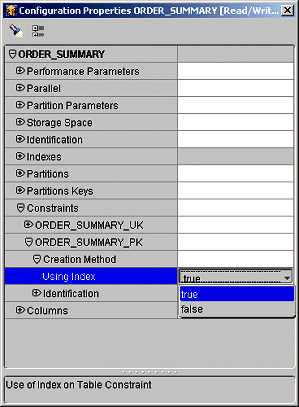

In this step you must specify that all primary key and unique key constraints are created with the USING INDEX option. Figure 5–15 shows an example where the primary key constraint ORDER_SUMMARY_PK on the ORDER_SUMMARY table is specified with the USING INDEX option.
With the USING INDEX option, a constraint will not trigger automatic index creation when it is added to the table. The server will search existing indexes for an index with same column list as that of the constraint. Thus, each primary or unique key constraint must be backed by a user-defined unique local index. The index required by the constraint ORDER_SUMMARY_PK is ORDER_SUMMARY_PK_IDX which was created in "Step 2: Create All Indexes Using the LOCAL Option".
Figure 6-8 Specify a Constraint with USING INDEX option
