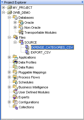

Notice that in the demonstration, the Project Explorer displays on the left side and includes two projects. MY_PROJECT
is a default, pre-seeded project. You can use MY_PROJECT as your single active project in the workspace. For the purposes of the demonstration, we work in the OWB_DEMO
project.
This example illustrates how to import metadata from flat files. Specifically, our objective is to import the metadata into the OWB_DEMO
project such that the two files, export.csv
and expense_categories.csv
, display in the Project Explorer under the Files node.

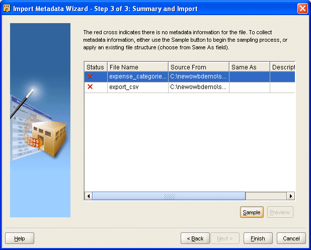

Launch the Import Metadata Wizard.
Right-click on the module SALES_EXPENSES, select New, and follow the prompts in the Import Metadata Wizard. The prompts in the wizard vary according to the type of module you selected and therefore the type of data object you are importing.
In this example, you selected to import two flat files. On the summary page of the Import Metadata Wizard, select one of the files and then select Sample to launch the Flat File Sample Wizard.
In the next steps, you sample each file in turn and then select Finish on this page to import the metadata.

After sampling the first flat file, return to the Summary and Import page of Metadata Import Wizard to sample the second file.
Accept the default setting in the Flat File Wizard as you did for the previous file.
Import the metadata for both flat files.
Return again to the Summary and Import page and select Finish.
When you select Finish, the wizard imports the data based on the selections you made when sampling the data. The two comma separated files now display under the SALES_EXPENSES
module which is under the Files node in OWB_DEMO
project.
