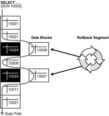

Oracle Database automatically provides read consistency to a query so that all the data that the query sees comes from a single point in time (statement-level read consistency). Oracle Database can also provide read consistency to all of the queries in a transaction (transaction-level read consistency).
Oracle Database uses the information maintained in its rollback segments to provide these consistent views. The rollback segments contain the old values of data that have been changed by uncommitted or recently committed transactions. Figure 13-1 shows how Oracle Database provides statement-level read consistency using data in rollback segments.
Figure 13-1 Transactions and Read Consistency
As a query enters the execution stage, the current system change number (SCN) is determined. In Figure 13-1, this system change number is 10023. As data blocks are read on behalf of the query, only blocks written with the observed SCN are used. Blocks with changed data (more recent SCNs) are reconstructed from data in the rollback segments, and the reconstructed data is returned for the query. Therefore, each query returns all committed data with respect to the SCN recorded at the time that query execution began. Changes of other transactions that occur during a query's execution are not observed, guaranteeing that consistent data is returned for each query.
Oracle Database always enforces statement-level read consistency. This guarantees that all the data returned by a single query comes from a single point in time—the time that the query began. Therefore, a query never sees dirty data or any of the changes made by transactions that commit during query execution. As query execution proceeds, only data committed before the query began is visible to the query. The query does not see changes committed after statement execution begins.
A consistent result set is provided for every query, guaranteeing data consistency, with no action on the user's part. The SQL statements SELECT, INSERT with a subquery, UPDATE, and DELETE all query data, either explicitly or implicitly, and all return consistent data. Each of these statements uses a query to determine which data it will affect (SELECT, INSERT, UPDATE, or DELETE, respectively).

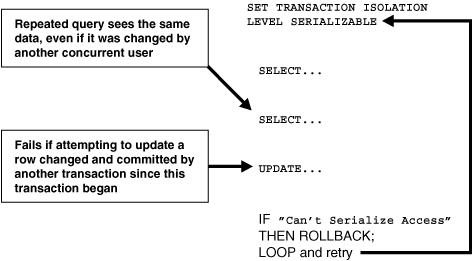

Serializable isolation permits concurrent transactions to make only those database changes they could have made if the transactions had been scheduled to run one after another. Specifically, Oracle Database permits a serializable transaction to modify a data row only if it can determine that prior changes to the row were made by transactions that had committed when the serializable transaction began.
To make this determination efficiently, Oracle Database uses control information stored in the data block that indicates which rows in the block contain committed and uncommitted changes. In a sense, the block contains a recent history of transactions that affected each row in the block. The amount of history that is retained is controlled by the INITRANS parameter of CREATE TABLE and ALTER TABLE.
Under some circumstances, Oracle Database can have insufficient history information to determine whether a row has been updated by a too recent transaction. This can occur when many transactions concurrently modify the same data block, or do so in a very short period. You can avoid this situation by setting higher values of INITRANS for tables that will experience many transactions updating the same blocks. Doing so enables Oracle Database to allocate sufficient storage in each block to record the history of recent transactions that accessed the block.
Oracle Database generates an error when a serializable transaction tries to update or delete data modified by a transaction that commits after the serializable transaction began:
ORA-08177: Cannot serialize access for this transaction
When a serializable transaction fails with the Cannot serialize access error, the application can take any of several actions:
Commit the work executed to that point
Execute additional (but different) statements (perhaps after rolling back to a savepoint established earlier in the transaction)
Undo the entire transaction
Figure 13-2 shows an example of an application that rolls back and retries the transaction after it fails with the Cannot serialize access error:
Figure 13-2 Serializable Transaction Failure

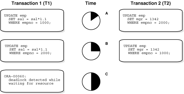

"Table Locks (TM)"A deadlock can occur when two or more users are waiting for data locked by each other. Deadlocks prevent some transactions from continuing to work. Figure 13-3 is a hypothetical illustration of two transactions in a deadlock.
In Figure 13-3, no problem exists at time point A, as each transaction has a row lock on the row it attempts to update. Each transaction proceeds without being terminated. However, each tries next to update the row currently held by the other transaction. Therefore, a deadlock results at time point B, because neither transaction can obtain the resource it must proceed or terminate. It is a deadlock because no matter how long each transaction waits, the conflicting locks are held.
Figure 13-3 Two Transactions in a Deadlock
This section includes the following topics:
Oracle Database automatically detects deadlock situations and resolves them by rolling back one of the statements involved in the deadlock, thereby releasing one set of the conflicting row locks. A corresponding message also is returned to the transaction that undergoes statement-level rollback. The statement rolled back is the one belonging to the transaction that detects the deadlock. Usually, the signalled transaction should be rolled back explicitly, but it can retry the rolled-back statement after waiting.
