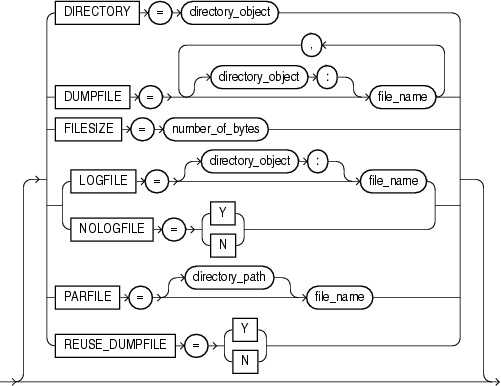

Although it is possible to specify multiple files using the DUMPFILE parameter, the export job may only require a subset of those files to hold the exported data. The dump file set displayed at the end of the export job shows exactly which files were used. It is this list of files that is required in order to perform an import operation using this dump file set.
Any resulting dump file names that match preexisting dump file names will generate an error and the preexisting dump files will not be overwritten. You can override this behavior by specifying the Export parameter REUSE_DUMPFILES=Y.
The following is an example of using the DUMPFILE parameter:
> expdp hr SCHEMAS=hr DIRECTORY=dpump_dir1 DUMPFILE=dpump_dir2:exp1.dmp, exp2%U.dmp PARALLEL=3
The dump file, exp1.dmp, will be written to the path associated with the directory object dpump_dir2 because dpump_dir2 was specified as part of the dump file name, and therefore overrides the directory object specified with the DIRECTORY parameter. Because all three parallel processes will be given work to perform during this job, the exp201.dmp and exp202.dmp dump files will be created and they will be written to the path associated with the directory object, dpump_dir1, that was specified with the DIRECTORY parameter.

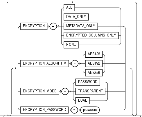

Default: The default value depends upon the combination of encryption-related parameters that are used. To enable encryption, either the ENCRYPTION or ENCRYPTION_PASSWORD parameter, or both, must be specified. If only the ENCRYPTION_PASSWORD parameter is specified, then the ENCRYPTION parameter defaults to ALL. If neither ENCRYPTION nor ENCRYPTION_PASSWORD is specified, then ENCRYPTION defaults to NONE.
Specifies whether or not to encrypt data before writing it to the dump file set.
ENCRYPTION = {ALL | DATA_ONLY | ENCRYPTED_COLUMNS_ONLY | METADATA_ONLY | NONE}
ALL enables encryption for all data and metadata in the export operation.
DATA_ONLY specifies that only data is written to the dump file set in encrypted format.
ENCRYPTED_COLUMNS_ONLY specifies that only encrypted columns are written to the dump file set in encrypted format.
METADATA_ONLY specifies that only metadata is written to the dump file set in encrypted format.
NONE specifies that no data is written to the dump file set in encrypted format.
If the data being exported includes SecureFiles that you want to be encrypted, then you must specifyENCRYPTION=ALL to encrypt the entire dump file set. Encryption of the entire dump file set is the only way to achieve encryption security for SecureFiles during a Data Pump export operation. For more information about SecureFiles, see Oracle Database SecureFiles and Large Objects Developer's Guide.To specify the ALL, DATA_ONLY, or METADATA_ONLY options, the COMPATIBLE initialization parameter must be set to at least 11.0.0.
This parameter is valid only in the Enterprise Edition of Oracle Database 11g.
The following example performs an export operation in which only data is encrypted in the dump file:
> expdp hr DIRECTORY=dpump_dir1 DUMPFILE=hr_enc.dmp JOB_NAME=enc1 ENCRYPTION=data_only ENCRYPTION_PASSWORD=foobar
Default: AES128
Specifies which cryptographic algorithm should be used to perform the encryption.
ENCRYPTION_ALGORITHM = { AES128 | AES192 | AES256 }
See Oracle Database Advanced Security Administrator's Guide for information about encryption algorithms.
To use this encryption feature, the COMPATIBLE initialization parameter must be set to at least 11.0.0.
The ENCRYPTION_ALGORITHM parameter requires that you also specify either the ENCRYPTION or ENCRYPTION_PASSWORD parameter; otherwise an error is returned.
> expdp hr DIRECTORY=dpump_dir1 DUMPFILE=hr_enc.dmp ENCRYPTION_PASSWORD=foobar ENCRYPTION_ALGORITHM=AES128
Default: The default mode depends on which other encryption-related parameters are used. If only the ENCRYPTION parameter is specified, then the default mode is TRANSPARENT. If the ENCRYPTION_PASSWORD parameter is specified and the Oracle Encryption Wallet is open, then the default is DUAL. If the ENCRYPTION_PASSWORD parameter is specified and the Oracle Encryption Wallet is closed, then the default is PASSWORD.
Specifies the type of security to use when encryption and decryption are performed.
ENCRYPTION_MODE = { DUAL | PASSWORD | TRANSPARENT }
DUAL mode creates a dump file set that can later be imported either transparently or by specifying a password that was used when the dual-mode encrypted dump file set was created. When you later import the dump file set created in DUAL mode, you can use either the Oracle Encryption Wallet or the password that was specified with the ENCRYPTION_PASSWORD parameter. DUAL mode is best suited for cases in which the dump file set will be imported onsite using the Oracle Encryption Wallet, but which may also need to be imported offsite where the Oracle Encryption Wallet is not available.
PASSWORD mode requires that you provide a password when creating encrypted dump file sets. You will need to provide the same password when you import the dump file set. PASSWORD mode requires that you also specify the ENCRYPTION_PASSWORD parameter. The PASSWORD mode is best suited for cases in which the dump file set will be imported into a different or remote database, but which must remain secure in transit.
TRANSPARENT mode allows an encrypted dump file set to be created without any intervention from a database administrator (DBA), provided the required Oracle Encryption Wallet is available. Therefore, the ENCRYPTION_PASSWORD parameter is not required, and will in fact, cause an error if it is used in TRANSPARENT mode. This encryption mode is best suited for cases in which the dump file set will be imported into the same database from which it was exported.
To use DUAL or TRANSPARENT mode, the COMPATIBLE initialization parameter must be set to at least 11.0.0.
When you use the ENCRYPTION_MODE parameter, you must also use either the ENCRYPTION or ENCRYPTION_PASSWORD parameter. Otherwise, an error is returned.
> expdp hr DIRECTORY=dpump_dir1 DUMPFILE=hr_enc.dmp ENCRYPTION=all ENCRYPTION_PASSWORD=secretwords ENCRYPTION_ALGORITHM=AES256 ENCRYPTION_MODE=dual
Default: There is no default; the value is user-provided.
Specifies a password for encrypting encrypted column data, metadata, or table data in the export dumpfile. This prevents unauthorized access to an encrypted dump file set.
Data Pump encryption functionality has changed as of Oracle Database 11g release 1 (11.1). Prior to release 11.1, theENCRYPTION_PASSWORD parameter applied only to encrypted columns. However, as of release 11.1, the new ENCRYPTION parameter provides options for encrypting other types of data. This means that if you now specify ENCRYPTION_PASSWORD without also specifying ENCRYPTION and a specific option, then all data written to the dump file will be encrypted (equivalent to specifying ENCRYPTION=ALL). If you want to re-encrypt only encrypted columns, you must now specify ENCRYPTION=ENCRYPTED_COLUMNS_ONLY in addition to ENCRYPTION_PASSWORD.
ENCRYPTION_PASSWORD = password
The password value that is supplied specifies a key for re-encrypting encrypted table columns, metadata, or table data so that they are not written as clear text in the dump file set. If the export operation involves encrypted table columns, but an encryption password is not supplied, then the encrypted columns will be written to the dump file set as clear text and a warning will be issued.
For export operations, this parameter is required if the ENCRYPTION_MODE parameter is set to either PASSWORD or DUAL.
There is no connection or dependency between the key specified with the Data PumpENCRYPTION_PASSWORD parameter and the key specified with the ENCRYPT keyword when the table with encrypted columns was initially created. For example, suppose a table is created as follows, with an encrypted column whose key is xyz:
CREATE TABLE emp (col1 VARCHAR2(256) ENCRYPT IDENTIFIED BY "xyz");
When you export the emp table, you can supply any arbitrary value for ENCRYPTION_PASSWORD. It does not have to be xyz.
If ENCRYPTION_PASSWORD is specified but ENCRYPTION_MODE is not specified, then it is not necessary to have the Transparent Data Encryption option set up since ENCRYPTION_MODE will default to PASSWORD.
The ENCRYPTION_PASSWORD parameter is not valid if the requested encryption mode is TRANSPARENT.
To use the ENCRYPTION_PASSWORD parameter if ENCRYPTION_MODE is set to DUAL, you must have the Transparent Data Encryption option set up. See Oracle Database Advanced Security Administrator's Guide for more information about the Transparent Data Encryption option.
For network exports, the ENCRYPTION_PASSWORD parameter in conjunction with ENCRYPTED_COLUMNS_ONLY is not supported with user-defined external tables that have encrypted columns. The table will be skipped and an error message will be displayed, but the job will continue.
Encryption attributes for all columns must match between the exported table definition and the target table. For example, suppose you have a table, EMP, and one of its columns is named EMPNO. Both of the following situations would result in an error because the encryption attribute for the EMP column in the source table would not match the encryption attribute for the EMP column in the target table:
The EMP table is exported with the EMPNO column being encrypted, but prior to importing the table you remove the encryption attribute from the EMPNO column.
The EMP table is exported without the EMPNO column being encrypted, but prior to importing the table you enable encryption on the EMPNO column.
In the following example, an encryption password, 123456, is assigned to the dump file, dpcd2be1.dmp.
expdp hr TABLES=employee_s_encrypt DIRECTORY=dpump_dir DUMPFILE=dpcd2be1.dmp ENCRYPTION=ENCRYPTED_COLUMNS_ONLY ENCRYPTION_PASSWORD=123456
Encrypted columns in the employee_s_encrypt table, will not be written as clear text in the dpcd2be1.dmp dump file. Note that in order to subsequently import the dpcd2be1.dmp file created by this example, you will need to supply the same encryption password. (See "ENCRYPTION_PASSWORD" for an example of an import operation using the ENCRYPTION_PASSWORD parameter.)

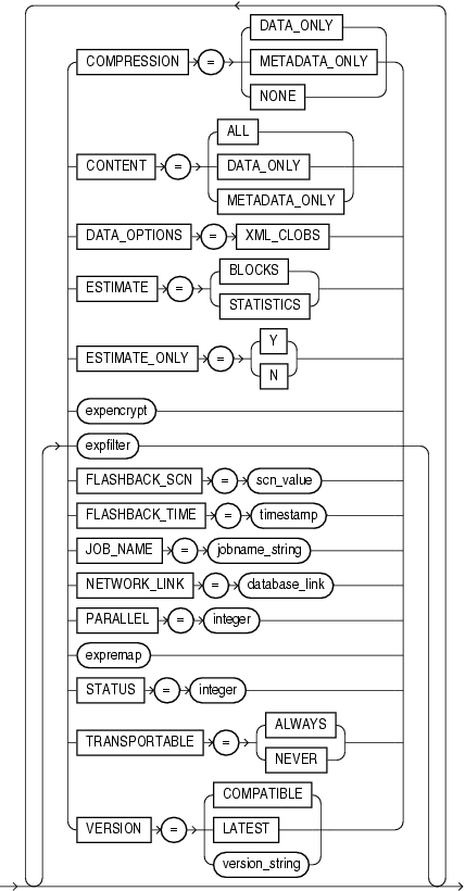

Default: BLOCKS
Specifies the method that Export will use to estimate how much disk space each table in the export job will consume (in bytes). The estimate is printed in the log file and displayed on the client's standard output device. The estimate is for table row data only; it does not include metadata.
ESTIMATE={BLOCKS | STATISTICS}
BLOCKS - The estimate is calculated by multiplying the number of database blocks used by the source objects, times the appropriate block sizes.
STATISTICS - The estimate is calculated using statistics for each table. For this method to be as accurate as possible, all tables should have been analyzed recently.
If the Data Pump export job involves compressed tables, the default size estimation given for the compressed table is inaccurate when ESTIMATE=BLOCKS is used. This is because the size estimate does not reflect that the data was stored in a compressed form. To get a more accurate size estimate for compressed tables, use ESTIMATE=STATISTICS.
The estimate may also be inaccurate if the QUERY, SAMPLE, or REMAP_DATA parameter is used.
The following example shows a use of the ESTIMATE parameter in which the estimate is calculated using statistics for the employees table:
> expdp hr TABLES=employees ESTIMATE=STATISTICS DIRECTORY=dpump_dir1 DUMPFILE=estimate_stat.dmp
Default: n
Instructs Export to estimate the space that a job would consume, without actually performing the export operation.
ESTIMATE_ONLY={y | n}
If ESTIMATE_ONLY=y, then Export estimates the space that would be consumed, but quits without actually performing the export operation.
The following shows an example of using the ESTIMATE_ONLY parameter to determine how much space an export of the HR schema will take.
> expdp hr ESTIMATE_ONLY=y NOLOGFILE=y SCHEMAS=HR

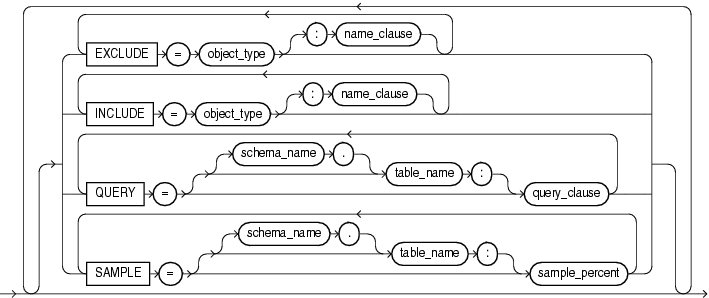

Enables you to filter the metadata that is exported by specifying objects and object types that you want excluded from the export operation.
EXCLUDE=object_type[:name_clause] [, ...]
All object types for the given mode of export will be included except those specified in an EXCLUDE statement. If an object is excluded, all of its dependent objects are also excluded. For example, excluding a table will also exclude all indexes and triggers on the table.
The name_clause is optional. It allows selection of specific objects within an object type. It is a SQL expression used as a filter on the type's object names. It consists of a SQL operator and the values against which the object names of the specified type are to be compared. The name clause applies only to object types whose instances have names (for example, it is applicable to TABLE, but not to GRANT). The name clause must be separated from the object type with a colon and enclosed in double quotation marks, because single-quotation marks are required to delimit the name strings. For example, you could set EXCLUDE=INDEX:"LIKE 'EMP%'" to exclude all indexes whose names start with EMP.
If no name_clause is provided, all objects of the specified type are excluded.
More than one EXCLUDE statement can be specified.
Oracle recommends that you place EXCLUDE clauses in a parameter file to avoid having to use escape characters on the command line.
See Also:
INCLUDE for an example of using a parameter file
If the object_type you specify is CONSTRAINT, GRANT, or USER, you should be aware of the effects this will have, as described in the following paragraphs.
The following constraints cannot be explicitly excluded:
NOT NULL constraints
Constraints needed for the table to be created and loaded successfully; for example, primary key constraints for index-organized tables, or REF SCOPE and WITH ROWID constraints for tables with REF columns
This means that the following EXCLUDE statements will be interpreted as follows:
EXCLUDE=CONSTRAINT will exclude all (nonreferential) constraints, except for NOT NULL constraints and any constraints needed for successful table creation and loading.
EXCLUDE=REF_CONSTRAINT will exclude referential integrity (foreign key) constraints.
Specifying EXCLUDE=GRANT excludes object grants on all object types and system privilege grants.
Specifying EXCLUDE=USER excludes only the definitions of users, not the objects contained within users' schemas.
To exclude a specific user and all objects of that user, specify a filter such as the following (where hr is the schema name of the user you want to exclude):
EXCLUDE=SCHEMA:"='HR'"
If you try to exclude a user by using a statement such as EXCLUDE=USER:"='HR'", then only the information used in CREATE USER hr DDL statements will be excluded, and you may not get the results you expect.
The EXCLUDE and INCLUDE parameters are mutually exclusive.
The following is an example of using the EXCLUDE statement.
> expdp hr DIRECTORY=dpump_dir1 DUMPFILE=hr_exclude.dmp EXCLUDE=VIEW, PACKAGE, FUNCTION
This will result in a schema-mode export in which all of the hr schema will be exported except its views, packages, and functions.
See Also:
Filtering During Export Operations for more information about the effects of using the EXCLUDE parameter

Specifies the system change number (SCN) that Export will use to enable the Flashback Query utility.
FLASHBACK_SCN=scn_value
The export operation is performed with data that is consistent as of the specified SCN. If the NETWORK_LINK parameter is specified, the SCN refers to the SCN of the source database.
FLASHBACK_SCN and FLASHBACK_TIME are mutually exclusive.
The FLASHBACK_SCN parameter pertains only to the Flashback Query capability of Oracle Database. It is not applicable to Flashback Database, Flashback Drop, or Flashback Data Archive.
The following example assumes that an existing SCN value of 384632 exists. It exports the hr schema up to SCN 384632.
> expdp hr DIRECTORY=dpump_dir1 DUMPFILE=hr_scn.dmp FLASHBACK_SCN=384632
If you are on a logical standby system and using a network link to access the logical standby primary, theFLASHBACK_SCN parameter is ignored because SCNs are selected by logical standby. See Oracle Data Guard Concepts and Administration for information about logical standby databases.Default: There is no default
The SCN that most closely matches the specified time is found, and this SCN is used to enable the Flashback utility. The export operation is performed with data that is consistent as of this SCN.
FLASHBACK_TIME="TO_TIMESTAMP(time-value)"
Because the TO_TIMESTAMP value is enclosed in quotation marks, it would be best to put this parameter in a parameter file. Otherwise, you might need to use escape characters on the command line in front of the quotation marks. See Use of Quotation Marks On the Data Pump Command Line.
FLASHBACK_TIME and FLASHBACK_SCN are mutually exclusive.
The FLASHBACK_TIME parameter pertains only to the flashback query capability of Oracle Database. It is not applicable to Flashback Database, Flashback Drop, or Flashback Data Archive.
You can specify the time in any format that the DBMS_FLASHBACK.ENABLE_AT_TIME procedure accepts. For example, suppose you have a parameter file, flashback.par, with the following contents:
DUMPFILE=hr_time.dmp
FLASHBACK_TIME="TO_TIMESTAMP('25-08-2003 14:35:00', 'DD-MM-YYYY HH24:MI:SS')"
You could then issue the following command:
> expdp hr PARFILE=flashback.par
The export operation will be performed with data that is consistent with the SCN that most closely matches the specified time.
If you are on a logical standby system and using a network link to access the logical standby primary, theFLASHBACK_SCN parameter is ignored because SCNs are selected by logical standby. See Oracle Data Guard Concepts and Administration for information about logical standby databases.See Also:
Oracle Database Advanced Application Developer's Guide for information about using Flashback QueryDefault: n

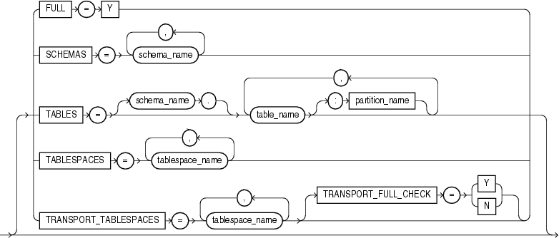

Specifies that you want to perform a full database mode export.
FULL={y | n}
FULL=y indicates that all data and metadata are to be exported. Filtering can restrict what is exported using this export mode. See Filtering During Export Operations.
To perform a full export, you must have the EXP_FULL_DATABASE role.
Be aware that when you later import a dump file that was created by a full-mode export, the import operation attempts to copy the password for theSYS account from the source database. This sometimes fails (for example, if the password is in a shared password file). If it does fail, then after the import completes, you must set the password for the SYS account at the target database to a password of your choiceA full export does not export system schemas that contain Oracle-managed data and metadata. Examples of system schemas that are not exported include SYS, ORDSYS, and MDSYS.
Grants on objects owned by the SYS schema are never exported.
If you are exporting data that is protected by a realm, you must have authorization for that realm.
See Also:
Oracle Database Vault Administrator's Guide for information about configuring realmsThe following is an example of using the FULL parameter. The dump file, expfull.dmp is written to the dpump_dir2 directory.
> expdp hr DIRECTORY=dpump_dir2 DUMPFILE=expfull.dmp FULL=y NOLOGFILE=y
Enables you to filter the metadata that is exported by specifying objects and object types for the current export mode. The specified objects and all their dependent objects are exported. Grants on these objects are also exported.
INCLUDE = object_type[:name_clause] [, ...]
Only object types explicitly specified in INCLUDE statements, and their dependent objects, are exported. No other object types, including the schema definition information that is normally part of a schema-mode export when you have the EXP_FULL_DATABASE role, are exported.
To see a list of valid paths for use with the INCLUDE parameter, you can query the following views: DATABASE_EXPORT_OBJECTS for Full mode, SCHEMA_EXPORT_OBJECTS for schema mode, and TABLE_EXPORT_OBJECTS for table and tablespace mode.
The name_clause is optional. It allows fine-grained selection of specific objects within an object type. It is a SQL expression used as a filter on the object names of the type. It consists of a SQL operator and the values against which the object names of the specified type are to be compared. The name clause applies only to object types whose instances have names (for example, it is applicable to TABLE, but not to GRANT). The optional name clause must be separated from the object type with a colon and enclosed in double quotation marks, because single-quotation marks are required to delimit the name strings.
Oracle recommends that INCLUDE statements be placed in a parameter file; otherwise you might have to use operating system-specific escape characters on the command line before quotation marks. See Use of Quotation Marks On the Data Pump Command Line.
For example, suppose you have a parameter file named hr.par with the following content:
SCHEMAS=HR
DUMPFILE=expinclude.dmp
LOGFILE=expinclude.log
INCLUDE=TABLE:"IN ('EMPLOYEES', 'DEPARTMENTS')"
INCLUDE=PROCEDURE
INCLUDE=INDEX:"LIKE 'EMP%'"
You could then use the hr.par file to start an export operation, without having to enter any other parameters on the command line:
> expdp hr parfile=hr.par
If the object_type you specify is a CONSTRAINT, you should be aware of the effects this will have.
The following constraints cannot be explicitly included:
This means that the following INCLUDE statements will be interpreted as follows:
INCLUDE=CONSTRAINT will include all (nonreferential) constraints, except for NOT NULL constraints and any constraints needed for successful table creation and loading.
INCLUDE=REF_CONSTRAINT will include referential integrity (foreign key) constraints.
The INCLUDE and EXCLUDE parameters are mutually exclusive.
The following example performs an export of all tables (and their dependent objects) in the hr schema:
> expdp hr INCLUDE=TABLE DUMPFILE=dpump_dir1:exp_inc.dmp NOLOGFILE=y

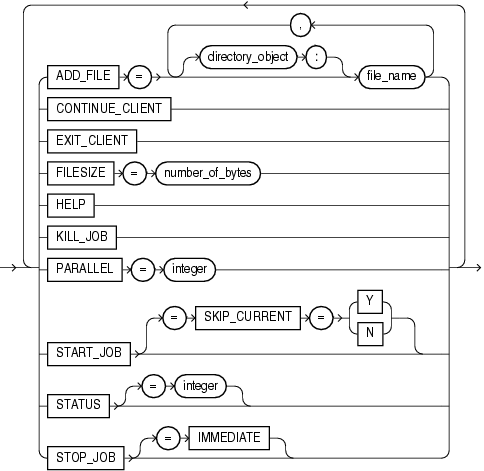

Table 2-2 lists the activities you can perform for the current job from the Data Pump Export prompt in interactive-command mode.
Table 2-2 Supported Activities in Data Pump Export's Interactive-Command Mode
| Activity | Command Used |
| Add additional dump files. | |
| Exit interactive mode and enter logging mode. | |
| Stop the export client session, but leave the job running. | |
| Redefine the default size to be used for any subsequent dump files. | |
| Display a summary of available commands. | |
| Detach all currently attached client sessions and kill the current job. | |
| Increase or decrease the number of active worker processes for the current job. This command is valid only in the Enterprise Edition of Oracle Database 11g. | |
| Restart a stopped job to which you are attached. | |
| Display detailed status for the current job and/or set status interval. | |
| Stop the current job for later restart. |
The following are descriptions of the commands available in the interactive-command mode of Data Pump Export.
Adds additional files or substitution variables to the export dump file set.
ADD_FILE=[directory_object:]file_name [,...]
The file_name must not contain any directory path information. However, it can include a substitution variable, %U, which indicates that multiple files may be generated using the specified filename as a template. It can also specify another directory_object.
The size of the file being added is determined by the setting of the FILESIZE parameter.
See Also:
File Allocation for information about the effects of using substitution variablesThe following example adds two dump files to the dump file set. A directory object is not specified for the dump file named hr2.dmp, so the default directory object for the job is assumed. A different directory object, dpump_dir2, is specified for the dump file named hr3.dmp.
Export> ADD_FILE=hr2.dmp, dpump_dir2:hr3.dmp
Changes the Export mode from interactive-command mode to logging mode.
CONTINUE_CLIENT
In logging mode, status is continually output to the terminal. If the job is currently stopped, then CONTINUE_CLIENT will also cause the client to attempt to start the job.
Export> CONTINUE_CLIENT
Stops the export client session, exits Export, and discontinues logging to the terminal, but leaves the current job running.
EXIT_CLIENT
Because EXIT_CLIENT leaves the job running, you can attach to the job at a later time. To see the status of the job, you can monitor the log file for the job or you can query the USER_DATAPUMP_JOBS view or the V$SESSION_LONGOPS view.
Export> EXIT_CLIENT
Redefines the default size to be used for any subsequent dump files.
FILESIZE=number
The file size can be followed by B, K, M, or G to indicate that the size is expressed in bytes, kilobytes, megabytes, or gigabytes, respectively. The default is B.
A file size of 0 indicates that there will not be any size restrictions on new dump files. They will be extended as needed until the limits of the containing device are reached.
Export> FILESIZE=100M
Provides information about Data Pump Export commands available in interactive-command mode.
HELP
Displays information about the commands available in interactive-command mode.
Export> HELP
Detaches all currently attached client sessions and then kills the current job. It exits Export and returns to the terminal prompt.
KILL_JOB
A job that is killed using KILL_JOB cannot be restarted. All attached clients, including the one issuing the KILL_JOB command, receive a warning that the job is being killed by the current user and are then detached. After all clients are detached, the job's process structure is immediately run down and the master table and dump files are deleted. Log files are not deleted.
Export> KILL_JOB
Enables you to increase or decrease the number of active processes (worker and parallel slaves) for the current job.
PARALLEL=integer
PARALLEL is available as both a command-line parameter and as an interactive-command mode parameter. (It is only available in Enterprise Edition.) You set it to the desired number of parallel processes (worker and parallel slaves). An increase takes effect immediately if there are sufficient files and resources. A decrease does not take effect until an existing process finishes its current task. If the value is decreased, workers are idled but not deleted until the job exits.
See Also:
PARALLEL for more information about parallelismExport> PARALLEL=10
Starts the current job to which you are attached.
START_JOB
The START_JOB command restarts the current job to which you are attached (the job cannot be currently executing). The job is restarted with no data loss or corruption after an unexpected failure or after you issued a STOP_JOB command, provided the dump file set and master table have not been altered in any way.
Transportable-tablespace-mode exports are not restartable.
Export> START_JOB
Displays cumulative status of the job, along with a description of the current operation. An estimated completion percentage for the job is also returned. Also allows resetting the display interval for logging mode status.
STATUS[=integer]
You have the option of specifying how frequently, in seconds, this status should be displayed in logging mode. If no value is entered or if the default value of 0 is used, the periodic status display is turned off and status is displayed only once.
This status information is written only to your standard output device, not to the log file (even if one is in effect).
The following example will display the current job status and change the logging mode display interval to five minutes (300 seconds):
Export> STATUS=300
Stops the current job either immediately or after an orderly shutdown, and exits Export.
STOP_JOB[=IMMEDIATE]
If the master table and dump file set are not disturbed when or after the STOP_JOB command is issued, the job can be attached to and restarted at a later time with the START_JOB command.
To perform an orderly shutdown, use STOP_JOB (without any associated value). A warning requiring confirmation will be issued. An orderly shutdown stops the job after worker processes have finished their current tasks.
To perform an immediate shutdown, specify STOP_JOB=IMMEDIATE. A warning requiring confirmation will be issued. All attached clients, including the one issuing the STOP_JOB command, receive a warning that the job is being stopped by the current user and they will be detached. After all clients are detached, the process structure of the job is immediately run down. That is, the master process will not wait for the worker processes to finish their current tasks. There is no risk of corruption or data loss when you specify STOP_JOB=IMMEDIATE. However, some tasks that were incomplete at the time of shutdown may have to be redone at restart time.
Export> STOP_JOB=IMMEDIATE
