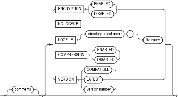

When you create the external table, you can specify certain parameters in an access_parameters clause. This clause is optional, as are its individual parameters. For example, you could specify LOGFILE, but not VERSION, or vice versa. The syntax for the access_parameters clause is as follows.
Comments are lines that begin with two hyphens followed by text. Comments must be placed before any access parameters, for example:
--This is a comment. --This is another comment. NOLOG
All text to the right of the double hyphen is ignored, until the end of the line.
Default: DISABLED
Specifies whether or not to compress data before it is written to the dump file set.
COMPRESSION=[ENABLED | DISABLED]
If ENABLED is specified, then all data is compressed for the entire upload operation.
If DISABLED is specified, then no data is compressed for the upload operation.
In the following example, the COMPRESSION parameter is set to ENABLED. Therefore, all data written to the dept.dmp dump file will be in compressed format.
CREATE TABLE table deptXTec3
 ORGANIZATION EXTERNAL (TYPE ORACLE_DATAPUMP DEFAULT DIRECTORY def_dir1
 ACCESS PARAMETERS (COMPRESSION ENABLED) LOCATION ('dept.dmp'));
Default: DISABLED
Specifies whether or not to encrypt data before it is written to the dump file set.
ENCRYPTION=[ENABLED | DISABLED]
If ENABLED is specified, then all data is written to the dump file set in encrypted format.
If DISABLED is specified, then no data is written to the dump file set in encrypted format.
This parameter is used only for export operations.
In the following example, the ENCRYPTION parameter is set to ENABLED. Therefore, all data written to the dept.dmp file will be in encrypted format.
CREATE TABLE deptXTec3
 ACCESS PARAMETERS (ENCRYPTION ENABLED) LOCATION ('dept.dmp'));
Default: If LOGFILE is not specified, a log file is created in the default directory and the name of the log file is generated from the table name and the process ID with an extension of .log. If a log file already exists by the same name, the access driver reopens that log file and appends the new log information to the end.
LOGFILE specifies the name of the log file that contains any messages generated while the dump file was being accessed. NOLOGFILE prevents the creation of a log file.
NOLOGFILE
or
LOGFILE=[directory_object:]logfile_name
If a directory object is not specified as part of the log file name, then the directory object specified by the DEFAULT DIRECTORY attribute is used. If a directory object is not specified and no default directory was specified, an error is returned. See Filenames for LOGFILE for information about using wildcards to create unique filenames during parallel loads or unloads
In the following example, the dump file, dept_dmp, is in the directory identified by the directory object, load_dir, but the log file, deptxt.log, is in the directory identified by the directory object, log_dir.
CREATE TABLE dept_xt (dept_no INT, dept_name CHAR(20), location CHAR(20))
ORGANIZATION EXTERNAL (TYPE ORACLE_DATAPUMP DEFAULT DIRECTORY load_dir
ACCESS PARAMETERS (LOGFILE log_dir:deptxt) LOCATION ('dept_dmp'));

The VERSION clause is used to specify the minimum version of Oracle Database that will be reading the dump file. If you specify a version of 10.2, then both 10.2 and 11.1 databases can read the dump file. If you specify a version of 11.1, then only 11.1 databases can read the dump file.
The default value is COMPATIBLE.
