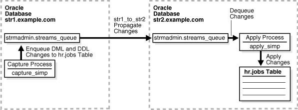

The example in this chapter illustrates using Oracle Streams to replicate data in one table between two databases. A capture process captures data manipulation language (DML) and data definition language (DDL) changes made to the jobs
table in the hr
schema at the str1.example.com
Oracle database, and a propagation propagates these changes to the str2.example.com
Oracle database. Next, an apply process applies these changes at the str2.example.com
database. This example assumes that the hr.jobs
table is read-only at the str2.example.com
database.
Figure 19-1 provides an overview of the environment.
