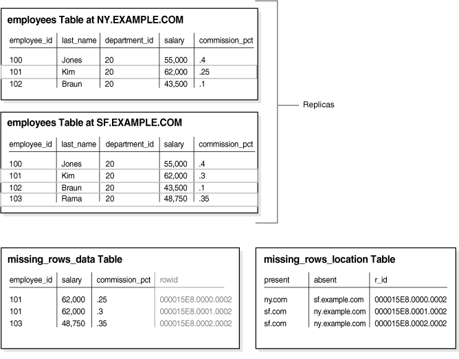

Step 5 At the site containing the "reference" table, call the DIFFERENCES procedure.
For example, if you wanted to compare the employees tables at the New York and San Francisco sites, then your procedure call would look similar to the following:
BEGIN DBMS_RECTIFIER_DIFF.DIFFERENCES ( sname1 => 'hr', oname1 => 'employees', reference_site => 'ny.example.com', sname2 => 'hr', oname2 => 'employees', comparison_site => 'mv4.example.com', where_clause => '', column_list => 'employee_id,salary,department_id', missing_rows_sname => 'hr', missing_rows_oname1 => 'missing_rows_data', missing_rows_oname2 => 'missing_rows_location', missing_rows_site => 'ny.example.com', max_missing => 500, commit_rows => 50); END; /
Figure 9-1 shows an example of two replicas of the employees table and what the resulting missing rows tables would look like if you executed the DIFFERENCES procedure on these replicas.
Figure 9-1 Determining Differences Between Replicas
Notice that the two missing rows tables are related by the ROWID and r_id columns.
