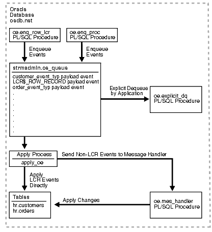

Figure 23-1 provides an overview of this environment.
Figure 23-1 Example Oracle Streams Messaging Environment

In Example 23-15, you connect to database db01 as administrator user strmadmin to create an apply process that is associated with queue oe_queue, that uses the apply_oe_rs rule set, and that uses the mes_handler procedure as a message handler.
Example 23-15 Creating an Apply Process
set echo offset verify offACCEPT password CHAR PROMPT 'Enter the password for STRMADMIN: ' HIDECONNECT strmadmin/&password@db01;set echo on
BEGIN
  DBMS_APPLY_ADM.CREATE_APPLY(
    queue_name       =>  'strmadmin.oe_queue',
    apply_name       =>  'apply_oe',
    rule_set_name    =>  'strmadmin.apply_oe_rs',
    message_handler  =>  'oe.mes_handler',
    apply_user       =>  'oe',
    apply_captured   =>  false);
END;

The examples in this section illustrate how to configure explicit dequeue of messages based on message contents.
In Example 23-18, you connect to database db01 as administrator user strmadmin to create agent explicit_dq. This agent is used to perform explicit dequeue operations on the oe_queue queue.
Example 23-18 Creating an Agent for Explicit Dequeue
BEGIN
  SYS.DBMS_AQADM.CREATE_AQ_AGENT(
    agent_name      => 'explicit_dq');
END;
The oe_queue queue is a secure queue because it was created using SET_UP_QUEUE in Example 23-2. For a user to perform enqueue and dequeue operations on a secure queue, the user must be configured as a secure queue user of the queue.
In Example 23-19, you connect to database db01 as administrator user strmadmin to associate the oe user with agent explicit_dq. The oe user is able to perform dequeue operations on the oe_queue queue when the agent is used to create a subscriber to the queue in Example 23-20.
Example 23-19 Associating User oe with Agent explicit_dq
BEGIN
  DBMS_AQADM.ENABLE_DB_ACCESS(
    agent_name  => 'explicit_dq',
    db_username => 'oe');
END;
