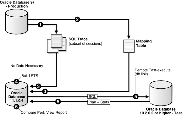

Figure 1-1 SQL Performance Analyzer Workflow for Database Upgrade from Oracle Database 9i to Oracle Database 10g Release 2
The production system which you are upgrading from should be running Oracle Database 9i. The test system which you are upgrading to should be running Oracle Database 10g Release 2. The database version can be release 10.2.0.2 or later. If you are upgrading to Oracle Database 10g release 10.2.0.2 or 10.2.0.3, you will also need to install a one-off patch before proceeding. To ensure that the analysis made by SQL Performance Analyzer is accurate, this system should contain an exact copy of the production data found on the production system. Furthermore, the hardware configuration should also be as similar to the production system as possible.
Next, you will need to set up a separate system running Oracle Database 11g Release 1. The database version should be release 11.1.0.6. You will also need to install a one-off patch for this release. You will be using this system to build a SQL tuning set and to run SQL Performance Analyzer. Neither your production data or schema need to be available on this system, since the SQL tuning set will be built using statistics stored in the SQL trace files from the production system, and SQL Performance Analyzer tasks will be executed remotely on the test system over a database link.
Once the upgrade environment is configured as described, you can use SQL Performance Analyzer in a database upgrade from Oracle Database 9i to Oracle Database 10g by completing the following steps, as illustrated in Figure 1-1:
Enable the SQL Trace facility on the production system running Oracle Database 9i.
To minimize the performance impact on the production system and still be able to fully capture a representative set of SQL statements, consider enabling SQL Trace for only a subset of the sessions, for as long as required, to capture all important SQL statements at least once.
Create a mapping table on the production system running Oracle Database 9i.
This mapping table will be used to convert the user and object identifier numbers in the SQL trace files to their string equivalents.
Move the SQL trace files and the mapping table from the production system running Oracle Database 9i to the system running Oracle Database 11g.
On the system running Oracle Database 11g, construct a SQL tuning set using the SQL trace files.
The SQL tuning set will contain the SQL statements captured in the SQL trace files, along with their relevant execution context and statistics.
On the system running Oracle Database 11g, use SQL Performance Analyzer to build a pre-upgrade SQL trial and a post-upgrade SQL trial:
Compare SQL performance and fix regressed SQL:
SQL Performance Analyzer compares the performance of SQL statements read from the SQL tuning set during the pre-upgrade SQL trial to those captured from the remote test execution during the post-upgrade SQL trial. A report is produced to identify any changes in execution plans or performance of the SQL statements.
If the report reveals any regressed SQL statements, you can make further changes to fix the regressed SQL. You can then repeat the process of executing the SQL tuning set and comparing its performance to a previous execution to test any fixes or additional changes made. Repeat these steps until you are satisfied with the outcome of the analysis.
