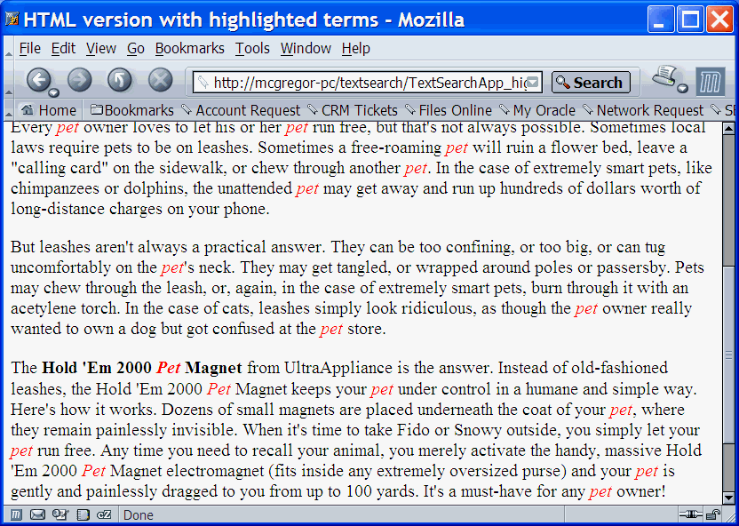

The CTX_DOC.MARKUP and CTX_DOC.POLICY_MARKUP procedures take a document reference and a query, and return a marked-up version of the document. The output can be either marked-up plaintext or marked-up HTML. For example, you might specify that a marked-up document be returned with the query term surrounded by angle brackets (<<<tansu>>>) or HTML (<b>tansu</b>).
CTX_DOC.MARKUP and CTX_DOC.POLICY_MARKUP are equivalent, except that CTX_DOC.POLICY_MARKUP does not require an index.
You can customize the markup sequence for HTML navigation.
The following example is taken from the Web application described in Appendix A, "CONTEXT Query Application". The procedure showDoc takes an HTML document and a query, creates the highlight markup—in this case, the query term will display in red—and outputs the result to an in-memory buffer. It then uses htp.print to display it in the browser.

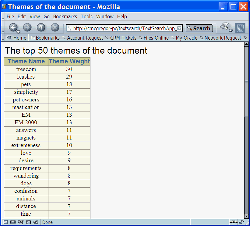

A list of themes is a list of the main concepts in a document. Use the CTX_DOC.THEMES procedure to generate lists of themes.
The following example generates the top 10 themes for document 1 and stores them in an in-memory table called the_themes. The example then loops through the table to display the document themes.
declare
 the_themes ctx_doc.theme_tab;
begin
 ctx_doc.themes('myindex','1',the_themes, numthemes=>10);
 for i in 1..the_themes.count loop
  dbms_output.put_line(the_themes(i).theme||':'||the_themes(i).weight);
  end loop;
end;

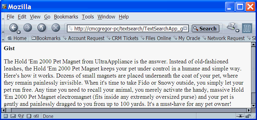

A gist is the text of a document that best represents what the document is about as a whole. A theme summary is the text of a document that best represents a single theme in the document.
Use the procedure CTX_DOC.GIST to generate gists and theme summaries. You can specify the size of the gist or theme summary when you call the procedure.
The following example generates a nondefault size generic gist of at most 10 paragraphs. The result is stored in memory in a CLOB locator. The code then de-allocates the returned CLOB locator after using it.
declare
  gklob clob;
  amt number := 40;
  line varchar2(80);
begin
 ctx_doc.gist('newsindex','34','gklob',1,glevel => 'P',pov => 'GENERIC',       numParagraphs => 10);
  -- gklob is NULL when passed-in, so ctx-doc.gist will allocate a temporary
  -- CLOB for us and place the results there.
  dbms_lob.read(gklob, amt, 1, line);
  dbms_output.put_line('FIRST 40 CHARS ARE:'||line);
  -- have to de-allocate the temp lob
  dbms_lob.freetemporary(gklob);
 end;
To create a gist table:
create table ctx_gist (query_id  number,
                       pov       varchar2(80),
                       gist      CLOB);
The following example returns a default sized paragraph level gist for document 34:
begin
ctx_doc.gist('newsindex','34','CTX_GIST',1,'PARAGRAPH', pov =>'GENERIC');
end;
The following example generates a nondefault size gist of ten paragraphs:
begin
ctx_doc.gist('newsindex','34','CTX_GIST',1,'PARAGRAPH', pov =>'GENERIC',        numParagraphs => 10);
end;
The following example generates a gist whose number of paragraphs is ten percent of the total paragraphs in document:
begin
ctx_doc.gist('newsindex','34','CTX_GIST',1, 'PARAGRAPH', pov =>'GENERIC', maxPercent => 10);
end;

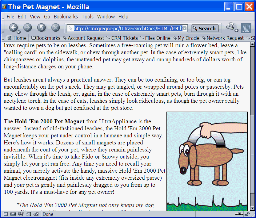

The Oracle Text ReferenceFigure 5-1 shows an original document to which we can apply highlighting, gisting, and theme extraction in the following sections.
Figure 5-1 Sample Document for Highlighting, Gisting, and Theme Extraction
Figure 5-2 is a screen shot of a query application presenting the document shown in Figure 5-1 with the query term pet highlighted. This output was created using the text query application produced by a wizard described in Appendix A, "CONTEXT Query Application".
Figure 5-2 Pet Highlighted in Pet Magnet Document
Figure 5-3 is a screen shot of a query application presenting a list of themes for the document shown in Figure 5-1. This output was created using the text query application produced by a wizard described in Appendix A, "CONTEXT Query Application".
Figure 5-3 Query Application Displaying Document Themes
Figure 5-4 is a screen shot of a query application presenting a gist of the document shown in Figure 5-1. This output was created using the text query application produced by a wizard described in Appendix A, "CONTEXT Query Application".
Figure 5-4 Query Application Presenting Document Gist
