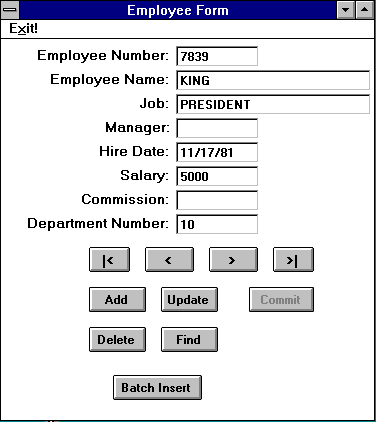

The Employee Form displays the fields of the database EMP table and has functional buttons that allow the user to browse, add, update, and query records.
Figure 6-1 shows the Employee Form.

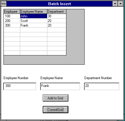

The Batch Insert Form allows users to enter records in a batch operation.
See Also:
"Programming a Batch Form" for a detailed description of the Batch Insert Form and code for its commandsFigure 6-2 shows the Batch Insert Form.

The Employee form displays the fields of the database EMP table and has functional buttons that allow the user to browse, add, update, and query records.
Each field corresponds to a column in the database EMP table. The Employee field (ENAME) is the indexed column and is mandatory for each record. The field data types and sizes are defined as follows in the EMP table:
Name Null? Type ----------------------- ---------- -------------------------- EMPNO NOT NULL NUMBER(4) ENAME VARCHAR2(10) JOB VARCHAR2(9) MGR NUMBER(4) HIREDATE DATE SAL NUMBER(7,2) COMM NUMBER(7,2) DEPTNO NOT NULL NUMBER(2)
The Employee Number (EMPNO) and Department (DEPTNO) columns are NOT NULL, and, therefore, always require a value when a record is added. The length of each field is enforced by setting the MaxLength property of each TextBox to the appropriate number.
Figure 6-3 shows the Employee Form.

To allow users to update existing records in the database, you need to include an Update button in the Employee Form. Users navigate to a particular record, click the Update button, make changes, and then click the Commit button.
While in update mode, the application makes the following restrictions:
Users cannot navigate to another record or perform another function.
Users cannot change the employee number because this is the primary key.
To program the Update function, write an event procedure for the Update button and modify the Commit procedure so that it handles both updating and adding records.
To code the Update button, disable the Employee Number text box to prevent changes to this field while updating records, because this is a primary key. You must also disable the other buttons to disable other functions, such as navigation, while updating records.
Set the DoUpdate Boolean expression to TRUE, so the commit procedure recognizes the current process as an update operation, not an addition.
The update event procedure must do the following:
Disable the Update button.
Enable the Commit button.
Disable other buttons to disable functions, such as navigation, during the update operation.
Disable the Employee Number text box.
Set the DoUpdate flag to True.
Let the user enter changes.
The following example code shows the update event procedure:
Private Sub cmdUpdate_Click() 'Disable the Update button and enable the commit button cmdUpdate.Enabled = False Commit.Enabled = True 'Disable all other buttons DisableNavButtons txtEmpno.Enabled = False DoUpdate = True End Sub
The update and add event procedures call the DisableNavButtons() subroutine to disable navigation and other functions during an add or update operation.
Private Sub DisableNavButtons() 'disable all buttons while adding and updating cmdFirst.Enabled = False cmdPrevious.Enabled = False cmdNext.Enabled = False cmdLast.Enabled = False cmdFind.Enabled = False cmdUpdate.Enabled = False AddNew.Enabled = False End Sub
The procedure for committing an update operation is similar to committing an add, except that the dynaset is set in edit mode using the Edit method and then the new dynaset values are assigned.
Because the same commit button and the same commit event procedure are used to add and update, two global flags DoAdd and DoUpdate are added to distinguish between adding and updating. The Add and Update click event procedures set these flags.
The Commit event procedure for adding and updating must do the following:
Validate entered data using the DoValidationChecks() function as before.
Use AddNew to add records or else use Edit for updates.
Assign entered data to dynaset fields, using the Fields().Value property using UpdateDynasetFields() as before.
Update database with new records, using Update.
Disable the Commit button.
Reenable all other functional buttons including the Add and Update buttons.
Set the DoUpdate and DoAdd flags to False.
The code that changes button and flag states in Steps 5 through 7 is provided in a new subroutine called SetAfterCommitFlags(). This replaces the lines of code that originally enabled Commit and AddNew.

Users can delete records by navigating to a particular record and clicking the Delete button. The application prompts the user to verify the deletion, then the application deletes the record using the Delete method. The program then refreshes the screen with the next record or with the previous record if the user deleted the last record in the dynaset.
The following example shows the delete-click event procedure:
Private Sub cmdDelete_Click()
'prompt user
Response = MsgBox("Do you really want to Delete?", vbYesNo + vbExclamation)
If Response = vbYes Then
    EmpDynaset.Delete
    'attempt to move to next record
    EmpDynaset.MoveNext
    If EmpDynaset.EOF Then 'If deleted last record
        EmpDynaset.MovePrevious
    End If
    Call EmpRefresh
End If
End Sub
The employee application can be configured to allow users to search for particular records in the database. For demonstration purposes, a Find button is included to allow users to query only employee names. At any time, the user can enter the query in the Employee Name field, and click the Find button. The application then displays the result or displays a message if the name cannot be found.
To search for records, the FindFirst method is used. When the find operation succeeds, the record is displayed. If the find fails, a message is displayed. The current row is reset to the first row, because failures cause the dynaset to be BOF (beginning-of-file), effectively making the current row invalid.
The Find_Click() event procedure must do the following:
Build a find clause to find the record where the ENAME column matches the entered string.
Execute the find using the FindFirst method.
Display the record if it is found; if the record was not found, display a message and reset the current row to the first row.
The following example shows a typical find click event procedure:

The Batch Insert Form allows users to insert rows in a batch operation, that is, to insert more than one record into the database by using only one command. This feature is implemented using parameter arrays and SQL statements.
Table 6-1 shows a typical Batch Insert Form:
Users navigate to the Batch Insert Form by clicking the Batch Insert button on the Employee Form. The Batch Insert Form has a grid that displays the entered data and a row of fields where the user enters each record. To keep the example simple, users are only allowed to enter information into the Employee Number, Employee Name, and Department Number fields.
Users enter records in the fields and click the Add to Grid button. The program displays the entered records in the grid. To insert the entire batch to the database, users click the CommitGrid button.
The Batch Insert Form uses three procedures. The Form_Load() procedure initializes the grid with the column headers. The CmdAddtoGrid_click() procedure copies the entered data from the fields to the grid. The CommitGrid_Click() procedure contains the parameter array and SQL statements used to make the batch insert.
These procedures are described as follows:

The CmdAddtoGrid_Click() procedure copies the data entered in the fields to the next empty grid row. The global variable CurrRow always points to the first empty row in the grid.
The following example shows the CmdAddtoGrid_Click():
Private Sub CmdAddtoGrid_Click() 'Update the grid 'Update Empno column Grid1.Row = CurrRow Grid1.Col = 0 Grid1.Text = txtEmpno 'Update Ename column Grid1.Row = CurrRow Grid1.Col = 1 Grid1.Text = txtEname 'Update Deptno column Grid1.Row = CurrRow Grid1.Col = 2 Grid1.Text = txtDeptno 'Increment CurrCol CurrRow = CurrRow + 1 NoOfRows = CurrRow - 1 End Sub
The CommitGrid_Click() procedure inserts the grid data into the database. To do so, this procedure creates a parameter array object for each column in the EMP table that corresponds to a column in the grid. The OraParameters.AddTable() method defines each parameter array. For example, a parameter array called EMPNO_ARR holds all Employee Number column elements.
After the parameter arrays are defined, the Put_Value method populates them with grid column elements.
To commit the parameter array elements to the database, this procedure uses the CreateSQL() method with a SQL INSERT statement containing the parameter arrays. Because the CreateSQL() method executes the SQL INSERT statement in addition to creating a SQL statement object, all column elements (parameter array elements) are inserted into the EMP table with this one statement.
If an error occurs during a SQL INSERT statement that contains parameter arrays, the SQL statement object is still created with no explicitly raised error. To identify such errors, always check the OraDatabase.LastServerErr and OraDatabase.LastServerErrText properties immediately after executing the CreateSQL method.
The CreateSQL method updates the database directly and has no effect on the dynaset. The EmpDynaset. Refresh method must used to refresh this dynaset so that it reflects the newly inserted records.
The CommitGrid_Click() event procedure must do the following:
Define a parameter array for each grid (database) column, using the AddTable method.
Copy grid column elements into parameter arrays, using the Put_Value method within a nested loop.
Create a SQL statement object using the CreateSQL method to insert parameter array elements into the EMP table.
Check the LastServerErrText and LastServerErr properties to catch SQL statement execution errors.
Refresh the global dyanset to reflect newly inserted records, using the Refresh method.
The following example shows a typical cmdCommitGrid_Click() procedure:
