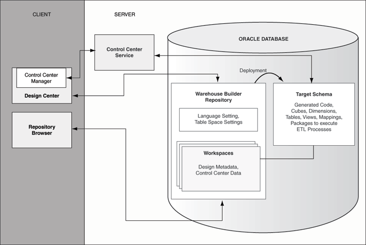

Figure 2-1 illustrates the Warehouse Builder components.
As previously noted, the Design Center is the primary user interface. It is also a centralized interface in that you can start from it all the client based tools, including the Control Center Manager. A secondary user interface is the web-based Repository Browser. In addition to browsing design metadata and auditing execution data, you can view and create reports.
For the purposes of this illustration, the target schema and the repository exist on the same Oracle Database; however, in practice, target schemas often exist on separate databases. To deploy design objects and subsequently execute the generated code, use the Control Center Manager, which is the client interface that interacts with the target schema through the control center service.

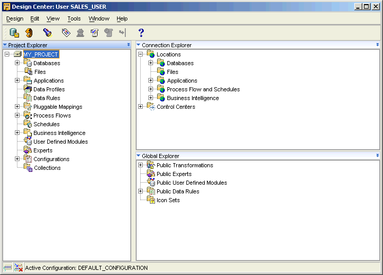

Start the Design Center.
On a Windows platform, from the Start menu, select Programs. Select the Oracle home in which Warehouse Builder is installed, then Warehouse Builder, and then Design Center.
On a Linux platform, run owbclient.sh located in the owb/bin/unix directory in the Oracle home for Warehouse Builder.
Figure 2-2 shows the Design Center with the top level folders in each of its three explorers expanded.
Use the Project Explorer to manage design objects for a given workspace. The design objects are organized into projects which provide a means for structuring the objects for security and reusability. Each project contains nodes for each type of design object that you can create or import.
Use the Connection Explorer to establish connections between the Warehouse Builder workspace and databases, data files, and applications.
Use the Global Explorer to manage objects that are common to all projects in a workspace and to administer security. Note that the Security node is visible to users who have an administrator role as discussed in the Oracle Warehouse Builder Installation and Administration Guide.
