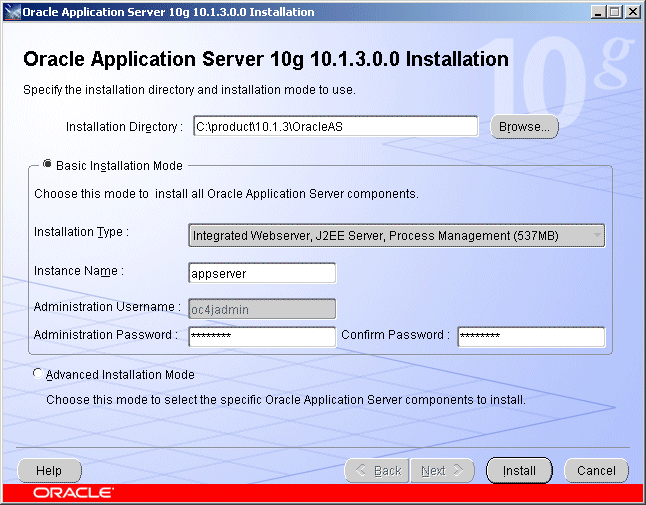

Oracle Application Server 10g 10.1.3.0.0 Installation Screen
Installation Directory: Enter the directory where you want install Oracle Application Server.
Select Basic Installation Mode.
Installation Type: You cannot change the installation type in a basic installation.
Instance Name: The instance name identifies this Oracle Application Server instance. If you have more than one Oracle Application Server instance on the same host, the instances must have unique names.
Administration Username: The administration username for Oracle Application Server instances is set to oc4jadmin and cannot be changed. To manage Oracle Application Server instances using Oracle Enterprise Manager 10g, log in as the oc4jadmin user.
Administration Password and Confirm Password: Enter the password for the oc4jadmin user.
Click Install.
Figure 4-1 Oracle Application Server 10g 10.1.3.0.0 Installation Screen

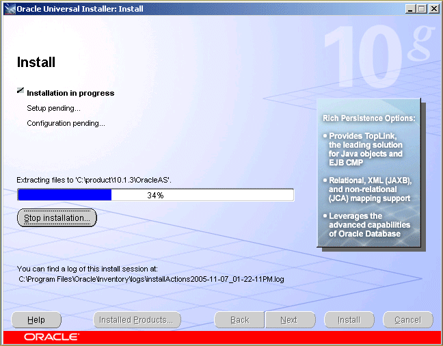

Oracle Universal Installer: Install Screen
This screen shows the progress of installation.
Figure 4-2 Oracle Universal Installer: Install Screen

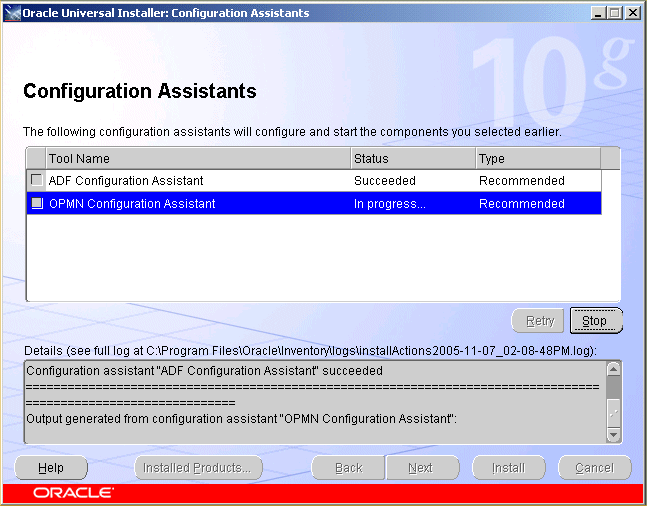

Oracle Universal Installer: Configuration Assistants Screen
This screen shows the progress of the configuration assistants.
Figure 4-3 Oracle Universal Installer: Configuration Assistants Screen

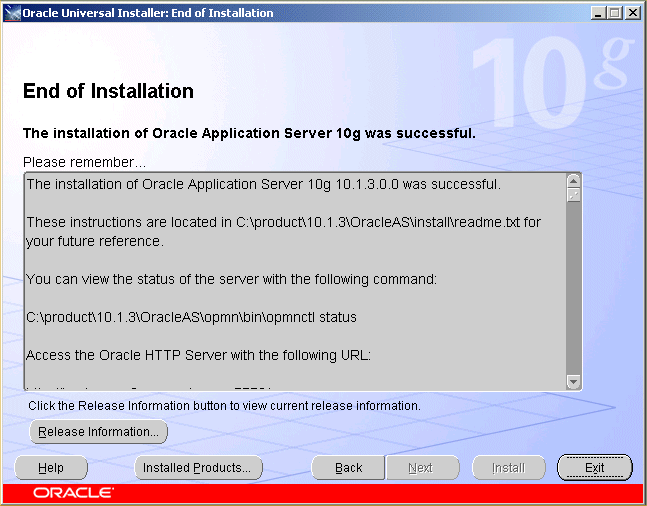

Oracle Universal Installer: End of Installation Screen
This screen tells you whether or not your installation was successful, and provides a link to the product release notes.
Figure 4-4 Oracle Universal Installer: End of Installation Screen
