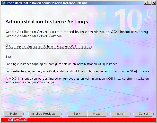

5.
Administration Instance Settings
Select Configure this as an Administration OC4J instance if you would like to run Application Server Control on this instance.
Click Next.
For more information, refer to Section 5.3.4, "Administration Instance Settings".

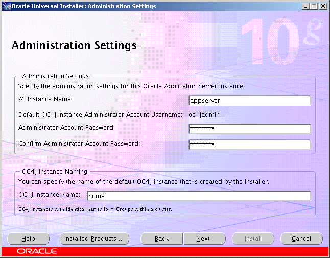

6.
Administration Settings
Specify the Oracle Application Server instance name and oc4jadmin password.
Specify the default Oracle Containers for J2EE instance name.
Click Next.
For more information, refer to Section 5.3.5, "Administration Settings Screen".

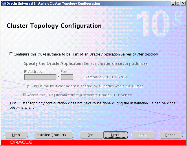

7.
Cluster Topology Configuration
Select if you would like to configure this instance to be part of an Oracle Application Server cluster topology.
If you select Configure this OC4J instance to be part of an Oracle Application Server cluster topology, specify the IP Address and Port, and select Access this OC4J Instance from a separate Oracle HTTP Server if you want the default web site to run in AJP protocol mode.
Click Next.
For more information, refer to Section 5.3.7, "Cluster Topology Configuration Screen - J2EE Server and Process Management Install Type".

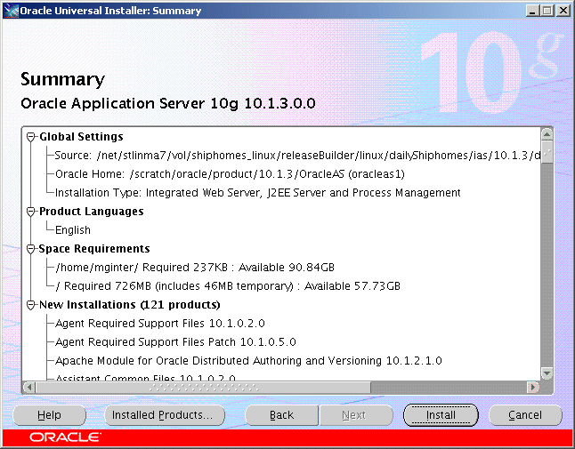

8.
Summary
Verify that the installation parameters shown on the screen are correct.
Click Install.
For more information, refer to Section 5.3.10, "Summary Screen".

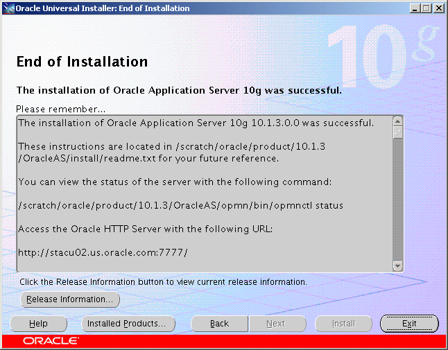

11.
End of Installation
None. This screen tells you whether or not your installation was successful, and provides a link to the product release notes.
For more information, refer to Section 5.3.13, "End of Installation Screen".

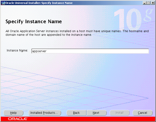

5.
Specify Instance Name
Specify the Oracle Application Server instance name.
Click Next.
For more information, refer to Section 5.3.6, "Specify Instance Name Screen".

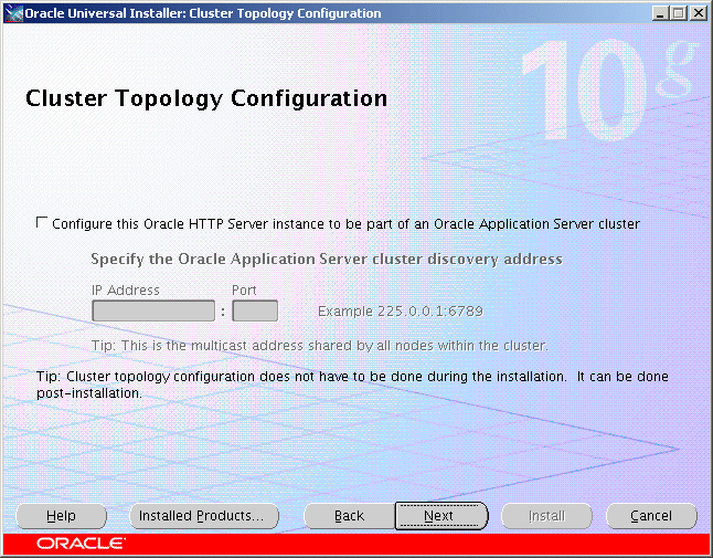

6.
If you select Configure this HTTP Server instance to be part of an Oracle Application Server cluster, specify the IP Address and Port.
Click Next.
For more information, refer to Section 5.3.8, "Cluster Topology Configuration Screen: Web Server and Process Management Install Type".

End of Installation

5.
Click Next.
6.
Click Next.

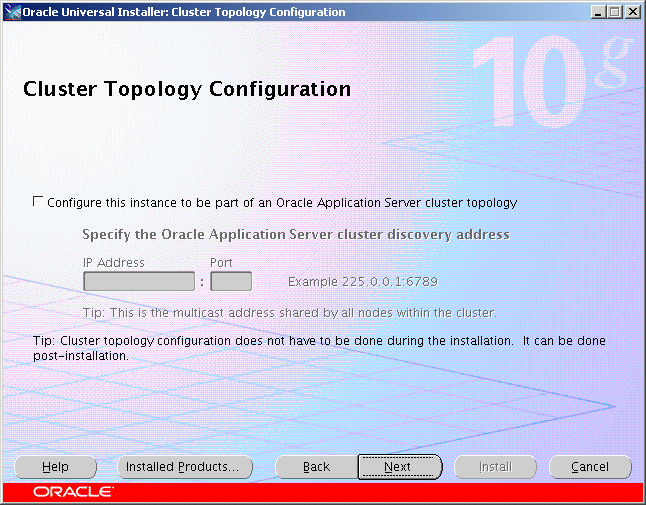

7.
If you select Configure this instance to be part of an Oracle Application Server cluster topology, specify the IP Address and Port.
Click Next.
For more information, refer to Section 5.3.9, "Cluster Topology Configuration Screen: Integrated Web Server, J2EE Server and Process Management Install Type".
8.
Summary
Click Install.

11.
End of Installation

End of Installation

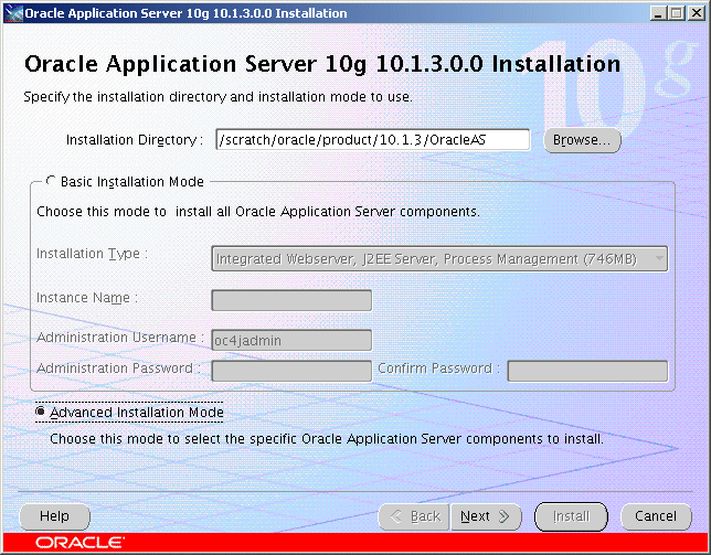

5.3.1 Oracle Application Server 10g 10.1.3.0.0 Installation Screen
This is the first screen in the installation process. You need to specify the installation directory (or Oracle home) and whether you want to perform a basic or advanced installation.
Figure 5-1 Oracle Application Server 10g 10.1.3.0.0 Installation Screen
Description of Figure 5-1 follows
Description of "Figure 5-1 Oracle Application Server 10g 10.1.3.0.0 Installation Screen"
Installation Directory
Specify the full path of the installation directory or Oracle home. This is the directory where you want to install the software. For more information about the Oracle home, refer to Section 3.1, "Oracle Home Directory".
Select Basic or Advanced Installation Mode
In this chapter you are performing an advanced installation of Oracle Application Server, so select Advanced Installation Mode and click Next.
If you want to perform a basic installation, see Chapter 4, "Basic Installation".
After you click the Next button, the following warning appears:
Figure 5-2 Warning Screen
Description of Figure 5-2 follows
Description of "Figure 5-2 Warning Screen"
Click Yes to continue with the advanced installation.

5.3.4 Administration Instance Settings
Select whether you would like to run Application Server Control on this instance.
Figure 5-5 Oracle Universal Installer: Administration Instance Settings Screen
Description of Figure 5-5 follows
Description of "Figure 5-5 Oracle Universal Installer: Administration Instance Settings Screen"
Select this option if you want to run Application Server Control on this system to provide management capabilities.
If you are using a single instance topology, you should select this option to be able to manage the instance.
If you are using a cluster topology, you should select this option if you want this instance to administer the cluster using Application Server Control. In a cluster topology, only one instance should be configured as an Administration OC4J instance. Note that the Administration OC4J instance for the cluster does not have to be the first installed node.
If you do not select Configure this as an Administration OC4J instance, then Application Server Control will be configured to not run on this system. This Application Server instance will need to be managed by Application Server Control running on another OC4J instance within the cluster topology. You can configure the Application Server Control to run on this instance following installation if required. See "Enabling Remote Management by Setting Administrator Credentials" in the Oracle Application Server Administrator's Guide for details.
5.3.5 Administration Settings Screen
Specify the Oracle Application Server instance name, oc4jadmin password, and the OC4J instance name.
Figure 5-6 Oracle Universal Installer: Administration Settings Screen
Description of Figure 5-6 follows
Description of "Figure 5-6 Oracle Universal Installer: Administration Settings Screen"
AS Instance Name
The AS Instance Name uniquely identifies this Oracle Application Server instance.
For more information about instance names, see Section 3.4, "Oracle Application Server Instances and Instance Names".
Default OC4J Instance Administrator Account Username
The administrative username for Oracle Application Server instances is set to oc4jadmin and cannot be changed. To manage Oracle Application Server instances using Enterprise Manager, log in as the oc4jadmin user.
For more information about the oc4jadmin user, see Section 3.5, "The oc4jadmin User and Restrictions on its Password".
Administrator Account Password and Confirm Administrator Account Password
On a host, you can install multiple Oracle Application Server instances, each with its own unique instance name, but the name of the administrative user is oc4jadmin for all instances. You can specify a different password for the oc4jadmin user for each instance.
For more information about the oc4jadmin password, see Section 3.5, "The oc4jadmin User and Restrictions on its Password".
OC4J Instance Name
The OC4J instance name identifies the default OC4J instance created by the installer.
OC4J instance names can consist only of the alphanumeric characters (A-Z, a-z, 0-9) and the underscore character (_).
There is no maximum length for an OC4J instance name.
5.3.6 Specify Instance Name Screen
This screen only appears if you select the Web Server and Process Management option on the Select Installation Type screen shown in Figure 5-3.
Figure 5-7 Oracle Universal Installer: Specify Instance Name Screen
Description of Figure 5-7 follows
Description of "Figure 5-7 Oracle Universal Installer: Specify Instance Name Screen"
Instance Name
Specify the Oracle Application Server instance name. The instance name uniquely identifies this Oracle Application Server instance.
5.3.7 Cluster Topology Configuration Screen - J2EE Server and Process Management Install Type
Select whether you would like to configure this instance to be part of an Oracle Application Server cluster topology.
Figure 5-8 Oracle Universal Installer: Cluster Topology Configuration (J2EE)
Description of Figure 5-8 follows
Description of "Figure 5-8 Oracle Universal Installer: Cluster Topology Configuration (J2EE)"
Select this option if you would like to configure this instance to be part of an Oracle Application Server cluster topology. You may also configure the cluster topology following installation. See Section 7.5, "Configuring OracleAS Clusters" for details.
Specify the Oracle Application Server cluster discovery address
Specify the IP Address and the Port for the multicast address shared by all the nodes in the cluster.
  • When installing the first instance of the cluster, you only need to provide the discovery address. You do not need to perform any additional steps before installing the first instance of the cluster.
  • All nodes within the topology must be configured to use the same multicast address and port.
  • The multicast address must be within the valid address range, which is 224.0.0.1 to 239.255.255.255.
If you are adding an instance to an existing cluster and do not know the multicast address, find the <discover> element in the opmn.xml file on an Oracle Application Server instance in the topology. The <discover> element should appear like this:
<notification-server>
  <topology>
    <discover list="*225.0.0.20:8001"/>
  </topology>
</notification-server>
In this example, the IP address is 225.0.0.20 and the port is 8001.
Select this option if you want the OC4J instance to accept requests from an Oracle HTTP Server instance. If you select this option, then the OC4J instance will be configured so that its default web site is running in AJP protocol mode and accepts requests from mod_oc4j running in Oracle HTTP Server.
If you do not select this option, the OC4J instance will listen for requests from browser clients using its own HTTP listener. The OC4J instance will be configured so that its default web site is running in HTTP protocol mode and can be directly accessed from browser clients.
You can change how this OC4J instance is accessed following installation. See "Configuring Multicast Discovery with opmnctl" in the Oracle Containers for J2EE Configuration and Administration Guide.
5.3.8 Cluster Topology Configuration Screen: Web Server and Process Management Install Type
Figure 5-9 Oracle Universal Installer: Cluster Topology Configuration (Web Server)
Description of Figure 5-9 follows
Description of "Figure 5-9 Oracle Universal Installer: Cluster Topology Configuration (Web Server)"
Configure this Oracle HTTP Server instance to be part of an Oracle Application Server cluster
Select this option if you would like to configure this instance to be part of an Oracle Application Server cluster. You may also configure the cluster following installation. See Section 7.5, "Configuring OracleAS Clusters" for details.
  <topology>
  </topology>
5.3.9 Cluster Topology Configuration Screen: Integrated Web Server, J2EE Server and Process Management Install Type
Figure 5-10 Oracle Universal Installer: Cluster Topology Configuration (Integrated)
Description of Figure 5-10 follows
Description of "Figure 5-10 Oracle Universal Installer: Cluster Topology Configuration (Integrated)"
  <topology>
  </topology>
5.3.10 Summary Screen
Check and verify that the installation parameters shown in this window are correct.
Figure 5-11 Oracle Universal Installer: Summary Screen
Description of Figure 5-11 follows
Description of "Figure 5-11 Oracle Universal Installer: Summary Screen"
Click Install to begin the installation.

5.3.13 End of Installation Screen
This screen tells you whether or not your Oracle Application Server installation was successful and displays some important information that you must remember about the products you have installed. For example, it might contain information about the URLs for particular Web applications. Write down this information so that you can remember it.
This information can also be found in the ORACLE_HOME/install/readme.txt file.
Figure 5-14 Oracle Universal Installer: End of Installation
Description of Figure 5-14 follows
Description of "Figure 5-14 Oracle Universal Installer: End of Installation"
To view release notes for the products you have installed, click Release Information or see the documentation page on OTN (http://www.oracle.com/technology/documentation).
Click Exit to exit the Oracle Universal Installer.
