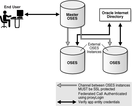

With federated search, the search is performed by a separate entity. That entity may be another Oracle SES application, or it may be a completely separate application. For example, a third-party content management system may contain its own text indexes. Instead of letting Oracle SES crawl the data in the third-party system, you can let it do the searching. The results are merged with any results from other sources that are searched at the same time and presented in the Oracle SES result list.
When using federated search on secure content, use special care to set up a secure federated search environment.

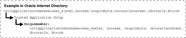

For the Oracle SES federated search environment to perform secure search, the federated master instance must be registered in Oracle Internet Directory as a trusted application to the slave instance.
To do this, use oidadmin to add the master instance's application entity (DN) to the trusted application's group under the slave instance's application entity entry. For example, add:
orclApplicationCommonName=oesEntity_<master_name>,cn=OES,cn=Products, cn=OracleContext,dc=us,dc=oracle,dc=com
to the uniqueMember attribute of
cn=TrustedApplications,orclApplicationCommonName=oesEntity_<slave_name>, cn=OES,cn=Products,cn=OracleContext,dc=us,dc=oracle,dc=com
where <master_name> is the search server name of the master Oracle SES instance, and <slave_name> is the name of the slave instance.
The federated slave instance cannot have single sign-on set up. However, the master instance can be protected by single sign-on.
The master and slave instances should be connected to the same Oracle Internet Directory server.If you disconnect and then reconnect the slave instance to Oracle Internet Directory, or if you switch Oracle Internet Directory server for both the master and slave instances, then you must add the master instance's DN to the trusted application's group under the slave instance's application entity entry again.
Secure federated search enables searching secure content across distributed Oracle SES instances. An end user is authenticated to the federated Oracle SES master instance and enters a query. Along with querying the secure content in its own index, the master instance federates the query to each of the slave Oracle SES instances, on behalf of the authenticated end user. To each federated slave instance, the master instance sends search queries using the Web Services API posing as a search user. This mechanism necessitates propagation of user identity between the Oracle SES instances.
In building a secure federated search environment, an important consideration is the secure propagation of user identities between the federated instances. This section explains how Oracle SES performs secure federation in a service-to-service manner without sending end user passwords across the network.
Secure Oracle HTTP Server-Oracle SES channel: Because any Oracle HTTP Server can potentially connect to the AJP13 port on the Oracle SES instances and masquerade as a specific person, the channel between the Oracle HTTP Server and the Oracle SES instance must be SSL-enabled, or the entire Oracle HTTP Server and Oracle SES instance machines must be protected by firewall.
See Also:
Chapter 4, "Security in Oracle Secure Enterprise Search" for more information about setting up single sign-onNotes:
In a secure federated search environment, the master instance may or may not be using SSO. However, the web service should not be behind SSO. The slave Oracle SES cannot use SSO to protect all content, but it can use SSO to protect private content.
Oracle strongly recommends that you SSL-protect the channel between Oracle HTTP Server and Oracle SES for secure content. The slave should be SSL-enabled, or you should be able to access the Web service using HTTPS.
On the slave instance, authenticating requests from the master instance are achieved by the Web Services API calls. The slave instance must trust the master instance, so that the master instance can impersonate (or proxy) as users when sending queries to the slave instance.
To establish the trust relationship between the master and slave instance, the master's application entity must be registered under the Trusted Applications Group of the slave's application entity in the Oracle Internet Directory.
The master instance invokes a Web service method, passing its application entity, password and the end user GUID to the slave. The slave then validates application entity credentials with the Oracle Internet Directory server and checks if this application entity is in its Trusted Group. If the Oracle Internet Directory checks are successful, then the slave switches the user of the current query session to the end user GUID passed in.
Because the application entity password is passed through the proxyLogin() method call across the network, the channel between the master and slaves must be SSL-enabled. The following graphic illustrates this.
