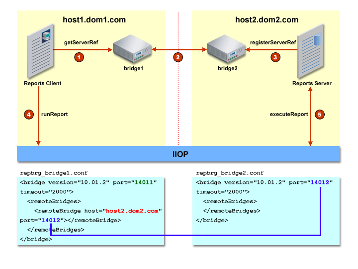

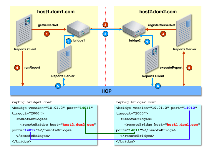

Figure 3-1 Oracle Reports Bridge Configuration (Two-Way)
If you specify the optional remoteBridge element(s) in the repbrg_bridgename.conf, then the bridge will act as a two-way bridge. That is, the bridge can get server references from remote bridges.
Figure 3-2 Oracle Reports Bridge Configuration (One-Way)
If you do not specify the optional remoteBridge element(s) in the repbrg_bridgename.conf, then the bridge will act as a one-way bridge. That is, the bridge can only serve remote bridges. It cannot connect to remote bridges to get the server reference.
The remoteBridge element attributes are described in Table 3-27.
