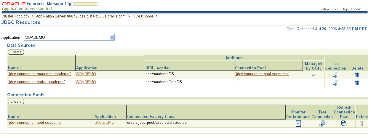

11.2.3 How to Create Data Sources
A data source is a vendor-independent encapsulation of database server connection. A data source instantiates an object that implements the javax.sql.DataSource interface.You can define any type of data source using Oracle Enterprise Manager Application Server Control Console. You can configure and use these data sources in your Oracle Application Server Containers for J2EE (OC4J) application.
You can create the data source after your application has been deployed.
To create data sources and connection pools for a selected OC4 J instance:
  1. Navigate to the OC4J Home page for the OC4J instance.
  2. Click Administration to display the OC4J Administration page, which contains a table listing the various administration tasks you can perform for this OC4J instance.
  3. If necessary, expand the Services section of the table.
  4. Click the task icon in the JDBC Resources row of the table to display the JDBC Resources as shown in Figure 11-1.
    Figure 11-1 JDC Resources
    Description of Figure 11-1 follows
    Description of "Figure 11-1 JDC Resources"
  5. Click Help for more information about viewing, creating, and deleting data sources and connection pools.

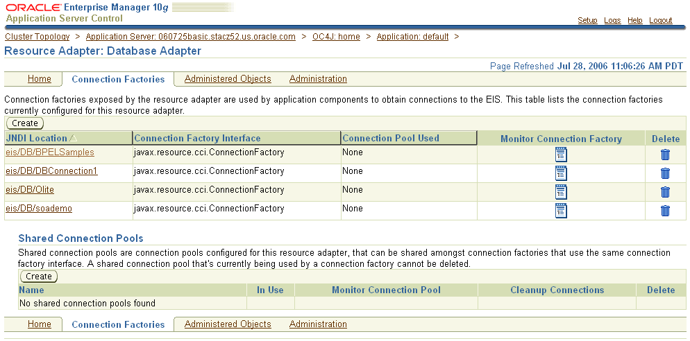

To use the Application Server Control Console to create a new connection factory:
  1. Navigate to the Resource Adapter Home page.
  2. Click Connection Factories to display the Connection Factories page as shown in Figure 11-2. This page lists the connection factories and shared connection pools defined for the selected resource adapter.
    Figure 11-2 Connection Factories
    Description of Figure 11-2 follows
    Description of "Figure 11-2 Connection Factories"
  3. Click Create at the top of the connection factory table and follow the instructions in the Create Connection Factory wizard.

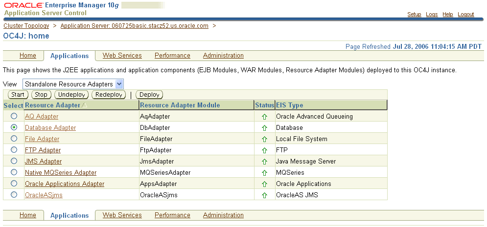

To deploy a standalone resource adapter:
  1. Navigate to the OC4J Home page for the instance.
  2. Click Applications to display the OC4J Applications page.
  3. Choose Standalone Resource Adapters from the View drop-down menu to display the Standalone Resource Adapters as shown in Figure 11-3. This page lists the standalone resource adapters that have been deployed to the OC4J instance.
    Figure 11-3 Standalone Resource Adapters
    Description of Figure 11-3 follows
    Description of "Figure 11-3 Standalone Resource Adapters"
  4. Click Deploy.
    Follow the instructions in the Deployment wizard. The wizard prompts you for the location of the resource adapter .rar file and prompts you deployment options.
