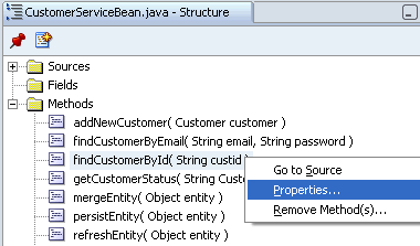

Changing the return type of a method is a two-step process: first change the return type in the Bean Method Details dialog, and then change the source code.
To open the Bean Method Details dialog, in the Structure pane, select the method you generated on the session facade, right-click it and choose Properties, as shown in Figure 4-7:
In the Bean Methods Details dialog, change the return type so that it returns the proper type of object. For example, in the SOA Order Booking application, the findCustomerById method returns an instance of a Customer, located in the org.soademo.customerservice.persistence package, as shown in Figure 4-8:
