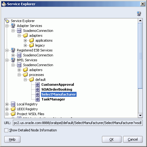

  4. To the right of the WSDL Location field, click the flashlight (torch) icon to open the Service Explorer dialog.
  5. Select a branch of the Service Explorer tree, such as BPEL Server Connection.
  6. Expand the server connection folder to view the existing projects.
    For example, expand the integration server connection that is set up.
  7. Expand the project to view the deployed services.
  8. Select a deployed service.
    Figure 6-3 is an example of a Service Explorer dialog with a service selected.
    Figure 6-3 Service Explorer Dialog
