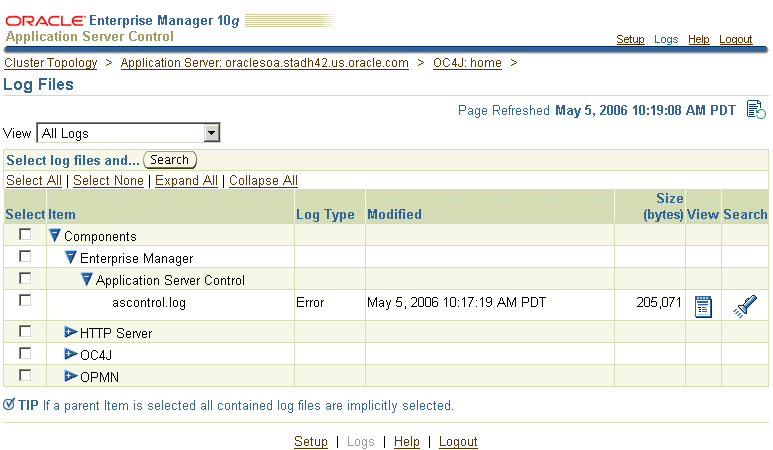

You can view the log files for a specific component with Application Server Control Console:
Select a system component link on the Application Server Control Console Home page, then select the Logs link. The Log Files page is displayed.
You can choose to view application logs, diagnostic logs, management system logs, or Web services log, or all types of logs by selecting a option from the View menu.
In the table, expand items until you see a list of log files for the component. For example, expand Components, expand Enterprise Manager, and Application Server Control. The log files are listed in the table, as shown in Figure 5-1.
Figure 5-1 Enterprise Manager Log Files Page
For any particular log file, click View. The log file text is displayed.

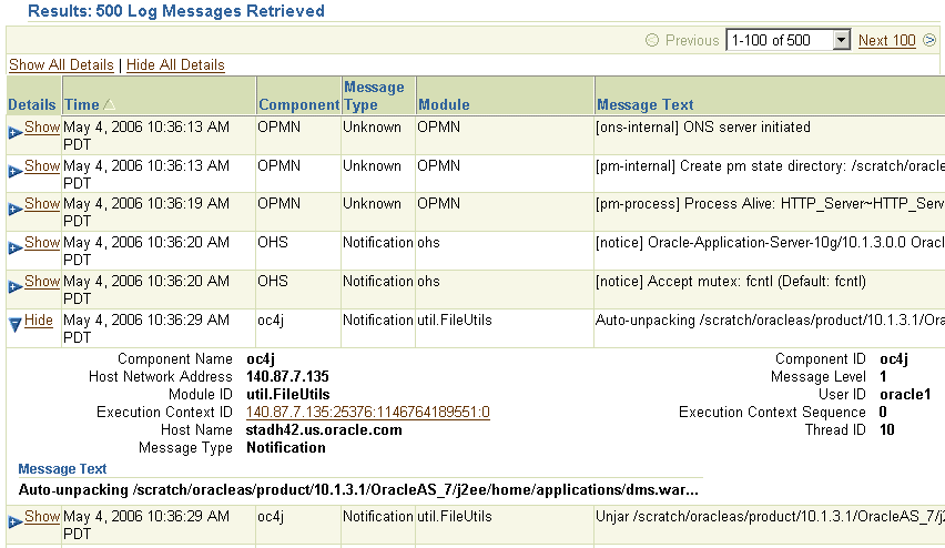

Click Search to perform the search. When the search returns, the Results section shows log files with matching fields, as shown in Figure 5-2.
To view a log entry, click Show in the Details column of the Results area on the Search Logs page.
The details of the error message are displayed. This information includes the Component Name and ID, Message Level, Module ID, Message Type, Message Text, and optionally the Execution Context ID (ECID).
