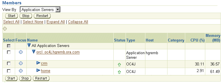

Figure 6-1 shows part of the Cluster Topology page, which displays the additional OC4J instance added to the cluster.
Figure 6-1 OC4J Instance Added to Cluster
You can also verify that the instance was added by using the opmnctl command:
ORACLE_HOME\opmn\bin\opmnctl status
Processes in Instance: orcl_oc4j.hgremb.ora.com
ias-component | process-type | pid | status
OC4J | crm | 1152 | Alive
OC4J | home | 2424 | Alive
ASG | ASG | N/A | Down

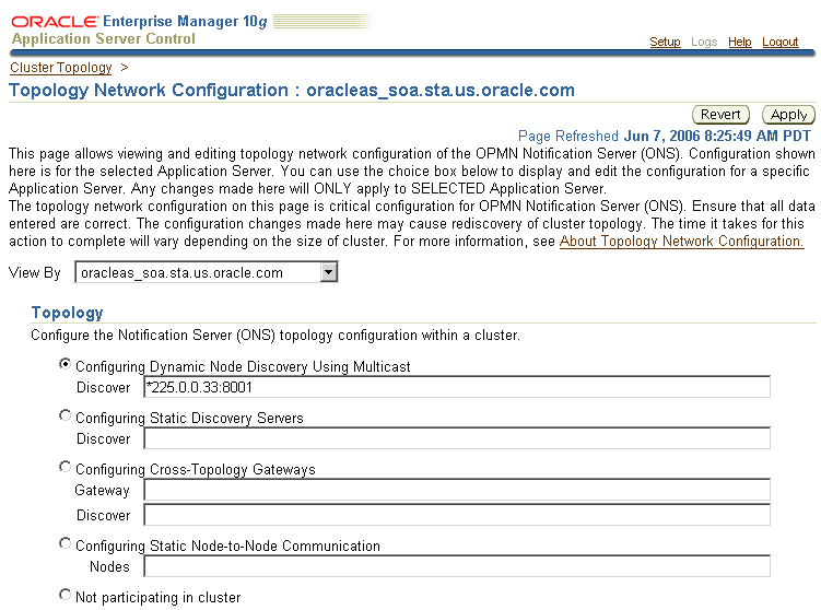

After installation, by using Application Server Control Console:
From the Cluster Topology page, click Topology Network Configuration.
In the Topology section, select one of the following configurations:
Configuring Dynamic Node Discovery Using Multicast: For dynamic node discovery, enter the multicast address and port. For example:
225.0.0.33:8001
The multicast address must be in the range 224.0.1.0 - 239.255.255.255.
Configuring Static Discovery Servers: For static discovery, enter the hostname or IP address and the OPMN remote port of the static discovery servers, separating the entries with commas.
Configuring Cross-Topology Gateways: For each source node and target node, specify the host name or IP address of the server and its OPMN remote port. Separate the data for each node with an ampersand (&).
In addition, specify the multicast address and port, which will be used for dynamic discovery within the node's own cluster.
Configuring Static Node-to-Node Communication: List the IP address and OPMN remote node of all the nodes you want to include in the cluster.
Figure 6-2 shows the Topology Network Configuration page:
Figure 6-2 Topology Network Configuration Page
Click Apply.

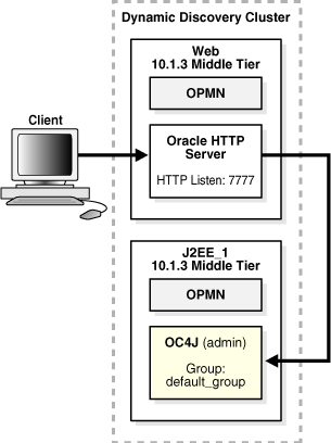

In this example, you install a Web server, Oracle HTTP Server, on one host, and install Oracle Containers for J2EE (OC4J) on another host. Then, you cluster the instances using dynamic node discovery. This enables Oracle HTTP Server to route requests to the OC4J, and OC4J to dynamically notify Oracle HTTP Server of new application bindings when an application is deployed.
Figure 6-4 shows this environment.
Figure 6-4 Web Server Middle Tier and OC4J Middle Tier on Separate Hosts in a Cluster
For this scenario, install the following Oracle Application Server middle-tier instances on separate hosts. (For this scenario, do not configure the cluster during installation.)
Web Server (referred to in this procedure as Web), which includes Oracle HTTP Server and OPMN
When you install the Web Server, accept the defaults on the Cluster Topology Configuration page.
J2EE Server (referred to in this procedure as J2EE_1), which includes OC4J and OPMN
When you install the J2EE Server, on the Administration Settings page, select Configure this as an Administration OC4J Instance. For OC4J Instance Name, enter admin.
On the Cluster Topology Configuration page, accept the defaults. You will add the instances to the cluster later.
Note the following points:
When you select an OC4J instance to be the Administration OC4J instance, the Application Server Control Console that is hosted within that instance administers the local OC4J instance and any other instances in the cluster that are not designated as Administration OC4J instances.
If you did not choose this option, you can configure it later, by starting the ascontrol application in the instance:
(UNIX) ORACLE_HOME/opmn/bin/opmnctl startproc application=ascontrol (Windows) ORACLE_HOME\opmn\bin\opmnctl startproc application=ascontrol
For those instances that are not specified as the Administration OC4J instance, Application Server Control Console is deployed in the instance, but not started.
Oracle recommends that only one OC4J instance in the cluster be configured as the Administration OC4J instance.

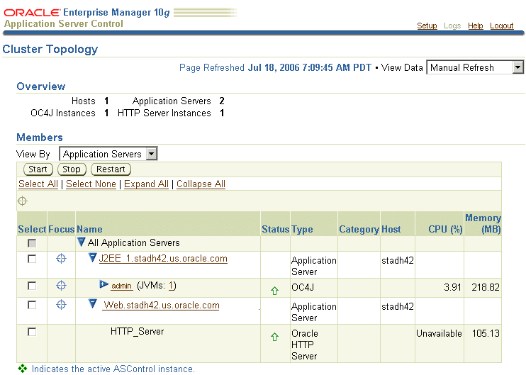

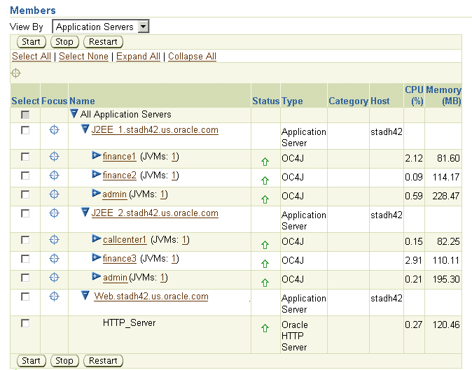

Verify the configuration in one of the following ways:
Using Application Server Control Console: Navigate to the Cluster Topology page. The page displays both instances, as shown in Figure 6-5:
Figure 6-5 Verifying the Cluster Topology
Using the opmnctl command with the @cluster option. The following example shows the output:
ORACLE_HOME/opmn/bin/opmnctl @cluster status
Processes in Instance: J2EE_1.stadh42.us.oracle.com
OC4JGroup:default_group | OC4J:admin | 21520 | Alive
Processes in Instance: Web.stadh42.us.oracle.com
HTTP_Server | HTTP_Server | 25118 | Alive

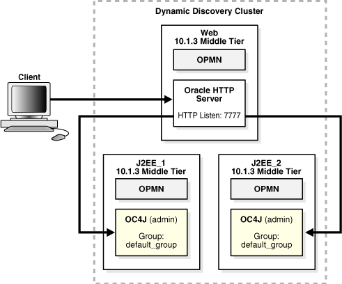

The example in this section builds upon the example in the previous section, Section 6.2.1. It adds an additional J2EE server middle tier to the cluster topology, to support a highly available environment for testing or production purposes.
Figure 6-6 shows this environment.
Figure 6-6 Multiple J2EE Server Middle Tiers and a Web Server Middle Tier in a Cluster
For this scenario:
Install and configure instances as described in Section 6.2.1.
Install an additional J2EE Server instance (referred to in this procedure as J2EE_2).
During installation, do not select Configure this as an Administration OC4J Instance in the Administration Instance Settings page. This instance will be managed by the Administration OC4J instance in J2EE_1 after you add it to the cluster. For OC4J Instance Name, enter admin.
Then, configure this J2EE Server instance for dynamic node discovery, adding it to the same cluster as the previous instances, using the opmnctl command.
For example, to associate the J2EE_2 instance on UNIX to the multicast address 225.0.0.33, use the following command:
ORACLE_HOME/opmn/bin/opmnctl config topology update discover=*225.0.0.33:8001 ORACLE_HOME/opmn/bin/opmnctl reload
Now, this instance is part of the cluster topology and is managed by the Administration OC4J instance in J2EE_1. This OC4J instance uses Apache JServ Protocol (AJP) to receive and respond to requests from Oracle HTTP Server.

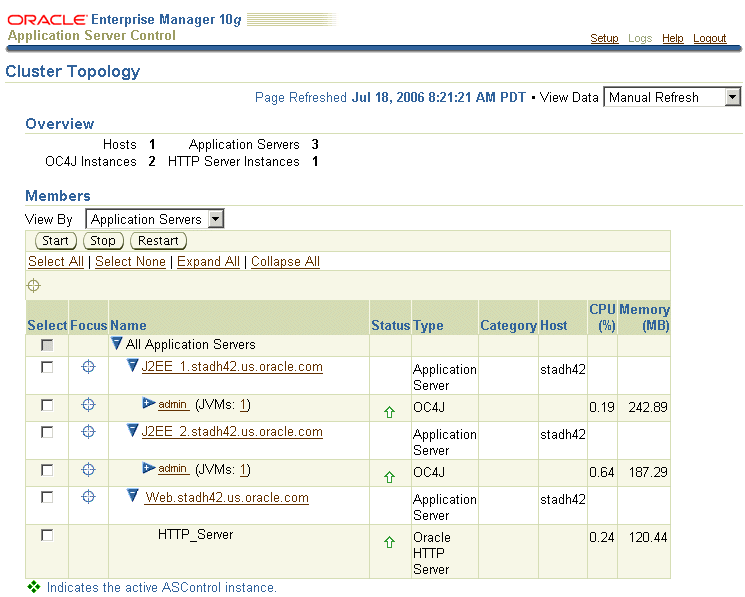

Verify the configuration using Application Server Control Console or the opmnctl @cluster status command. For example, to verify it using Application Server Control Console, navigate to the Cluster Topology page. The page displays all three instances in the Members section, as shown in Figure 6-7.
Figure 6-7 Verifying the Updated Cluster Topology

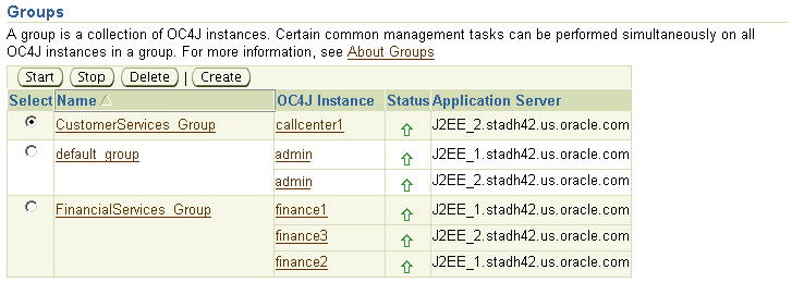

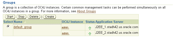

The default OC4J instance is part of the group default_group. In the scenario in the previous sections, both the J2EE Server instances, J2EE_1 and J2EE_2, contain the default OC4J instance, admin, and both OC4J instances are part of the group default_group. Figure 6-8 shows the Groups section of the Cluster Topology page.
A group is a collection of OC4J instances that belong to the same cluster topology. Configuration operations can be executed simultaneously on all running OC4J instances in the group.

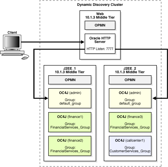

You can create additional groups. For this scenario, create two empty groups:
FinancialServices_Group
CustomerServices_Group
Take the following steps for each group:
From the Groups section of Cluster Topology page, click Create.
For Group Name, enter FinancialServices_Group.
Click Create.
Repeat steps 1 through 3, entering CustomerServices_Group as the Group Name.
In the next section, you will create new OC4J instances and add them to the groups.

Figure 6-9 shows the Members section of the Cluster Topology page, with the new OC4J instances displayed.
Figure 6-9 New OC4J Instances Displayed in Cluster Topology Page

Now, the cluster is configured as depicted in Figure 6-3 in Section 6.2.

Figure 6-11 depicts the scenario described in this section.

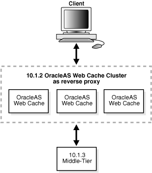

You can use a cluster of Release 2 (10.1.2) Oracle Web Cache instances as a reverse proxy for your 10g Release 3 (10.1.3.1.0) middle-tier instance.
The procedure in this section makes the following assumptions:
You have installed more than one instance of Release 2 (10.1.2) Oracle Web Cache standalone kit. The kit is part of the Oracle Application Server Companion CD, which is available on OTN.
You have configured Oracle Web Cache, as described in the Oracle Application Server Web Cache Administrator's Guide.
You have installed a 10g Release 3 (10.1.3.1.0) middle-tier instance.
Figure 6-12 depicts the scenario described in this section.
Figure 6-12 Oracle Web Cache Cluster as Reverse Proxy
To configure an Oracle Web Cache cluster as a reverse proxy, take the following steps:
Set up one Oracle Web Cache instance as a reverse proxy, as described in Section 6.3.1.
Log into Oracle Web Cache Manager for that instance, using the Oracle Web Cache username and password. By default, the username is ias_admin and the password is the one you specified during installation. Use the following URL, where port is the Oracle Web Cache administration port:
http://hostname:port/webcacheadmin
Configure the properties of the cache cluster, by taking the following steps:
In the Oracle Web Cache Manager navigator frame, select Properties > Clustering.
In the General Cluster Information section of the Clustering page, click Edit.
Follow the directions in the online Help or Chapter 10 of the Oracle Application Server Web Cache Administrator's Guide.
Add other caches to the cluster, by taking the following steps for each instance you want to place in the cluster:
In the Cluster Members section of the Clustering page, click Add.
After you have added all the caches to the cluster, propagate the cluster configuration to the cluster members by taking the following steps:
In the Oracle Web Cache Manager navigator frame, select Operations > Cache Operations.
Select All Caches, and click Propagate.
Restart all caches by selecting All Caches and clicking Restart.

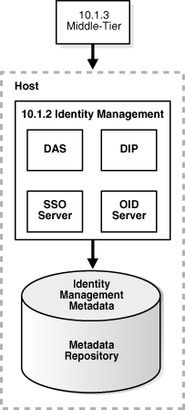

This section describes how to configure a 10.1.3 middle-tier instance to use Oracle Identity Management, Release 10.1.4 or Release 2 (10.1.2). Figure 6-13 shows the middle-tier instance configured with Oracle Identity Management, Release 2 (10.1.2).
Figure 6-13 Middle Tier Using 10.1.2 Identity Management
