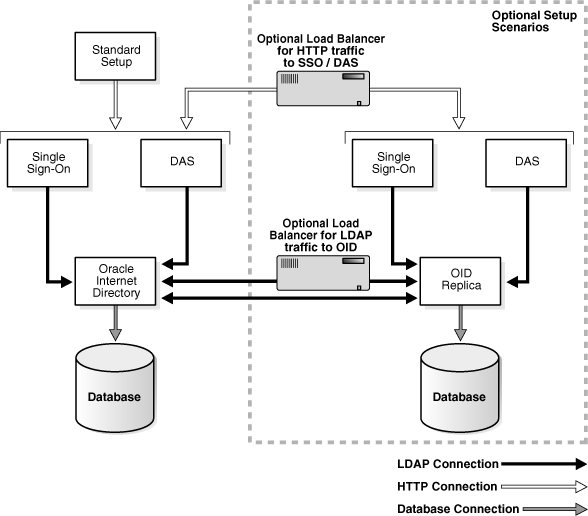

As shown in Figure 12-1, a variety of components and communication paths may be configured for SSL. The following lists references to the instructions for each:
Communication between the Oracle Internet Directory Replication server and the Oracle Internet Directory server: Oracle Application Server High Availability Guide, section titled "Secure Sockets Layer (SSL) and Oracle Internet Directory Replication"
Communication between Oracle Directory Integration and Provisioning and the Oracle Internet Directory server: Oracle Identity Management Integration Guide, chapter titled "Oracle Directory Integration and Provisioning Server Administration"
The OC4J_SECURITY instance to the Metadata Repository database and Oracle Internet Directory to the Metadata Repository database
If Oracle Internet Directory configured to accept SSL connections on the SSL port specified, you need only specify the SSL protocol and SSL port in the JDBC URL requesting an application, as follows:
ldaps://host:sslport/...
Note that when you are using a secure connection, you must add an s to the name of the protocol. For example, use ldaps instead of ldap.
If Oracle Internet Directory is not configured to accept SSL connections on the SSL port, you must modify the configuration. See Oracle Internet Directory Administrator's Guide, section titled "Secure Sockets Layer (SSL) and the Directory."
Figure 12-1 Oracle Identity Management Components and SSL Connection Paths

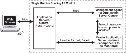

Oracle Enterprise Manager 10g comprises two components, each of which can be configured for SSL communication: Grid Control Console and Application Server Control Console.
Follow the steps in the "Configuring Security (SSL and HTTPS) for Grid Control" in the Oracle Enterprise Manager Advanced Configuration Guide.
The communication paths of interest in the SSL configuration of Application Server Control Console are shown in Figure 12-2, and are labeled https.
Figure 12-2 SSL Connection Paths in Oracle Enterprise Manager 10g
To secure the communications between the Web browser and the Application Server Control Console, and between the Application Server Control Console and the Oracle Application Server components, refer to Section A.3, "Configuring Security for the Application Server Control Console".
