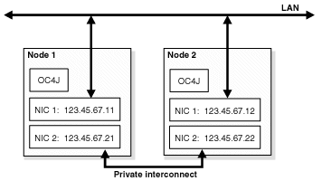

A.2.1 Using Multiple NICs with OracleAS Cluster (OC4J-EJB)
Problem
If you are running OracleAS Cluster (OC4J-EJB) on computers with two NICs (network interface cards) and you are using one NIC for connecting to the network and the second NIC for connecting to the other node in the cluster, multicast messages may not be sent or received correctly. This means that session information does not get replicated between the nodes in the cluster.
Figure A-1 OracleAS Cluster (OC4J-EJB) Running on Computers with Two NICs
Description of Figure A-1 follows
Description of "Figure A-1 OracleAS Cluster (OC4J-EJB) Running on Computers with Two NICs"
Solution
You need to start up the OC4J instances by setting the oc4j.multicast.bindInterface parameter to the name or IP address of the other NIC on the node.
For example, using the values shown in Figure A-1, you would start up the OC4J instances with these parameters:
On node 1, configure the OC4J instance to start with up with this parameter:
-Doc4j.multicast.bindInterface=123.45.67.21
On node 2, configure the OC4J instance to start with up with this parameter:
-Doc4j.multicast.bindInterface=123.45.67.22
You specify this parameter and its value in the "Java Options" field in the "Command Line Options" section in the Server Properties page in the Application Server Control Console (Figure A-2).
