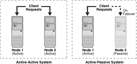

Active-active solutions deploy two or more active system instances and can be used to improve scalability as well as provide high availability. All instances handle requests concurrently.
Active-passive solutions deploy an active instance that handles requests and a passive instance that is on standby. In addition, a heartbeat mechanism is set up between these two instances. This mechanism is provided and managed through operating system vendor-specific clusterware. Generally, vendor-specific cluster agents are also available to automatically monitor and failover between cluster nodes, so that when the active instance fails, an agent shuts down the active instance completely, brings up the passive instance, and application services can successfully resume processing. As a result, the active-passive roles are now switched. The same procedure can be done manually for planned or unplanned down time. Active-passive solutions are also generally referred to as cold failover clusters.
Figure 1-1 Active-Active and Active-Passive High Availability Solutions

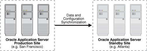

Disaster recovery solutions typically set up two homogeneous sites, one active and one passive. Each site is a self-contained system. The active site is generally called the production site, and the passive site is called the standby site. During normal operation, the production site services requests; in the event of a site failover or switchover, the standby site takes over the production role and all requests are routed to that site. To maintain the standby site for failover, not only must the standby site contain homogeneous installations and applications, data and configurations must also be synchronized constantly from the production site to the standby site.
Figure 1-2 Geographically Distributed Disaster Recovery

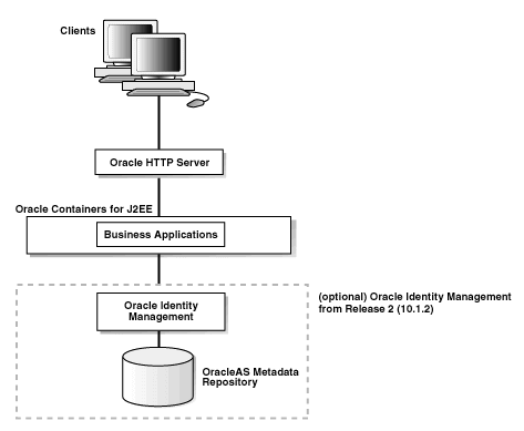

Before creating a highly available Oracle Application Server installation, you should understand Oracle Application Server's base architecture. Then, to make Oracle Application Server highly available, you examine every component and connection path between components and make each one of them highly available. This produces a highly available architecture by adding redundancy to the base architecture.
Figure 1-3 illustrates the base architecture of Oracle Application Server.
Figure 1-3 Oracle Application Server Base Architecture
At a high level, Oracle Application Server consists of Oracle HTTP Server and Oracle Containers for J2EE ("OC4J"). OC4J provides the J2EE containers on which you deploy your business applications.
You can use Oracle Identity Management from Release 10.1.4, Release 2 (10.1.2), or Release 9.0.4, as needed. See the next section for details.
This release of Oracle Application Server includes only the J2EE middle tier; it does not include Oracle Identity Management or the OracleAS Metadata Repository.
If your business applications need services provided by the Oracle Identity Management components, you can deploy and run your business applications on J2EE middle tier from Release 3 (10.1.3.1.0), and the applications can access Oracle Identity Management from Release 10.1.4, Release 2 (10.1.2.x), or Release 9.0.4. See Figure 1-3.
Oracle Identity Management manages user authentication, authorization, and identity information. Its main components are:
OracleAS Single Sign-On
Oracle Delegated Administration Services
Oracle Internet Directory
Oracle Directory Integration and Provisioning
OracleAS Certificate Authority
In a highly available environment, you need middle tiers, Oracle Identity Management, and OracleAS Metadata Repository all to be highly available. This guide describes how to set up highly available J2EE middle tiers. For information on setting up highly available Oracle Identity Management and OracleAS Metadata Repository, see the Oracle Application Server High Availability Guide from the Oracle Identity Management release you are using.
Note that although you have an OracleAS Metadata Repository database associated with the Oracle Identity Management release, the OracleAS Metadata Repository database is not used to store DCM or Release 3 (10.1.3.1.0) instance configuration information. There is no DCM in Release 3 (10.1.3.1.0). The OracleAS Metadata Repository is used only for the Oracle Identity Management components.
