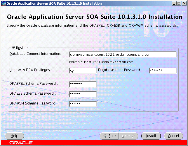

Oracle Application Server SOA Suite 10.1.3.1.0 Installation Screen (Figure 4-2.)
Figure 4-2 Oracle Application Server SOA Suite 10.1.3.1.0 Installation Screen
Database Connect Information: Specify the hostname, port, and service name for the database. Use the format hostname:port:service name.
User with DBA Privileges: Specify the login name for the DBA user.
Database User Password: Enter the password for the user specified in the User with DBA Privileges field.
ORABPEL Schema Password: Enter the password for the ORABPEL schema in the database specified in the Database Connect Information field.
ORAESB Schema Password: Enter the password for the ORAESB schema in the database specified in the Database Connect Information field.
ORAWSM Schema Password: Enter the password for the ORAWSM schema in the database specified in the Database Connect Information field.
