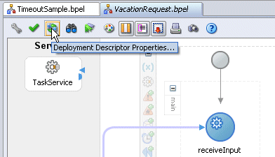

  1. Click the Deployment Descriptor Properties icon, as shown in Figure C-1 (located in the upper-left area of a BPEL diagram).
    Figure C-1 Deployment Descriptor Properties Icon

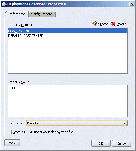

  2. In the Deployment Descriptor Properties window, click the Preferences tab, shown in Figure C-2.
    Figure C-2 Deployment Descriptor Preference Properties
    Description of depdesc11.gif follows
  3. Click Create and enter a preference name.
  4. Edit the value in the Property Value field and click OK.
    The change takes effect immediately, and is reflected in bpel.xml, in the preferences tag, as follows:

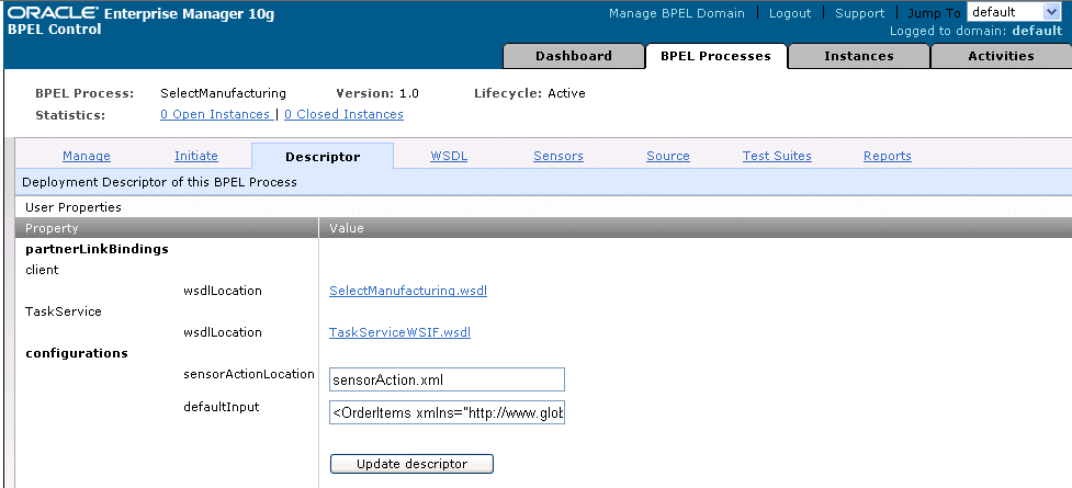

  1. Click the BPEL Processes tab.
  2. Click a process name and then the Descriptor tab.
    The deployment descriptor for the process, including any preferences, is displayed, as shown in Figure C-3.
    Figure C-3 Updating BPEL Process Preferences at Run Time
    Description of depdesc3.gif follows
  3. Update the preference value, and click Update descriptor.
    The change takes effect immediately.

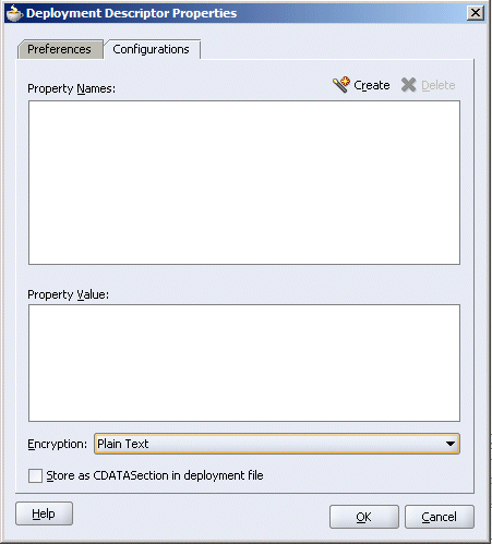

  2. In the Deployment Descriptor Properties window, click the Configurations tab, shown in Figure C-4.
    Figure C-4 Deployment Descriptor Configuration Properties
    Description of depdesc2.gif follows
  3. Click Create and enter a configuration name.
    The change takes effect immediately, and is reflected in bpel.xml.
