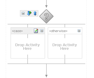

  2. Click the + sign to expand the switch activity.
    The switch activity has two switch case branches by default, each with a box for functional elements. If you want to add more branches, select the entire switch activity, right-click, and select Add Switch Case from the menu.
    Description of switch3.gif follows
  3. Right-click the first branch and select Edit from the menu.
    The Switch Case window appears.
  4. Enter an XPath Boolean expression in the Expression field by pressing the Ctrl key and then the space bar to start the XPath Building Assistant. For example:
    bpws:getVariableDate('loanOffer1','payload','/loanOffer/APR') >
    bpws:getVariableData('loanOffer2','payload','/loanOffer/APR')
  5. Enter this expression on one line. To use the XPath Expression Builder, click the XPath Expression Builder icon above the Expression field.
