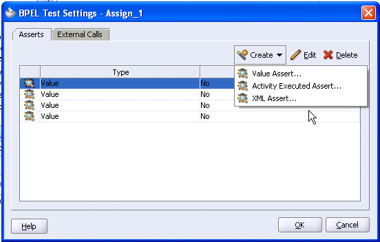

20.1.4 Assertions Overview
Assertions enable you to verify variable data or process flow. You can perform the following types of assertions:
  • Simple Value Assert — Compare the value of a selected string or number variable to an expected value. An error message that you define is displayed if a comparison fails.
  • XML Assert — Compare the element values of an entire XML document to the expected element values. An error message that you define is displayed if a comparison fails.
  • Activity Executed Assert — Execute an activity a specified number of times. This ensures that an activity executes the correct number of times. This is useful for verifying process flow.

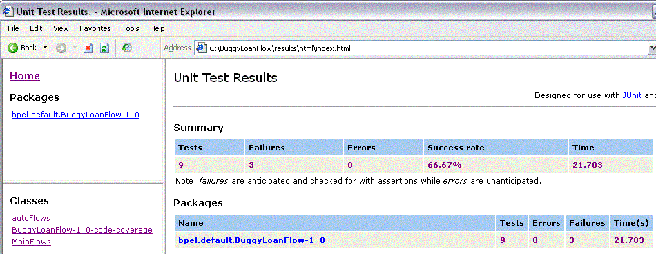

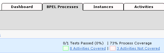

20.1.5 Process Code Coverage Overview
Code coverage provides a method for calculating the completeness of the executed tests. This is calculated as the percentage of simple activities executed at least once, compared to the number of simple activities defined in the BPEL process. Simple activities are nonstructured activities such as invoke, receive, reply, and assign activities.
20.1.6 JUnit Support Overview
JUnit is an open source test framework to use for creating regression tests for Java applications. JUnit is an instance of the xUnit architecture for unit testing frameworks.
By default, the reports created during test suite execution are in JUnit XML format.
While reports display in JUnit XML format, the tests from which reports are created are Oracle BPEL Process Manager tests, and not JUnit tests.

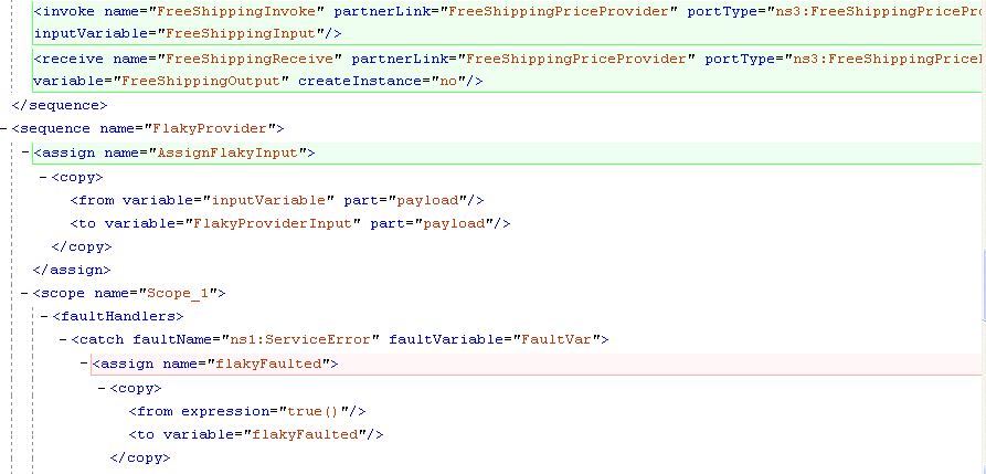

20.2.2 Emulations
You create emulations to simulate the message data that your BPEL process receives from Web service partners. PriceFinder invokes two pricing services:
  • FlakyPriceProvider
  • FreeShippingPriceProvider
The following test code instructs Oracle BPEL Process Manager to first skip the outbound invocation to the FreeShippingPriceProvider service and then emulate receiving a response:
<BPELTest processName=LoanFlow" processRevision="1.0"
             xmlns="http://xmlns.oracle.com/bpel/instancedriver"
         Skip outbound invoke
    <activityDriver name="FreeShippingInvoke">
      <emulate/>
    </activityDriver>
         Emulate the FreeShippingPriceProvider Service
    <activityDriver name="FreeShippingReceive" firstIteration="1"
                   lastIteration="1">
      <emulate duration="PT">
         <inboundMessage>
            <part name="payload">
               <content>
<PriceProviderProcessResponse xmlns="http://xmlns.oracle.com/PriceProvider">
    <itemPrice>70</itemPrice>
    <shippingCost>0</shippingCost>
    <deliveryTime>P3D</deliveryTime>
</PriceProviderProcessResponse>
               </content>
            </part>
         </inboundMessage>
      </emulate>   </activityDriver>
In the first test, the emulate element is empty. This is because the activity is a one-way invoke, and is skipped. In the second test, a receive activity is emulated. This means you must specify the inbound message.

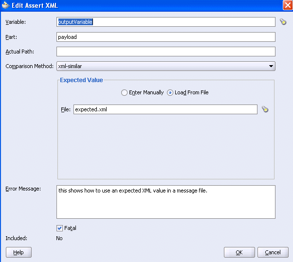

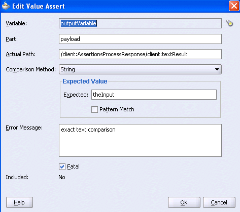

20.2.3 Assertions
You create assertions to validate a variable or an entire XML document at a point during BPEL process execution.
 <activityDriver name="choosePrice">
    <assertValue variableName="outputVariable" partName="payload"
                 comparisonMethod="number" fatal="true" patternMatch="false">
      <message>The item price is incorrect!</message>
      <actualPath>/ns2:PriceProviderProcessResponse/ns2:itemPrice</actualPath>
      <expected>65</expected>
    </assertValue>
This test tells Oracle BPEL Process Manager that after the choosePrice activity has completed, ensure that the item price content in the outputVariable variable matches the content specified.

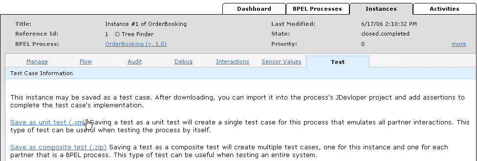

Test case content can also be created from the audit trail in Oracle BPEL Control.

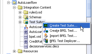

  1. Expand the BPEL process in which to create a test suite in the Application Navigator.
    This displays the Test Suites folder under Integration Content.
  2. Right-click Test Suites and select Create Test Suite.
    Description of ts_create.gif follows
  3. Enter a test suite name (for example, logicTest).
  4. Click OK.
    The test suite is created beneath the Test Suites folder in the Application Navigator:

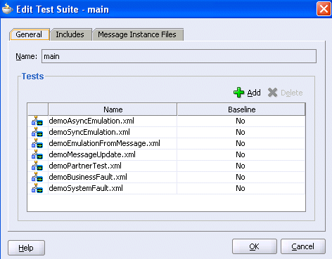

20.3.2 Importing Test Cases in Oracle JDeveloper
This section describes how to import test cases into a test suite in Oracle JDeveloper.
  1. Right-click the test suite name you entered in Step 3 of "Creating Test Suites in Oracle JDeveloper" and select Edit Test Suite.
    This displays the Edit Test Suite window.
    Description of ts_edit.gif follows
    You can create the content for test cases manually or through audit trail output from Oracle BPEL Control. You then import the files into Oracle JDeveloper. You can validate a test case in the Application Navigator by right-clicking it and selecting Validate XML.
    This window consists of the following tabs for importing test cases:
    Tab Description
    General The tab enables you to add test cases to your test suite.
    Add a test file by clicking Add. These files are added to the following directory:
    JDev_Oracle_Home\jdev\mywork\application_name\
    process_name\bpel\testsuites\test_suite_name
    You can also select to add this test file as a baseline test. A baseline test is a generic test that can be imported and used by other tests. These files enable you to factor out common testing actions so they do not need to be repeated in multiple files.
    Includes This tab enables you to add baseline (include) test cases.
    Add a baseline test file by clicking Add. These files are added to the following directory:
    process_name\bpel\testsuites\test_suite_name\includes
    Baseline files consist of generic tests that do not run on their own. Instead, these tests are imported and called by other tests.
    Including a baseline test in a test case brings everything from the baseline test into the test case. If a particular action in the baseline is not desired, it can be overridden in the test case.
    Message Instance Files This tab enables you to add emulated message instance test cases.
    Add a message instance test file by clicking Add. These files are added to the following directory:
    process_name\bpel\testsuites\test_suite_name\messages
    Message instance files provide a method for simulating the message data received back from Web service partners. You can manually enter the received message data into this XML file or copy it from audit trail output in Oracle BPEL Control.
    Importing message instance files enables you to reduce the test file size and improve readability.

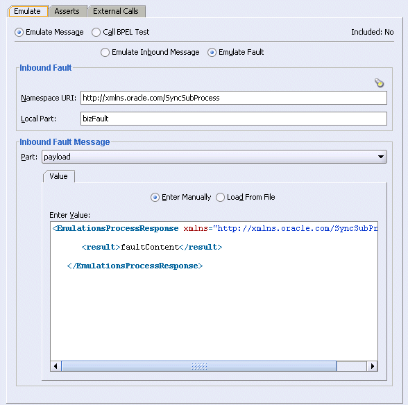

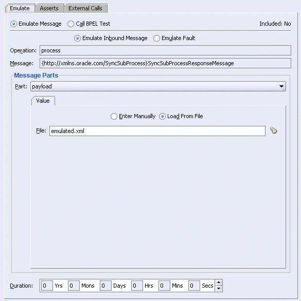

20.3.4.1 Creating Emulations in Oracle JDeveloper
You create emulations to simulate either message data, fault data, or both types that your BPEL process receives from Web service partners. The fields that display on this window are based on the activity type selected (an invoke or receive are supported) and the radio buttons selected at the top of this window:
Notes:
  • One-way invokes can be skipped. This is because these types of invokes do not receive any data from the partner link.
  • You can override the emulations defined in the top-level test case added in the Edit Test Suite - General tab by clicking Override Included Emulation in the BPEL Test Settings - Emulate tab.
20.3.4.1.1 Emulating Inbound Messages
Select this check box to send an inbound message from a client, then select the type of return message data to simulate from the Web service partner. This feature is available for receive activities and two-way invoke activities.
  1. Select Emulate Inbound Message.
  2. Enter the following details:
    Field Value
    Operation This field is automatically completed with the operation type for the activity (for example, a process operation in an invoke activity).
    Message This field is automatically completed with the path to the inbound message.
    Part Select the part of the inbound message (for example, a payload).
    Value
    • Enter Manually
    • Load From File
    Create a simulated message to return from a Web service partner:
    Click to enter message data in the Enter Value field.
    Click the flashlight icon to load message data from a file.
    Duration Enter the amount of time to wait for the message to be delivered from the Web service partner. This field displays for two-way invoke activities.
    An example of this window with completed content is shown below:
    Description of ts_emul2.gif follows
20.3.4.1.2 Emulating Faults
Select this check box to send an inbound system fault from a client. Then, select the type of return fault message to simulate from the Web service partner. This enables you to test fault handling capabilities in your process. This feature is available for invoke activities.
  1. Select Emulate Fault.
    Field Value
    Namespace URI A fault must have a unique qualified name (QName). This activity must provide a name for the fault and optionally provide a variable of data that provides further information about the fault.
    Click the flashlight icon to select the fault to monitor. The Namespace URI field is automatically completed with a URL path based on your fault selection.
    Local Part Displays the local part selection you make for the Namespace URI field. For example, if you select a Web service partner with an associated fault named NegativeCredit, then the name NegativeCredit is added to this field.
    Part Select the message part containing the fault (for example, a payload).
    Value
    • Enter Manually
    • Load From File
    Create a simulated fault message to return from a Web service partner:
    Description of ts_emul3.gif follows
    For one-way invokes, only system faults can be emulated. For two-way invokes, both system and user-defined business faults can be emulated.

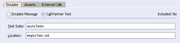

20.3.4.1.3 Emulating BPEL or Partner Tests
In the case where the partner is a BPEL process, you can pass a test case for this partner to execute. This is useful if you want to test the interaction between your BPEL processes, but not any external partners. For example, assume you have a main BPEL process that calls a subprocess that in turn calls human workflow from a test for the main BPEL process. Instead of emulating the subprocess, you can invoke a test case of the subprocess that emulates the human workflow service. This enables you to test the interoperability of your BPEL processes without having to invoke the human workflow service. The name of this radio button is based upon the type of activity selected. For one-way invoke activities, the name is Call Partner Test. For two-way invoke activities, the name is Call BPEL Test. For receive activities, this radio button is disabled.
  1. Select Call Partner Test or Call BPEL Test.
  2. Enter the name and relative location of the test in the test suite to run.
    Description of ts_emul4.gif follows
20.3.4.2 Creating Assertions in Oracle JDeveloper
You perform assertions to verify variable data or process flow. Variable data assertions enable you to validate test data in a variable as a process is executed. This is done by extracting a value from a variable or an XML document and comparing it to an expected value. To verify process flow, you can assert the number of times that an activity has been executed.
  1. Click Create to display a list of tests.
    Description of ts_asserts.gif follows
  2. Select a test and see the corresponding section for details.
    Selection See Section...
    Value Assert "Creating Value Asserts"
    Activity Executed Assert "Creating an Activity Execution Assert"
    XML Assert "Creating XML Asserts"
20.3.4.2.1 Creating Value Asserts
This test compares the value of a selected string or number variable to an expected value. The XPath expression specified must resolve to a simple type (for example, string, number, and so on).
  1. Enter the following details:
    Field Value
    Variable Click the flashlight icon to select a variable XPath value. The value for this variable is extracted during testing and compared to the expected value defined below.
    Part Displays the part selection you make for the Variable field.
    Actual Path Displays the path selection you make for the Variable field.
    Comparison Method Select the variable value type to perform a string comparison or numerical comparison.
    Expected Enter the value you are expecting the variable to contain.
    Pattern Match Select if the value entered in the Expected field is a regular expression pattern that you want to compare (for example, [0-9]*).
    Error Message Enter a message to display if the assertion fails.
    Fatal Select this check box if you want the assertion to be fatal. This causes the instance to immediately terminate. If not selected, the instance continues to execute.
    Warning: For this release, fatal assertions are not supported at runtime. Create nonfatal assertions only. Test instances with fatal assertions hang and can impact Oracle BPEL Server performance.
    Description of ts_valueassert.gif follows

20.3.4.2.3 Creating XML Asserts
This test compares the element values of an entire XML document to the expected element values.
    Field Value
    Variable Click the flashlight icon to select a variable XPath value. The element value for this variable is extracted during testing and compared to the expected element value defined below.
    Actual Path (Optional) Displays the path selection you make for the Variable field.
    Comparison Method Specify the strictness of the comparison. For most purposes, xml-similar is sufficient. xml-identical can be used when the comparison must be exact (for example, element ordering).
    Expected Value Select a method for comparing the values:
    • Enter Manually
    Select and manually enter the element value you are expecting the variable to contain.
    • Load From File
    Select and click the flashlight icon to choose a message file containing the element value you are expecting the variable to contain.
    Description of ts_xmlassert.gif follows

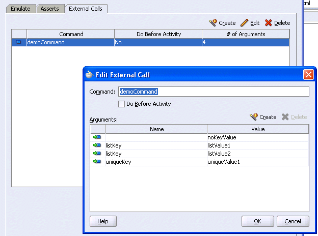

20.3.4.3 Creating External Calls in Oracle JDeveloper
External calls provide an advanced method for performing user actions during the execution of a test case. You specify a fully qualified Java class name for the command. When the test case reaches the activity where the external call is set, the specified Java class is called with the provided arguments. This class must implement the com.oracle.services.bpel.test.ITestCallHandler interface. At run time, this class must be in the ant classpath when running the task. Call handlers are not supported when running tests from Oracle BPEL Control.
  1. Click Create.
    The External Call window appears.
  2. Click Create to create a default argument name and value in the table.
  3. Place your cursor inside the default values for the Name and Value columns, remove the default values, and enter appropriate details.
  4. If you want to execute this command before this activity is executed, select the Do Before Activity check box. Otherwise, the call is executed after the activity.
    Description of ts_extcalls.gif follows
  5. Click OK.
    When the call is executed, these arguments are passed to the Java class.

20.3.5 Creating a Test Case from Oracle BPEL Control
You can create the contents for your test case through audit trail output from Oracle BPEL Control. This provides two benefits:
  • A quick method for creating a baseline test when first starting.
  • A method for converting an error scenario identified during development into a test case. You capture the use case that exposed the bug, add specific data assertions, and add the test to a test suite to run regularly as a regression test. This enables you to ensure that the bug does not re-appear in the future.
  1. Log into Oracle BPEL Control by selecting Start > All Programs > Oracle - Oracle_Home > Oracle BPEL Process Manager > BPEL Control.
  2. Log in as oc4jadmin/password.
    where password is the oc4jadmin password you entered during installation.
  3. Click Instances.
  4. Select a specific instance from which to create test file content.
  5. Click Test.
    If the instance has not yet completed or if the test was already initiated as a test case, you cannot save this instance as a test case.
  6. Select a method:
    1. Click Save as unit test (.xml) to save the contents to a test file. In this case, all partners are emulated.
    2. Click Save as composite test (.zip) to save the contents of multiple tests to a zip file. In this case, BPEL partners are called with test case information while other partners (like human workflow) are emulated.You must then unzip this file before importing the tests into Oracle JDeveloper. Note that with composite tests, tests can call other tests. If you change the name of a composite test file, ensure that you edit any test files that may call this file to include the correct name.
    Description of ts_consoleunittest.gif follows
  7. Save the file as XML to a directory location.

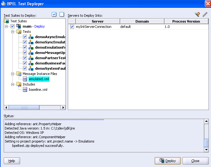

20.4.1 Deploying from Oracle JDeveloper
Oracle JDeveloper can be used to deploy test suites manually when you are first create them.
Follow these steps to deploy test suites from Oracle JDeveloper.
  1. Ensure that you first deploy the BPEL process with which the test suite is associated. The process and the test suite must be deployed separately and cannot be deployed together.
  2. Right-click the Test Suites folder and select BPEL Test Deployer.
    The BPEL Test Deployer window appears.
  3. Click the check box for the test suite to deploy.
  4. Expand test_suite_name - Deploy > Tests and select the specific test cases to deploy.
  5. Select the server to which to deploy the tests.
    Description of ts_deploy.gif follows
  6. Click Deploy to compile, validate, and deploy the selected test cases of the test suite.
    Deployment status messages display in the Status section.

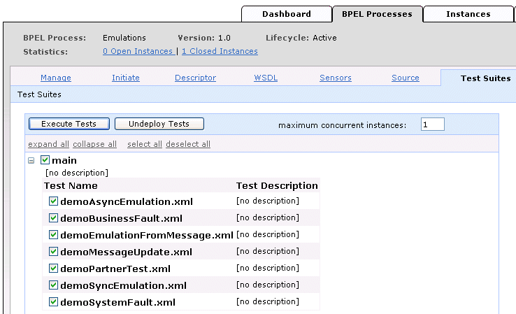

20.5.1 Running from Oracle BPEL Control
Oracle BPEL Control can be used to run tests manually and generate report results.
Follow these steps to run test suites and view report results from Oracle BPEL Control.
    where password is the oc4jadmin password.
  3. Click BPEL Processes.
  4. Click the instance to test.

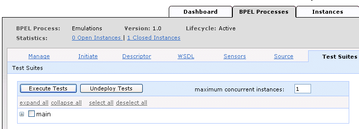

  5. Click Test Suites.
    If a test suite was deployed with this instance, the following window appears.
    Description of ts_testsuite1.gif follows
    If a test suite has not been deployed with this instance, this window does not appear. You must first deploy a test suite.
  6. Select the check box for the test suite (for this example, named main).
    Check boxes for the tests in the test suites appear.
  7. Select the XML tests you want to run.
    Description of ts_testsuite2.gif follows
    You can also undeploy test suites by clicking Undeploy Tests.
  8. Click Execute Tests.

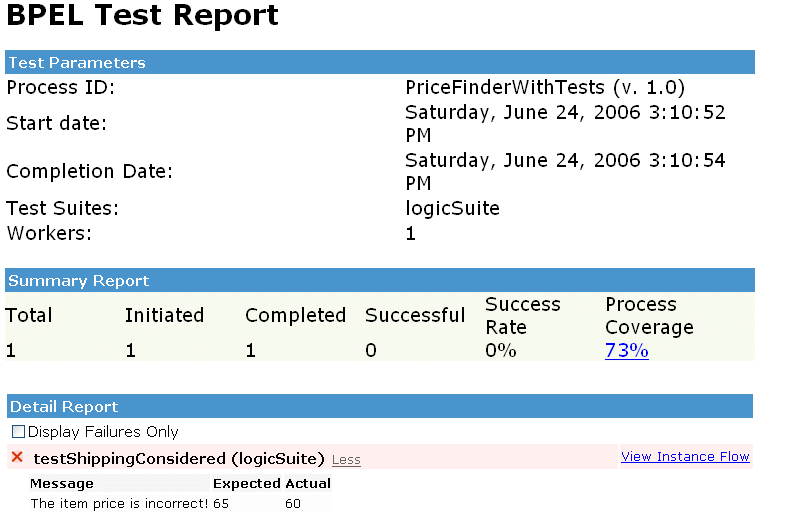

    As tests complete, the window is updated with results in three sections:
    • Test details such as process name, test run dates, which suites ran, and the number of workers appear. A worker is the number of concurrent threads that can run one or more test cases. The number of workers controls how many test cases can be run simultaneously.
    • A summary report displays the outcomes of the tests and code coverage.
    • A detailed listing of all the tests and which assertions failed is displayed. Note the Display Failures Only check box. When checked, detailed information for successful tests is hidden. By default, this check box is checked.
    Description of ts_report.gif follows
  9. Click the percentage value link under Process Coverage to view the amount of source code executed.
  10. Click one of the following links in the upper right corner of Oracle BPEL Control to view specific code coverage details.
    Description of ts_coverage.gif follows
    Activities that were executed are framed in green and those that were not are framed in red.
    Description of ts_coverage2.gif follows
  11. Click View Instance Flow to view additional details or click Back to BPEL Control.
20.5.2 Running from an ant Task
An ant task can be used to run test suites and generate report results. This task is useful in an automated testing environment. By default, the test results are formatted as JUnit XML test results. This format provides the following benefits:
  • Uses the junitreport task to produce a frames-based report.
  • Integrates your BPEL test results with other JUnit results (if you use JUnit to test your Java components).
  • Integrates with other third-party test suite frameworks that also use the JUnit report format.
Follow these steps to run tests and create reports from an ant task.
  1. View the ant task parameters used to run test cases and generate reports in the build.xml file. This file is located in the Resources folder of your BPEL process.

    The following example shows an ant-generated report:
    Description of ts_junit1.gif follows
    Since JUnit is being used, several Java constructs such as packages and classes are included in the report. For Oracle BPEL Process Manager, the default package resolves to bpel.domain.process-revision, but this can be customized. Classes map to test suite names. Note the code coverage suite. This is added when you specify a minimum code coverage in the ant task. In the main pane, a summary of the test results is shown. If you package results from multiple processes in this report, there are more entries in the Packages table.
  5. Click the package name (BPEL process) to display report results.
    Description of ts_junit2.gif follows

20.6.3 Verifying External Actions
You can extend your test cases beyond BPEL. For example, assume you have a BPEL process that alters an external system. You can write a test case that invokes an instance of the BPEL process and calls an API that verifies that the external system was updated appropriately. Since there is limited support for this in the BPEL test framework, you can write custom XPath functions to verify data and then use these functions in assertions. There is no design time support for this. To do this manually, write an assertion as follows:
<activityDriver name="Assign_1">
  <assertValue fatal="true">
    <message>exact text comparison</message>
    <actualPath>ns:extractExternalValue()</actualPath>
    <expected>theInput</expected>
  </assertValue>
In the bold section, note that an XPath function was used instead of the usual XPath query. This function can be implemented to extract a value from an external system The BPEL test framework then compares the value returned by the XPath function to theInput.
