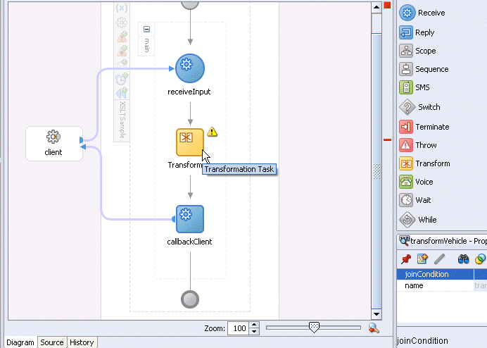

A transform activity enables you to create a transformation using the XSLT Mapper tool. This tool enables you to map source elements to target elements. For example, you can map incoming source purchase order schema data to outgoing invoice schema data.
  1. Drag and drop a transform activity from the Component Palette into your BPEL process diagram.
    Description of mpr16.gif follows

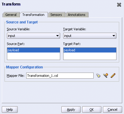

  2. Double-click the transform activity.
    The Transform window appears.
    Description of mpr17.gif follows
  3. Specify the following information:
    • Source variable from which to map elements
    • Source part of the variable (for example, a payload schema consisting of a purchase order request) from which to map
    • Target variable to which to map elements
    • Target part of the variable (for example, a payload schema consisting of an invoice) to which to map
  4. Specify a map file name or accept the default name in the Mapper File field. The map file is the file in which you create your mappings using the XSLT Mapper transformation tool.
  5. Click the magic wand icon (second icon) to create a new mapping. If the file already exists, click the note pad icon (third icon) to edit the mapping.
    The XSLT Mapper appears.
  6. Go to "Overview of the XSLT Mapper" for an overview of using the XSLT Mapper.

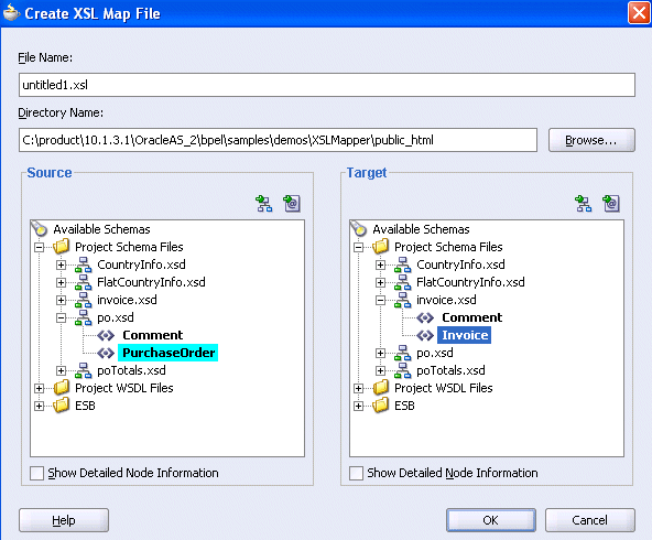

  4. In the Categories tree, expand General and select XML.
  5. In the Items list, double-click XSL Map.
    The Create XSL Map File window appears. This window enables you to create an XSL map file that maps a root element of a source schema file or WSDL file to a root element of a target schema file or WSDL file.
      • Schema files that have been added to the project appear under Project Schema Files.
      • Schema files that are not part of the project can be imported using the Import Schema File facility. Click the Import Schema File icon (first icon to the right and above the list of schema files).
  6. Enter a name for the XSL map file in the File Name field.
  7. Under Source, expand Project Schema Files > po.xsd > PurchaseOrder as the root element for the source.
  8. Under Target, expand Project Schema files > invoice.xsd > Invoice as the root element for the target.
    Description of transf_xslmap.gif follows
  9. Click OK.

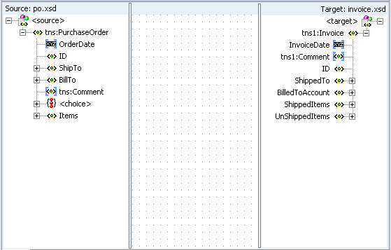

    A new XSL map is created.
    Description of trans_newmap.gif follows
  10. Save and close the file now or begin to design your transformation. Information on using the XSLT Mapper tool is provided in "Overview of the XSLT Mapper".

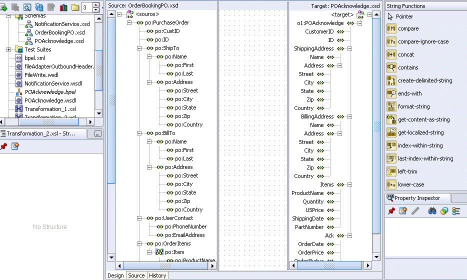

You use the XSLT Mapper transformation tool to create the contents of a map file. Figure 13-1 shows the layout of the XSLT Mapper.
Figure 13-1 Layout of the XSLT Mapper
Description of mpr1.gif follows

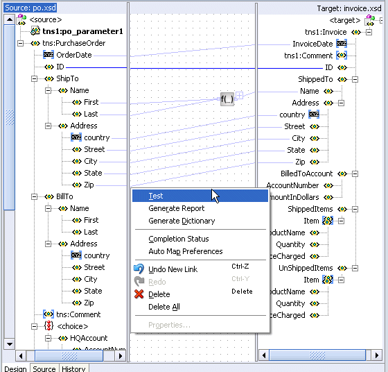

The Source and the Target schemas are represented as trees and the nodes in the trees are represented using a variety of icons. The displayed icon reflects the schema or property of the node. For example:
The various properties of the element and attribute are displayed in the Property Inspector in the lower right of Figure 13-1 (for example, type, cardinality, and so on). The Functions Palette in the upper right of Figure 13-1 is the container for all functions provided by the XSLT Mapper. The mapper pane or canvas is the actual drawing area for dropping functions and connecting them to source and target nodes.
The XSLT Mapper provides three separate context sensitive menus:
Right-click each of the three separate panels to see what the context menus look like. A full set of Undo Auto Map, Redo, Delete, and Delete All functions are also available.

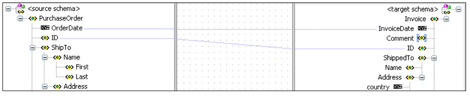

13.4.1 Simple Copy by Linking Nodes
To copy an attribute or leaf-element in the source to an attribute or leaf-element in the target, drag and drop the source to the target. Copy the element PurchaseOrder/ID to Invoice/ID and the attribute PurchaseOrder/OrderDate to Invoice/InvoiceDate, as shown in Figure 13-2.

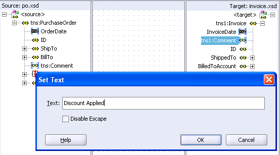

13.4.2 Setting Constant Values
Perform the following steps to set a constant value.
  1. Select a node in the target tree.
  2. Invoke the context menu by right-clicking the mouse.
  3. Select the Set Text menu option.
  4. Enter text in the Set Text window (for example, Discount Applied, as shown in Figure 13-3).
  5. Click OK to save the text.
    A T icon is displayed next to the node that has text associated with it.
  6. If you want to remove the text associated with the node, right click the node to invoke the Set Text window again. Delete the contents and click OK.
Figure 13-3 Set Text Window
Set Text Dialog Box

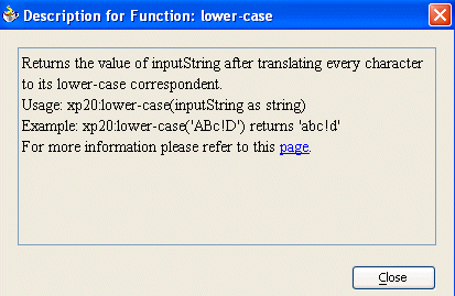

  1. Select a category of functions (for example, String Functions) from the Component Palette.
  2. Right-click an individual function (for example, lower-case).
  3. Select Help. A window with a description of the function appears. You can also click a link at the bottom to access this function's description at the World Wide Web Consortium at www.w3.org.
    Description of funct_desc.gif follows

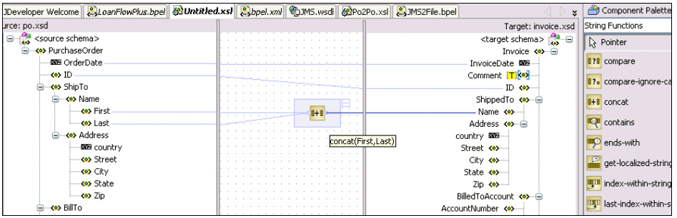

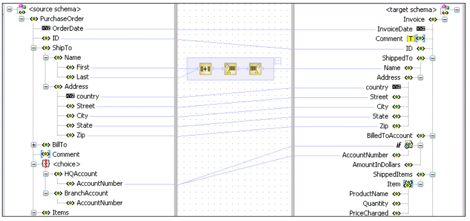

  4. Drag a concat function into the mapper pane. This function enables you to connect the source parameters from the source tree to the function and the output of the function to the node on the target tree.
  5. Concatenate PurchaseOrder/ShipTo/Name/First and PurchaseOrder/ShipTo/Name/Last. Place the result in Invoice/ShippedTo/Name by dragging threads from the first and last names and dropping them on the left side on the concat function. Also drag a thread from the ShippedTo name and connect it to the right side on the concat function, as shown in Figure 13-4.
Figure 13-4 Using the Concat Function
Using Functions

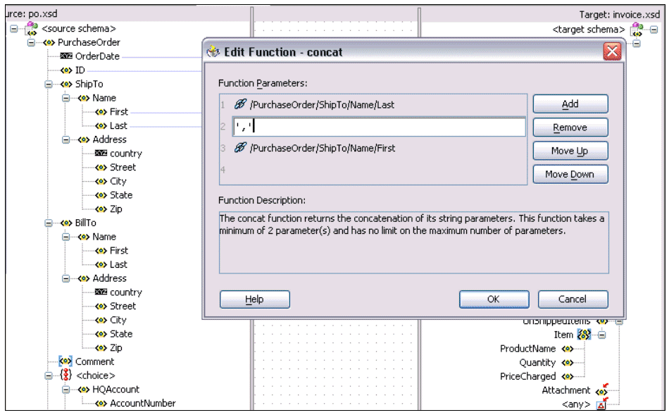

13.4.3.1 Editing Function Parameters
To edit the parameters of the concat function, double-click the function icon to launch the Edit Function - concat window. This window enables you to add, remove, and reorder parameters. If you want to add a new comma parameter so that the output of the concat function is Last, First, then click Add to add a comma and reorder the parameters to get this output.
Figure 13-5 Editing Function Parameters

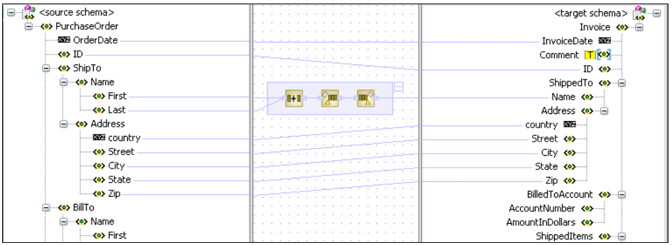

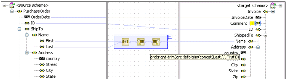

13.4.3.2 Chaining Functions
Complex expressions can be built by chaining functions. To remove all leading and trailing spaces from the output of the above concat function, use the left-trim and right-trim functions and chain them as shown in the Figure 13-6.
The chaining function can also be defined by dragging and dropping the function to a connecting link.
Figure 13-6 Chaining Functions
Chaining Functions

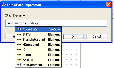

13.4.4 Editing XPath Expressions
To use an XPath expression in a transformation mapping, select Advanced Functions from the Component Palette and drag and drop xpath-expression from the list into the transformation window, as shown in Figure 13-7.
Figure 13-7 Editing XPath Expressions
Description of transform1.gif follows

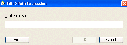

When you double-click the icon, the Edit XPath Expression window appears, as shown in Figure 13-8. You can press the Ctrl key and then the spacebar to invoke the XPath Building Assistant.

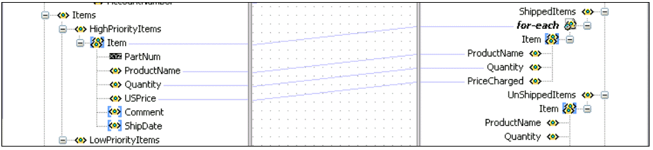

13.4.5 Adding XSLT Constructs
While mapping complex schemas, it is sometimes essential to conditionally map a source node to a target or map an array of elements in the source to an array of elements in the target. The XSLT Mapper provides various XSLT constructs in the context sensitive menu of the target tree for the preceding scenarios. To add an XSLT element like for-each, if, or choose to a schema element, select the element in the target tree. Right-click and select Add XSL Node to bring up the context menu and choose the required XSLT element in the menu.
Elements that display in the XSLT Constructs list and http://www.w3.org/1999/XSL/Transform list of the Component Palette cannot be dragged and dropped into the designer window.

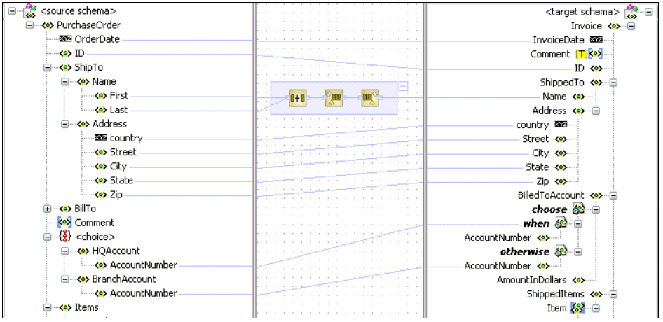

13.4.5.2 Conditional Processing with xsl:choose
You can copy PurchaseOrder/HQAccount/AccountNumber to Invoice/BilledToAccount/AccountNumber, if it exists. Otherwise, copy PurchaseOrder/BranchAccount to Invoice/BilledToAccount/AccountNumber as follows:
  1. Select Invoice/BilledToAccount/AccountNumber in the target tree and right-click to bring up the context sensitive menu.
  2. Select Add XSL Node, and then choose and connect PurchaseOrder/HQAccount/AccountNumber to Invoice/BilledToAccount/choose/when to define the condition.
  3. Connect PurchaseOrder/HQAccount/AccountNumber to Invoice/BilledToAccount/choose/when/AccountNumber.
  4. Select XSL Add Node and then choose in the target tree and right-click to bring up the context sensitive menu.
  5. Select Add XSL node and then otherwise from the menu.
  6. Connect PurchaseOrder/BranchAccount/AccountNumber to Invoice/BilledToAccount/choose/otherwise/AccountNumber.
Figure 13-11 shows the results.
Figure 13-11 Conditional Processing with xsl:choose
13.4.5.3 Handling Repetition or Arrays
The XSLT Mapper allows repeating elements on the source to be copied to repeating elements on the target. For example, copy PurchaseOrder/Items/HighPriorityItems/Item to Invoice/ShippedItems/Item as follows:
  1. Select Invoice/ShippedItems/Item in the target tree and right-click to bring up the context sensitive menu.
  2. Select Add XSL Node, and then for-each and connect PurchaseOrder/Items/HighPriorityItems/Item to Invoice/ShippedItems/for-each to define the iteration.
  3. Connect PurchaseOrder/Items/HighPriorityItems/Item/ProductName to Invoice/ShippedItems/for-each/Item/ProductName.
  4. Connect PurchaseOrder/Items/HighPriorityItems/Item/Quantity to Invoice/ShippedItems/for-each/Item/Quantity.
  5. Connect PurchaseOrder/Items/HighPriorityItems/Item/USPrice to Invoice/ShippedItems/for-each/Item/PriceCharged.
Figure 13-12 shows the results.
Figure 13-12 Handling Repetition or Arrays

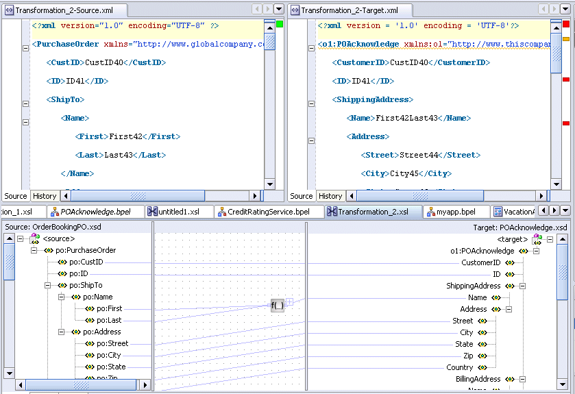

13.4.6 Automatically Mapping Nodes
Mapping nonleaf nodes starts the auto map feature. The system automatically tries to link all relevant nodes under the selected source and target. Try the auto map feature by mapping PurchaseOrder/ShipTo/Address to Invoice/ShippedTo/Address. All nodes under Address are automatically mapped, as shown in Figure 13-13.
Figure 13-13 Auto Mapping
Auto Mapping

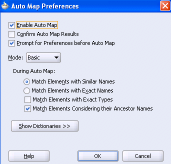

The behavior of the auto map can be tuned by altering the settings in Oracle JDeveloper preferences or by right-clicking the transformation window and selecting Auto Map Preferences. This displays the window shown in Figure 13-14.
Figure 13-14 Auto Map Preferences
This window enables you to customize your auto mapping as follows:
  • Invoke the automatic mapping feature, which attempts to automatically link all relevant nodes under the selected source and target. When disabled, you must individually map relevant nodes.
  • Display and review all potential source-to-target mappings detected by the XSLT Mapper, and then confirm to create them.
  • Be prompted to customize the auto map preferences before the auto map is invoked.
  • Select the Basic or Advanced method for automatically mapping source and target nodes. This enables you to customize how the XSLT mapper attempts to automatically link all relevant nodes under the selected source and target.
  • Manage your dictionaries. The XSLT Mapper uses the rules defined in a dictionary when attempting to automatically map source and target elements.

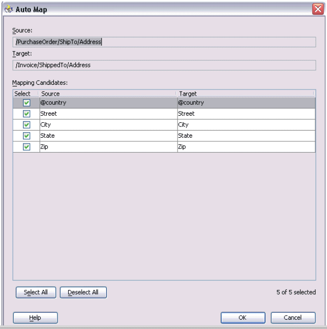

To see potential source mapping candidates for a target node, right-click the target node, select Show Matches, and click OK in the Auto Map Preferences window. The Auto Map window appears, as shown in Figure 13-15.
Figure 13-15 Auto Mapping Candidates
Description of transform6.gif follows
See Also:
The online Help for the Auto Map window by clicking the Help button to see a description of the fields

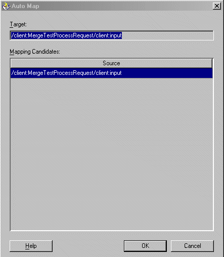

13.4.6.1 Auto Map with Confirmation
When the Confirm Auto Map Results check box shown in Figure 13-14 is selected, a confirmation window appears. If matches are found, the potential source-to-target mappings detected by the XSLT Mapper are displayed, as shown in Figure 13-16. The window enables you to filter one or more mappings.
Figure 13-16 Auto Map with Confirmation
See Also:

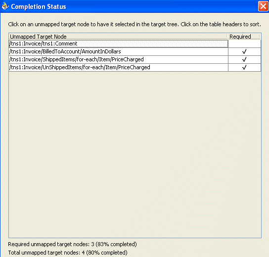

13.4.7 Viewing Unmapped Target Nodes
You can view a list of target nodes that are currently unmapped to source nodes. Right click in the mapper pane and select Completion Status. This window provides statistics at the bottom about the number of unmapped target nodes. This window enables you to identify and correct any unmapped nodes before you test your transformation mapping logic on the Test XSL Map window. Select a target node in the list. The node is highlighted. A check mark indicates that the target node is required to be mapped. If not required, the check box is empty.
Figure 13-17 provides an example of the Completion Status window.

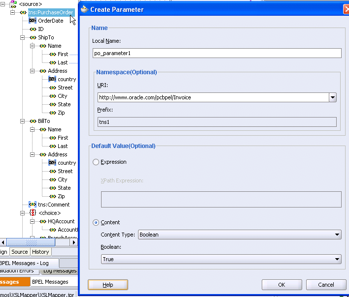

13.4.9.1 Creating a Map Parameter
  1. Right-click the source tree root and select Add Parameter.
    The Create Parameter window appears.
  2. Specify details:
    Description of mpr_params.gif follows
  3. Click OK.

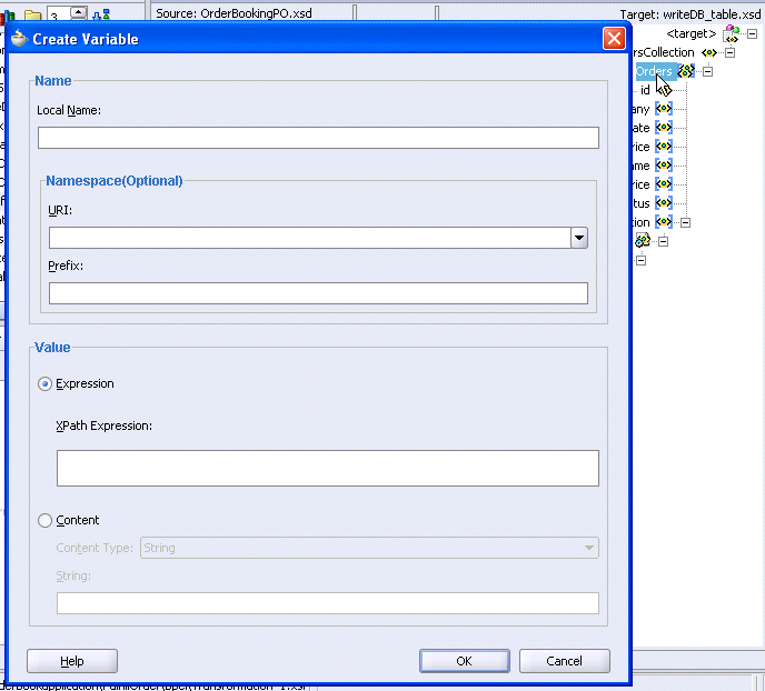

13.4.9.2 Creating a Map Variable
  1. Right-click the target tree root and select Add Variable. If you right-click a node below the target tree root, select Insert Variable.
    The Create Variable window appears.
  2. Specify details:
    Description of trans_addvar.gif follows
  3. Click OK.

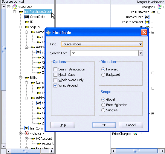

13.4.10 Searching Source and Target Nodes
You can search source and target nodes. For example, you can search in a source node named invoice for all occurrences of the subnode named price.
  1. Right-click a source or target node.
  2. Enter a keyword for which to search.
  3. Specify additional details, as necessary. For example:
    • Select Search Annotations if you want annotations text to also be searched.
    • Specify the scope of the search. You can search the entire source or target tree, search starting from a selected position, or search within a selected subtree.
    Description of mpr_find.gif follows
    The first match found is highlighted, and the Find window closes. If no matches are found, a message displays on-screen.
  4. Select the F3 key to find the next match in the direction specified. To search in the opposite direction, select the Shift and F3 keys.
    You cannot search on functions or text values set with the Set Text option.

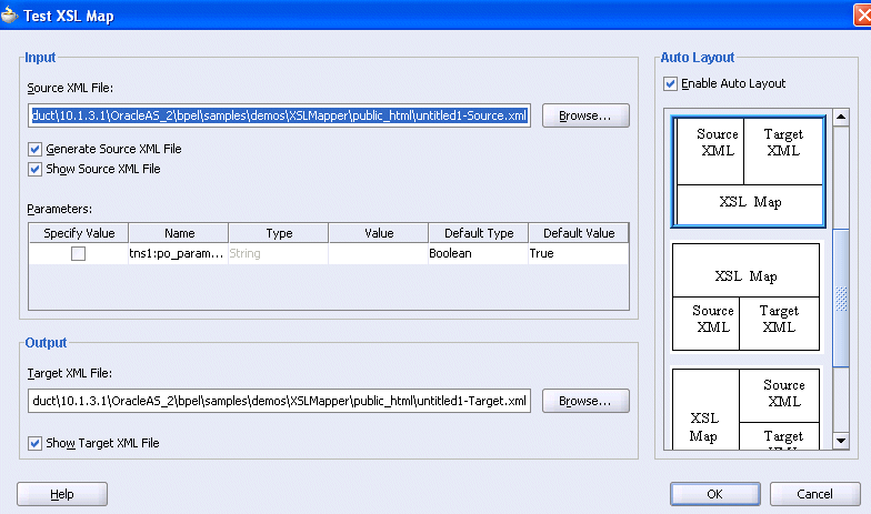

13.5.1 Test XSL Map Window
The Test XSL Map window shown in Figure 13-20 enables you to test the transformation mapping logic you designed with the XSLT Mapper. The test settings you specify are stored and do not need to be entered again the next time you test. Test settings must be entered again if you close and reopen Oracle JDeveloper.
Figure 13-20 Test XSL Map Window
Test Dialog
  1. Choose to allow a sample source XML file to be generated for testing or click Browse to specify a different source XML file in the Source XML File field.
    When you click OK, the source XML file is validated. If validation passes, transformation occurs, and the target XML file is created.
    If validation fails, no transformation occurs and a message displays on-screen.
  2. Select the Generate Source XML File check box to create a sample XML file based on the map source XSD schema.
  3. Select the Show Source XML File check box to display the source XML file for the test. The source XML file displays in an Oracle JDeveloper XML editor.
    If the map has defined parameters, the Parameters table appears. If you want to specify a value, click Specify Value and make appropriate edits to the Type and Value columns.
  4. Enter a file name in the Target XML File field or browse for a file name in which to store the resulting XML document from the transformation.
  5. Select the Show Target XML File check box to display the target XML file for the test. The target XML file displays in an Oracle JDeveloper XML editor.
  6. If you select to show both the source and target XML, you can customize the layout of your XML editors. Select Enable Auto Layout in the upper right corner and click one of the patterns.
  7. Click OK.
    The test results appear.
    For this example, the source XML and target XML display side-by-side, with the XSL map underneath (the default setting). You can right-click an editor and select Validate XML to validate the source or target XML against the map source or target XSD schema.

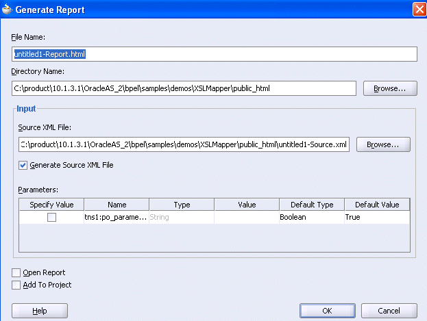

13.5.2 Generating Reports
You can generate an HTML report with the following information:
  • XSL map file name, source and target schema file names, their root element names, and their root element namespaces
  • Target document mappings
  • Target fields not mapped (including mandatory fields)
  • Sample transformation map execution
To generate a report, right-click the transformation window and select Generate Report. The Generate Report window appears in the transformation window, as shown in Figure 13-21. Note that if the map has defined parameters, the Parameters table appears.
Figure 13-21 The Generate Report Window
Description of transform3.gif follows
See Also:
The online Help for the Generate Report window by clicking the Help button to see detailed information
