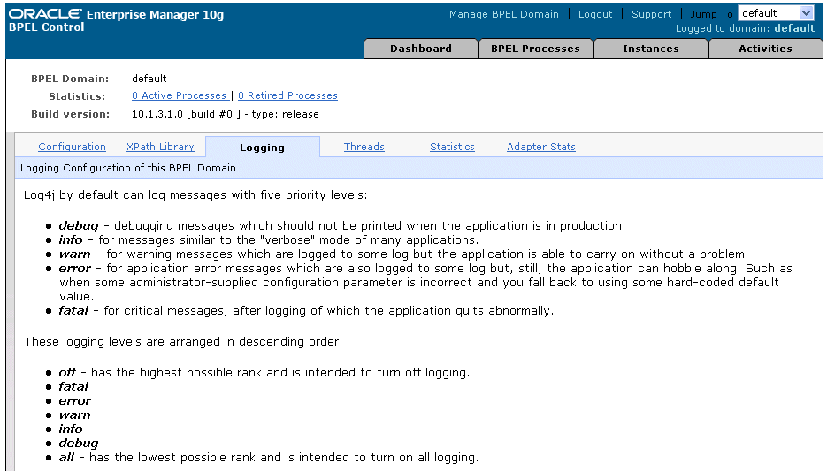

  4. Select Manage BPEL Domain > Logging.
    The Logging window appears.
    Description of logging2.gif follows
    The following logging levels are available and listed here from highest priority to lowest priority. When a logging level is specified, all messages with a lower priority level than the one selected are ignored.
    Logging Level This Selection...
    Off Disables logging. This selection is the highest priority.
    Fatal Logs critical messages. After logging occurs, the application quits abnormally.
    Error Logs application error messages to a log; the application continues to run (for example, an administrator-supplied configuration parameter is incorrect and you default to using a hard-coded value).
    Warn Logs warning messages to a log; the application continues to run without problems.
    Info Logs messages in a format similar to the verbose mode of many applications.
    Debug Logs debugging messages that should not be printed when the application is in a production environment.
    All Enables all logging. This selection is the lowest priority.
    The lower part of the Logging window displays the types of loggers you can set.
