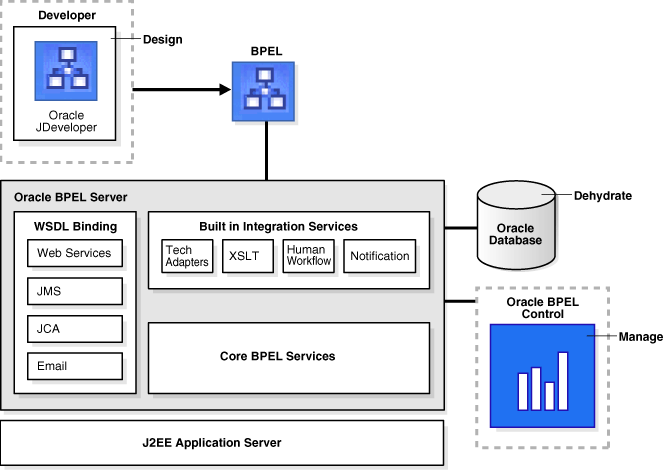

Oracle BPEL Process Manager provides a user-friendly and reliable solution for designing, deploying, and managing BPEL business processes. Oracle BPEL Process Manager consists of the key components shown in Figure 1-1.
Oracle BPEL Process Manager is loaded into Oracle JDeveloper. This extends the functionality of Oracle JDeveloper to enable you to model, edit, and design business processes using BPEL. Oracle JDeveloper provides a graphical and user-friendly way to build BPEL processes. What is unique about Oracle JDeveloper is that it uses BPEL as its native format. This means that processes built with Oracle JDeveloper are 100% portable. Oracle JDeveloper also enables you to view and modify the BPEL source without decreasing the usefulness of the tool. The core BPEL engine provides the most mature, scalable, and robust implementation of a BPEL server available today. Oracle BPEL Process Manager executes standard BPEL processes. Oracle BPEL Process Manager also provides a dehydration capability that enables the states of long-running flows to be automatically maintained in a database, thus enabling clustering for both fail over and scalability. Oracle BPEL Server uses an underlying J2EE application server, with support for most major commercial application servers and a bundled version available.The built-in integration services enable you to use advanced connectivity and transformation capabilities of standard BPEL processes. These capabilities include support for XSLT and XQuery transformation, and bindings to hundreds of legacy systems through Java connector architecture (JCA) adapters and native protocols. A human task service is provided as a built-in BPEL service to enable the integration of people and manual tasks into BPEL flows.The extensible WSDL binding framework enables connectivity to protocols and message formats other than SOAP. Bindings are available for JMS, e-mail, JCA, HTTP GET, HTTP POST, and many other protocols enabling simple connectivity to hundreds of back-end systems.
Oracle Enterprise Manager 10g BPEL Control provides a mature Web-based interface for management, administration, and debugging of processes deployed to Oracle BPEL Server. Audit trails and process history and reporting information are automatically maintained and available through both Oracle Enterprise Manager 10g BPEL Control and a Java API.
