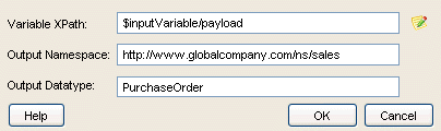

  8. Click the icon to the right of the Variable XPath field.
    The Variable XPath Builder window appears.
  9. Expand and select Variables > inputVariable > payload.
  10. Click OK.
    The Create Activity Variable Sensor window displays the following details:

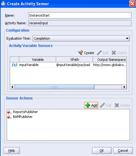

    The Create Activity Sensor window appears as follows:
    Description of obph11sen2.gif follows
  25. Click OK in the Create Activity Sensor window and the Receive window.
