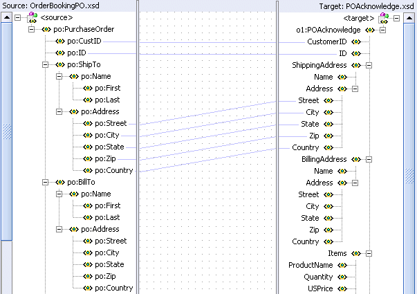

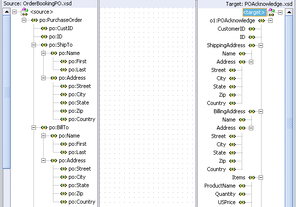

Click the second icon (the Create Mapping icon) to the right of the Mapper File field.
A window for graphically mapping source and target elements appears. This window enables you to drag (map) a source element to a target element. If you instead receive a message saying the file already exists, click the third icon to access the transformation window.
Right-click the source and target schemas (the top-most elements in both lists) and select Expand All.
Drag and drop the following source elements to the following target elements. As you perform this task, a line connects each source to its target.
Note: The namespace values that appear for the source (for example, ns1, po) can vary. Use the namespace values that automatically appear. |
| Drag the Source... | To the Target... |
| po:CustID | CustomerID |
| po:ID | ID |
| po:ShipTo | ShippingAddress
Note: Click OK when prompted to confirm your mapping. Connecting this source and target automatically connects all subelements. |
The Transformation window appears as follows:
Note: If you drag and drop a source element to the wrong target element, right-click the connecting line and select Delete. |

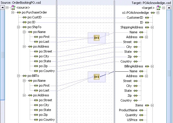

Select String Functions from the Component Palette section.
Drag and drop a concat function into the middle of the transformation window.
Go to the po:ShipTo > po:Name source section.
Drag the po:First and po:Last source elements below po:ShipTo > po:Name into the left side of the concat function. This connects two source lines to the concat function.
Go to the ShippingAddress target section.
Drag the Name target element into the right side of the concat function. This connects the target line to the concat function and concatenates the first and last names from the source elements into a single name in the target element.
Drag and drop another concat function into the middle of the transformation window to map source BillTo to target BillingAddress.
Go to the po:BillTo > po:Name source section.
Drag the po:First and po:Last source elements below po:BillTo > po:Name into the left side of the concat function. This connects two source lines to the concat function.
Go to the BillingAddress target section.

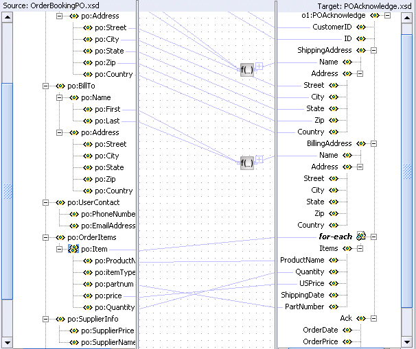

Select and right-click the target Items. This displays a list of XSL functions.
Select Add XSL Node > for-each.
Go to the source po:OrderItems section.
Drag and drop the source po:Item onto the for-each link.
Drag and drop the source po:Item onto the target Items (below the for-each link).
Click OK when prompted to confirm your mapping. This automatically maps all subelements.
This defines a relationship that specifies a one-to-many (1:M) mapping between the source and target.

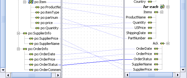

Drag and drop the remaining source purchase order elements to the target purchase order acknowledge elements:
| po:SupplierPrice | SupplierPrice |
| po:SupplierName | SupplierName |
| po:OrderDate | OrderDate |
| po:OrderPrice | OrderPrice |
| po:OrderStatus | OrderStatus |
Select Save from the File main menu.

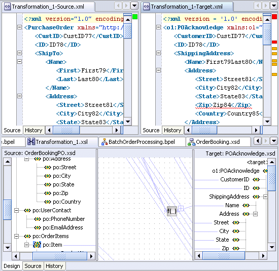

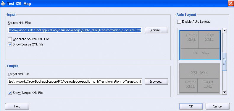

Right-click in the transformation mapping window and select Test.
This displays the Test XSL Map window.
Ensure that Generate Source XML Data is selected.
This creates sample XML test data.
Accept all other default settings.
Click OK to test the translation logic.
Sample test results appear. The source XML and target XML display data side-by-side, with the XSL map data underneath. This is the default layout of test results.
Verify the results.
Close the Transformation_1-Source.xml, Transformation_1-Target.xml, and Transformation_1.xsl files by clicking the x button for each in the Title tab.
A translation file named Transformation_1.xsl appears under POAcknowledge > Integration Content in the Application Navigator section.
