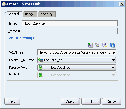

From the Partner Link dialog box in Oracle BPEL Process Manager, shown in Figure 1-1, you can access the adapters that are provided with Oracle BPEL Process Manager.

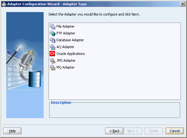

This wizard enables you to configure the types of adapters shown in Figure 1-3 for use with BPEL processes.

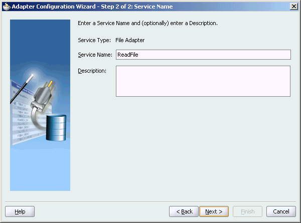

When you select an adapter type, the Service Name window shown in Figure 1-4 prompts you to enter a name. For this example, File Adapter was selected in Figure 1-3. When the wizard completes, a WSDL file by this service name appears in the Applications Navigator for the BPEL process (for this example, named ReadFile.wsdl). This file includes the adapter configuration settings you specify with this wizard. Other configuration files (such as header files and files specific to the adapter) are also created and display in the Applications Navigator.

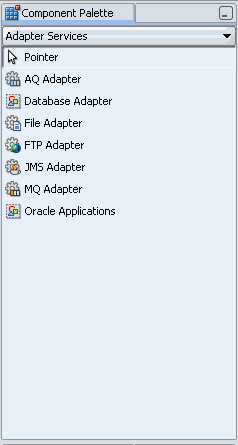

You can access the adapters that are provided with Oracle Enterprise Service Bus through the Component Palette shown in Figure 1-5. When you select Adapter Services in Component Palette, all adapters supported in Oracle Enterprise Service Bus are displayed as shown in Figure 1-5.

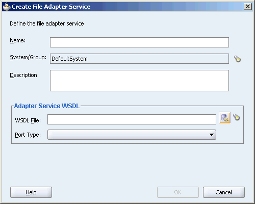

You can drag and drop any adapter service in the design area. Figure 1-6 displays the Create File Adapter Service dialog box which starts when you drag a File adapter service to the design area. You can specify the adapter service name here.
Figure 1-6 Create File Adapter Service dialog box
Description of Figure 1-6 follows
Description of "Figure 1-6 Create File Adapter Service dialog box"
To configure the adapter service, click the Configure adapter service wsdl icon shown highlighted in Figure 1-6. This starts the Adapter Configuiration wizard. When the wizard completes, a WSDL file by the service name appears in the Applications Navigator for the ESB service. This file includes the adapter configuration settings you specify with this wizard. Other configuration files (such as header files and files specific to the adapter) are also created and display in the Applications Navigator.
