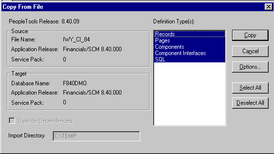

  6. Click Open (in release 8.4) or Copy (in release 8.1) to open the Copy From File dialog box.
    Although the preceding figures illustrate PeopleSoft release 8.4, the corresponding instructions are accurate for releases 8.1 and 8.4.
  7. Highlight all objects listed in Definition Type(s), and then click Copy.
    The Application Designer displays the following message, which indicates successful completion.
    Successful completion message

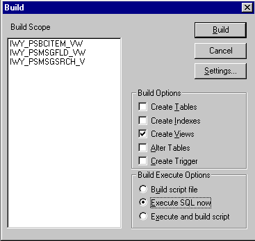

  8. To build the views in the project, select Build, and then select Project.
    The Build dialog box is displayed.
    Build dialog box
  9. In the Build Options pane, select Create Views.
  10. Select your site's customary option in the Build Execute Options pane. (In the previous figure, Execute SQL now is selected.)
  11. Click Build.

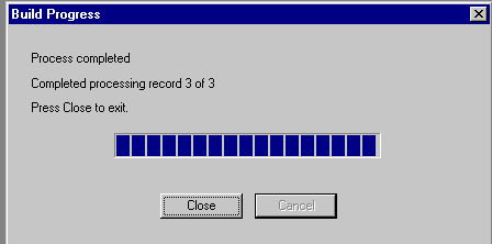

    The Application Designer displays a Build Progress status window.
    Build Progress dialog box
    You can use your native SQL Tool to view the records from the generated view to ensure that they have been created correctly.

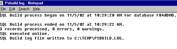

  12. If the view has not been generated correctly, click Close, and double-click the SQL Build log statement.
    The PSBUILD log file appears.
    PSBuild log file

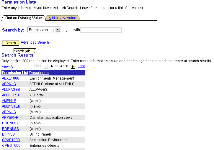

  1. Select PeopleTools, Security, User Profiles, Permissions & Roles, and then Permission Lists.
  2. Click Search and select the relevant Permission List.
    The Permission List pane opens on the right.

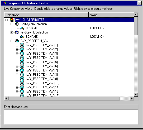

  4. Highlight one of the lines with its corresponding key in the Find Results window and click Get Selected. The relevant data for the selected key is displayed.
    If this window opens, the Component Interface has been successfully tested for the Find method.
    Component Interface Tester data

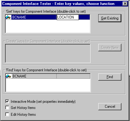

  5. Click Get Existing. For the Get method, an existing key must be entered.
    Component Interface Tester Get Method

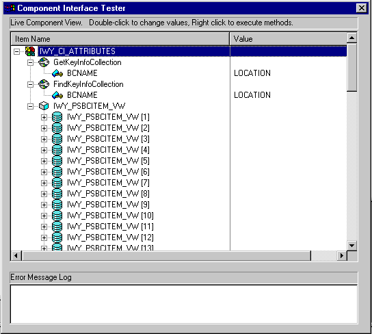

    The exposed properties for the key that is entered are returned.
    If the following window opens, the the Component Interface has been successfully tested for the Get method.
    Component Interface Tester - exposed key properties
