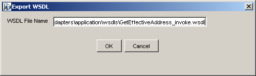

  4. Select Create Outbound JCA Service (Request/Response).
    The Export WSDL dialog box is displayed.
  5. Accept the default name and location for the file.
    The .wsdl file extension is added automatically.
  6. Click OK.
    The WSDL file is created.

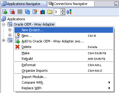

  1. At the top of the upper left pane, click the Applications Navigator tab and select an application.
    JDeveloper Applications tab
  2. Right-click the application and select New Project.

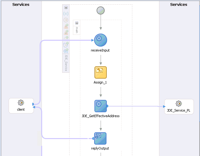

Designing the BPEL Process for GetEffectiveAddress (Outbound Service)
To design the BPEL Process:
  1. From the Services pane on the right, drag and drop a PartnerLink to the visual editor.
    The Create Partner Link dialog box is displayed.
    Create Partner Link window
  2. Click the Service Explorer icon (second icon from the left preceding the WSDL File field).
    The Service Explorer dialog box is displayed.
  3. Expand your new connection under Adapter Services, followed by adapters, and then applications.
    The WSDL tree displayed in the Service Explorer dialog box lists any WSDL files you have created using Application Explorer. The WSDL tree is generated by a WSDL servlet, which is automatically deployed as part of the BPEL Server installation.
  4. Select GetEffectiveAddress_invoke.wsdl and click OK.
    The WSDL File field in the Create Partner Link dialog box displays the name and location of the selected WSDL file. The Partner Link Type field specifies the PartnerLink defined in the WSDL file.
    Create Partner Link
    Perform the following steps:
    1. Leave the My Role field unspecified. The role of the PartnerLink is null, as it will be synchronously invoked from the BPEL process.
    2. From the Partner Role list, select the default value GetEffectiveAddressRole. This is the role of the BPEL process.
  5. Click OK.
    The new PartnerLink appears in the visual editor.
  6. Select Save from the File menu.

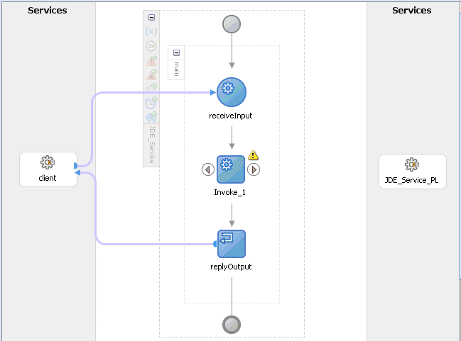

  7. From the Process Activities pane on the right, drag an Invoke activity to the visual editor and place it between the Receive activity (receiveInput) and the Reply activity (replyOutput).
    The Invoke process activity is shown in the following diagram view.
    Diagram View of JDeveloper showing the new activities
  8. Drag the right arrow from Invoke_1 and connect it to the JDE_Service_PL PartnerLink.
    The Edit Invoke dialog box is displayed.
    1. Provide a name for the Invoke activity, for example, JDE_GetEffectiveAddress.
    2. Click the first icon to the right of the Input Variable field, then click OK in the Create Variable window that is displayed.
    3. Repeat the previous step to create a default variable for Output Variable.
  9. Click OK.
  10. Drag an Assign process activity and drop it between receiveInput and JDE_GetEffectiveAddress.
    The following image shows the new Assign activity in JDeveloper visual editor.
    JDeveloper diagram view showing new process activities
  11. Double-click the Assign activity icon.
    The Assign dialog box is displayed.
    Assign dialog box
  12. In the Copy Operation tab, click Create and select Copy Operation.
    The Create Copy Operation dialog box is displayed.
    1. In the From pane, expand Variables, then inputVariable, and then highlight payload.
    2. In the To pane, expand Variables, then JDE_GetEffectiveAddress_GetEffectiveAddress_InputVariable, and then highlight input_GetEffectiveAddress.
    Your Create Copy Operation dialog box should look as follows:
  13. To close the Create Copy Operation dialog box and the Assign dialog box, click OK.
  14. From the Process Activities pane on the right, drag another Assign activity to the visual editor and place it between the Invoke activity (JDE_GetEffectiveAddress) and the Reply activity (replyOutput).
  15. Double-click the Assign activity icon and click Create.
  16. Map JDE_GetEffectiveAddress_GetEffectiveAddress_OutputVariable, output_GetEffectiveAddress to outputVariable, payload.
    Verify that you have mapped all variables as follows:
  17. Click OK, and then click OK again.
  18. Select Save from the File menu.
You have completed the design of your BPEL process.

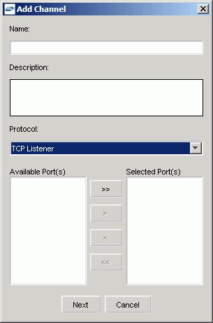

To create a channel:
  1. In Application Explorer, expand the JDEdwards node.
  2. Right-click the Channels node, and select Add Channels.
    The Add Channel dialog box is displayed.
  3. In the Name field, enter a descriptive name for the channel.
  4. In the Description field, enter a description (optional).
  5. From the Protocol list, choose a protocol for your channel.
  6. Click Next.
    The dialog box is displayed for the selected listener.
    System tab
  7. Enter the location of the server in the Host field.
  8. Enter the port number of the channel in the Port Number field.
  9. Select the Synchronization type from the Synchronization Type list.
  10. Select Is Length Prefix for events that send data which is not in XML format. The TCP/IP event application must prefix the data with a 4-byte binary length field when writing the data to the TCP/IP port.
  11. Select Is XML for events that send data back in XML format. No preparser is required.
  12. Select Is Keep Alive to maintain a continuous communication between the event transaction and the channel.

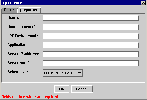

  13. Click the preparser tab.
    User tab
    Enter values based on the table.
    Parameter Description
    User id* A valid user ID for J.D. Edwards OneWorld.
    User password* The password associated with the user ID.
    JDE environment* Your J.D. Edwards OneWorld environment. For more information about this parameter, see your J.D. Edwards OneWorld documentation or ask your OneWorld system administrator.
    Application XMLInterop or the application name in J.D. Edwards OneWorld. Optional.
    Server IP address* The name of the server on which J.D. Edwards OneWorld is running. This can be the name of the server, for example, JDEOW, or its IP address, for example, 123.45.67.89.
    Server Port* The port number on which the server is listening, for example, 6009.
    Schema style Choose a style from the list.
    Click OK.
    The channel is created and displayed under the Channels node. An X over the icon indicates that the channel is currently disconnected.
    The channel you created in Application Explorer is managed by BPEL PM Server. If you start the channel for testing and debugging purposes, stop it before runtime.
    The New Gallery window is displayed.
    New Gallery

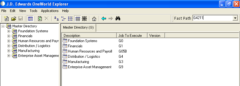

  1. Log in to your J.D. Edwards OneWorld system.
  2. In the Fast Path field of the J.D. Edwards OneWorld Explorer window, type G4211 and press Enter.
    Fast Path field

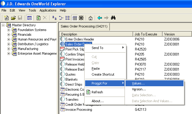

  3. Right-click Sales Order Detail (P4210).
    Sales Order Detail selected and menu showing

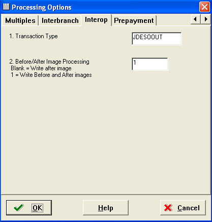

  4. Select Prompt for, and then Values.
    The Processing Options dialog box is displayed.
    1. Click the Interop tab.
    2. In the Transaction Type field, type JDESOOUT.
    3. Verify that the value in the Before/After Image Processing Blank field is 1.

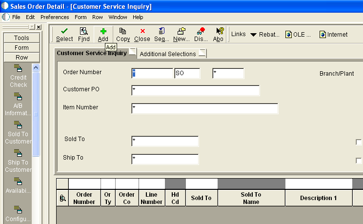

    The Sales Order Detail - (Customer Service Inquiry) window is displayed.
    Sales Order Detail window

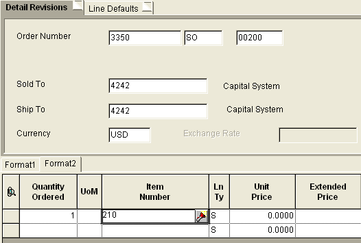

  6. Click the Add icon (third icon from left).

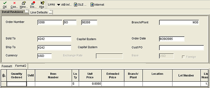

  7. Enter the values as shown in the following screen.
    To move to a different field, use the Tab key on your keyboard.
    The correct order values

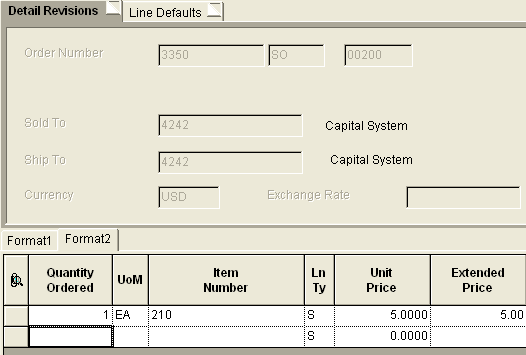

  8. Enter a value for Quantity Ordered and Item Number.
    For example:
    Sample values for Quantity Ordered and Item Number

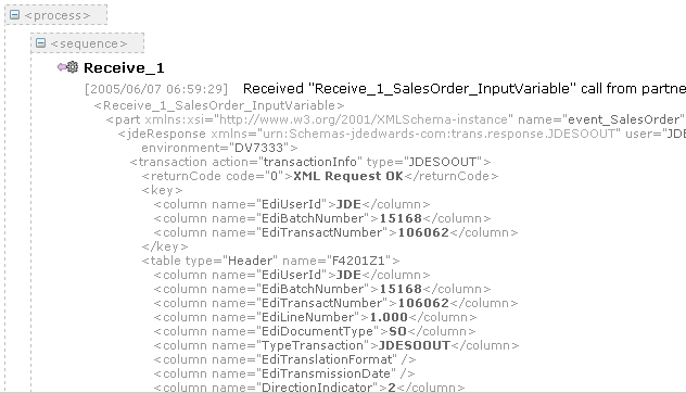

  1. Log in to Oracle BPEL Console at
    http://host:port/BPELConsole
  2. Provide a valid user name and password.
  3. Click the Instances tab.
    Recently received runtime events are displayed in the Instances tab.
    Instances tab
  4. Click your J.D. Edwards event instance, and then click Audit to see the received event message.
    Audit tab
