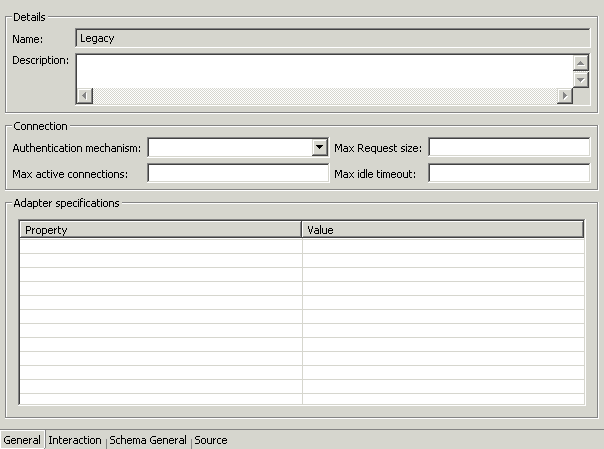

General Tab
Use the General tab to maintain information describing the adapter and the connection to the adapter.
The General tab is shown in the following figure:
Figure A-1 The General tab
The General tab.
Description of "Figure A-1 The General tab"
The General tab comprises fields, as listed in the following table:
Table A-1 General tab Components
Field Description
Adapter definition name
Specifies the name of the adapter definition.
Description
Specifies an identifying description of the adapter.
Authentication mechanism
Specifies the authentication method used to access the adapter. The available mechanisms are:
kerbv5
none
basic password
Max request size
Specifies the maximum size in bytes for an XML request or reply. Larger messages are rejected with an error.
Max active connections
Specifies the maximum number of simultaneous connections for an adapter (per process).
Max idle timeout
Specifies the maximum time, in seconds, that an active connection can stay idle. After that time, the connection is closed.
Adapter Specifications
Specifies the adapter-specific properties for an interaction. The IMS/TM back-end adapter does not have any adapter-specific properties.

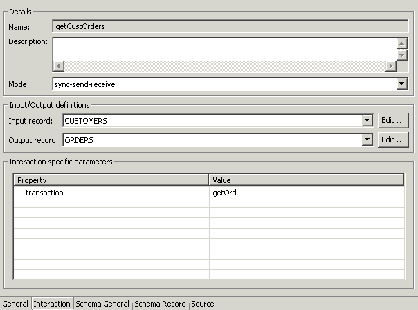

Interaction Tab
Use the Interaction tab to define the general details of the interaction in addition to its input and output definitions.
The Interactions tab is shown in the following figure:
Figure A-2 The Interactions tab
The adapter metadata Interaction tab.
Description of "Figure A-2 The Interactions tab"
The Interaction tab comprises fields, as listed in the following table:
Table A-2 Interaction tab Components
Field Description
Interaction name
Specifies the name of the interaction.
Description
Provides a descriptive identifier for the interaction.
Mode
Determines the interaction mode. The following interaction modes are available:
  • sync-send-receive: The interaction sends a request and expects to receive a response.
  • sync-send: The interaction sends a request and does not expect to receive a response.
  • sync-receive: The interaction expects to receive a response.
  • async-send: Not applicable
Input record
Identifies an input record.
Output record
Identifies an output record for the results of an interaction.
Interaction Specific Parameters
Defines the properties and values of parameters specific to an interaction. The transaction property is available, which specifies the IMS/TM transaction that is called when the interaction is executed.

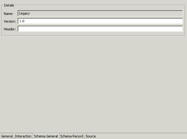

Schema General Tab
Use the Schema General tab to define the general details of the input and output record structures for the interaction.
The Schema General tab is shown in the following figure:
Figure A-3 The Schema General tab
The image shows Schema General tab.
Description of "Figure A-3 The Schema General tab"
The Schema General tab comprises fields, as listed in the following table:
Table A-3 Schema General tab Components
Field Description
Schema name
The name of the adapter.
Version
The schema version.
Header
A C header file to map between the data structure and the adapter.

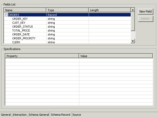

Schema Record Tab
Use the Schema Record tab to define the input and output record structures for the interaction.
The Schema Record tab is shown in the following figure:
Figure A-4 The Schema Record tab
The adapter metadata Schema Record tab.
Description of "Figure A-4 The Schema Record tab"
The Schema Record tab comprises fields, as listed in the following table:
Use the Fields List area to define single data items within a record.
Table A-4 Schema Record tab Components
Field Description
Name
Specifies the name of the field.
Type
The data type of the field. The following are valid data types:
  • Binary
  • Boolean
  • Date
  • Double
  • Float
  • Int
  • Long
  • Numeric
  • Short
  • String
  • Time
  • Timestamp
  • XML
See Also: Appendix B, "Back-end Adapter Data Type Support" for details about the mapping from COBOL data types to IMS/TM back-end adapter data types.
Length
The size of the field including a null terminator, when the data type supports null termination.
Use the Specifications box to specify field properties.
See Also:
Appendix B, "Back-end Adapter Data Type Support" for details about the mapping from COBOL data types to Oracle Connect data types.

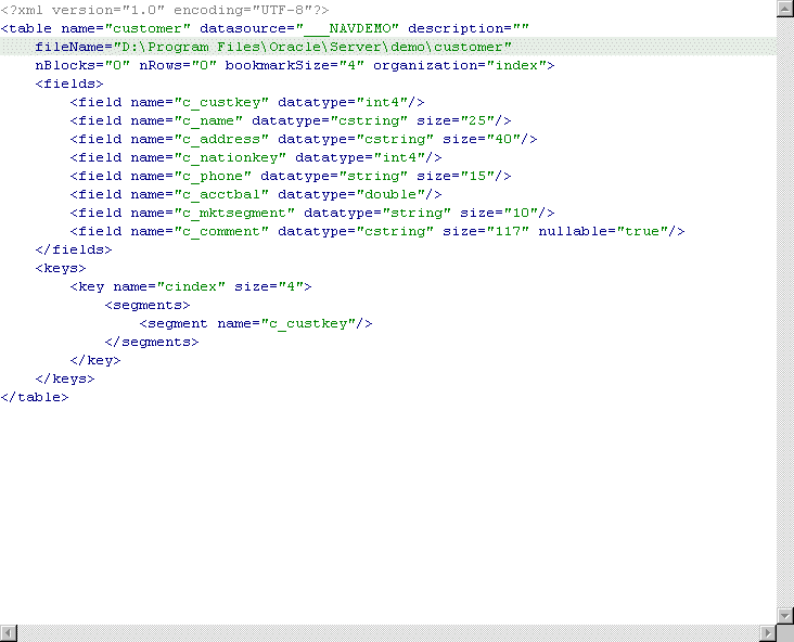

Source Tab
The Source tab displays the XML representation of the adapter metadata.
A sample Source tab is displayed in the following figure:
Figure A-5 The Source tab
A sample XML as shown in the Source tab
Description of "Figure A-5 The Source tab"
