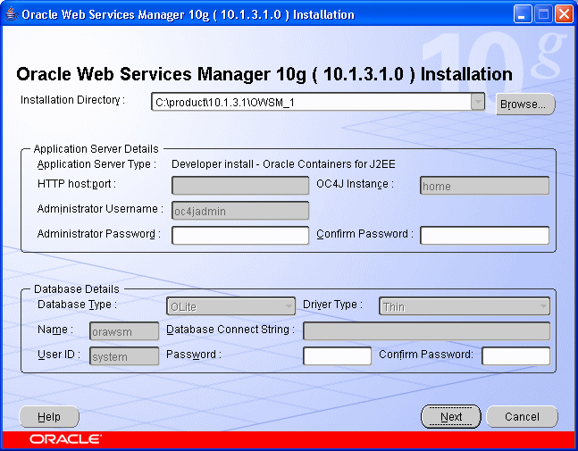

Choose an installation directory and install mode
Figure 3-1 shows the Oracle Web Services Manager 10g (10.1.3.1.0) Installation screen.
This screen requires you to specify the directory where you want to install Oracle Web Services Manager 10g (10.1.3.1.0). If you specify a new directory, Oracle Universal Installer will perform a Basic installation. If you specify an existing Oracle home, it will perform an Advanced installation. On a system with existing installations, you can choose from a list. Click Browse to browse the file system. The existing instance must be Oracle Application Server 10g Release 3 (10.1.3.1) or later.
Note: The Oracle WSM Basic and Advanced installations types are sometimes referred to as Developer and Production installations, respectively. The Application Server Type on Oracle Web Services Manager 10g (10.1.3.1.0) Installation screen is listed as Developer install if you have specified a new directory and Advanced install if you have specified an existing Oracle home. |
Provide Application Server Details
The Application Server Details section of the Welcome screen contains the following fields:
This is an informational field that you cannot change. It contains Basic Install or Advanced Install, followed by Oracle Containers for J2EE.
HTTP Host:Port
For a Basic installation, this field is disabled. The installer will use the current system as the host and port 3115. For a Advanced installation, specify the fully-qualified host and port of the HTTP listener for the service instance. The format is host:port.
OC4J Instance
For a Basic installation, this field is set to home and cannot be changed. For a Advanced installation, specify the instance into which the applications should be deployed.
Administrator Username
For a Basic installation, this field is set to oc4jadmin and cannot be changed. For a Advanced installation, the default is oc4jadmin, but you can change it to a different username. This user must have permission to create and delete shared libraries and to deploy and undeploy applications.
Administrator Password
Specify a password for the administrator. In a Basic installation, you set the password using this field and confirm it in the next field. Passwords are subject to the following restrictions:
The minimum length is 5 characters.
The maximum length is 30 characters.
At least one of the characters must be a number.
Passwords can contain only alphanumeric characters from your database character set, the underscore (_), the dollar sign ($), and the number sign (#).
Passwords must begin with an alphabetic character. Passwords cannot begin with a number, the underscore (_), the dollar sign ($), or the number sign (#).
Passwords cannot be Oracle reserved words. The Oracle Database SQL Reference lists the reserved words. You can find this guide on Oracle Technology Network (http://www.oracle.com/technology/documentation). Or you can just avoid using words that sound like they might be reserved words.
For an Advanced installation, specify the current administrator password.
Confirm Password
For a Basic installation, confirm the password you chose for the administrator. This field is disabled in an Advanced installation.
Provide Database Details
The Database Details section of the Welcome screen contains the following fields:
Database Type
For a Basic installation on Windows, this field is set to OLite. For a Basic installation on Linux and for an Advanced installation, this field is set to Oracle. You cannot change this field.
Driver Type
For the OLite database, this field is set to Thin and you cannot change it. For Oracle Database, select Thick or Thin as the JDBC driver type.
Name
For the OLite database, this field is set to orawsm and you cannot change it. For Oracle Database, specify the database service name.
Database Connect String
For the OLite database, this field is not used. For Oracle Database, specify the fully-qualified host name and the port. For a single database server the format is host:port. For a RAC database, the format is host1:port1^host2:port2...
User ID
For the OLite database, this field is not used. For Oracle Database, specify the User ID (schema). The default is ORAWSM.
Password
For OLite, you set the password using this field and confirm it in the next field. For Oracle Database, specify the current password for the specified user.
Confirm Password
For OLite, confirm the password you chose for the system user. This field is disabled for Oracle Database.

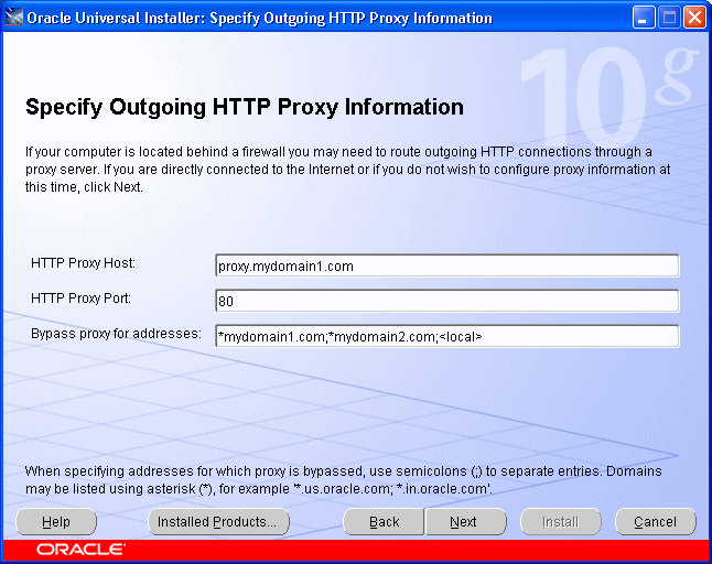

Specify outgoing HTTP proxy information for your installation.
If your computer is located behind a firewall, specify the following information:
HTTP Proxy Host
The fully-qualified name of the proxy host, for example: www-proxy.mydomain.com
HTTP Proxy Port
The port to connect to on the proxy host, for example: 80
Bypass Proxy for Addresses:
A list of addresses for which the proxy should be bypassed, for example:
*mydomain.com;*mydomain2.com
You can specify the local host as either localhost or <local>.
If you have set proxy information in a browser, Oracle Universal Installer uses that information as the default. Figure 3-3 shows a sample setting.
Note: If you specify a proxy host and port, and you have configured or will configure the Oracle WSM applications to communicate with each other through thelocalhost interface (the default), then you must specify localhost in the Bypass Proxy for Addresses field. If you do not do so, requests for localhost will be directed to your proxy server, which will usually result in an error. |
Click Next.

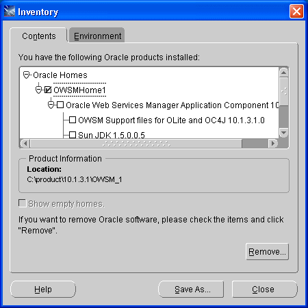

In the Inventory panel, check the instance you want to remove.Figure 3-3 shows an Inventory panel with OWSMHome1 selected.
Click Remove.
To uninstall the product, click Yes in the Confirmation dialog that follows. Click No to cancel the removal.
Tip: You can uninstall Oracle products from any instance of Oracle Universal Installer by using the Inventory panel. Select the products you want to remove and click Remove. |
A progress bar appears. When Oracle Universal Installer has finished uninstalling the product, the Inventory panel will no longer show the product you selected for removal. Close Oracle Universal Installer.
