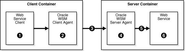

Figure 6-3 illustrates how Oracle WSM client agents and server agents are used. In actual business-to-business situations, the client or the server may not have Oracle WSM. Because Oracle WSM implements industry standards such as WS-Security, Oracle WSM Agents are compatible with other standards-compliant security systems.
Figure 6-3 Using Oracle WSM Client and Server Agents to Enforce Policies
Description of Figure 6-3 follows
Description of "Figure 6-3 Using Oracle WSM Client and Server Agents to Enforce Policies"
The numbers in Figure 6-3 correspond to the following steps that describe how a client request to a server application is intercepted by the Oracle WSM Agents:
  1. The Web service client makes a request to the Web service.
  2. The Oracle WSM Client Agent intercepts the outgoing request and enforces the policies in its Request pipeline.
  3. After the policy steps have been successfully executed by the Oracle WSM Client Agent, the request is sent to the Web service.The Oracle WSM Server Agent intercepts the incoming request and enforces the policies defined in its Request pipeline.
  4. After the policy steps have been successfully executed by the Oracle WSM Server Agent, the request is passed on to the Web service.
  5. The Web service processes the request.
