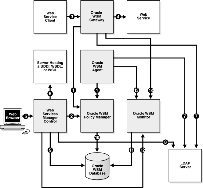

Figure 4-1 is a basic deployment of Oracle WSM and shows which components communicate with each other. The arrows start where the connection is initiated and end where the connection terminates. For example, one connection is initiated by the Web Service Client to the Oracle WSM Gateway. Table 4-4 describes each of the connections, the type of information being transmitted, and the supported transport protocols. For those connections that can be secured using SSL, Table 4-4 provides a link to the section in this chapter that describes how to configure the secure connection.
Figure 4-1 Oracle WSM Deployment Showing Component Connections
Table 4-4 Description of Connections Between Oracle WSM Components
| Figure Number | Description of the Connection Between Components | Supported Secure Transport Protocols | For Information on How to Configure Secure Connections |
1 |
The Policy Enforcement Points initiate an SSL connection over HTTP with Oracle WSM Policy Manager. The PEPs retrieve policy information and use it to enforce security on Web services. |
SSL over HTTP |
"Securing PEPs to Oracle WSM Policy Manager" |
2 |
Web Services Manager Control initiates an SSL connection over HTTP with Oracle WSM Policy Manager. It sends updates to policies and retrieves and displays policy information in its user interface. Web Services Manager Control acts as a client for the SSL connection. |
SSL over HTTP |
"Securing Web Services Manager Control to Oracle WSM Policy Manager" |
3 |
Web service clients can open connections to Oracle WSM Gateways over transport protocols such as HTTP, JMS, and MQ Series. Each of these protocols can be secured using SSL. The same connection is used to send the Web service request and to receive the response. |
SSL over HTTP, JMS, or MQSeries |
"Securing a Web Service Client to Oracle WSM Gateway" |
4 |
The Oracle WSM Gateway can open connections to a Web service over transport protocols such as HTTP, JMS, and MQ Series. Each of these protocols can be secured using SSL. The same connection is used to send the Web service request and to receive the response. |
"Securing Oracle WSM Gateway to a Web Service" |
5 |
When an administrator connects to Web Services Manager Control, the Web browser can initiate an SSL connection over HTTP. |
SSL over HTTP |
"Securing Connections to Web Services Manager Control" |
6 |
A Web service can be registered to an Oracle WSM Gateway by looking up a WSDL from a server hosting a WSDL, UDDI, or a WSIL file. Web Services Manager Control acts as a client to the server. This connection can be secured over SSL. |
SSL over HTTP |
"Registering a Service from a Secure WSDL" |
7 |
The Policy Enforcement Points can authenticate and authorize users against an LDAP Server. The gateway or agent acts as a client for the LDAPS connection. |
SSL over LDAP |
"Securing PEPs to an LDAP Server" |
8 |
When users log in to Web Services Manager Control, they may be authenticated against an LDAP Server. The connection from Web Services Manager Control to the LDAP Server can be secured over SSL. |
SSL over LDAP |
"Securing Web Services Manager Control to an LDAP Server" |
9 |
Web Services Manager Control sends data updates to Oracle WSM Database and retrieves data from Oracle WSM Database which it displays in its user interface over JDBC. SSL over JDBC connections to the Oracle WSM Database are not certified. |
No secure transport protocols are supported. |
Not Applicable |
10 |
Oracle WSM Policy Manager sends information to and retrieves information from Oracle WSM Database over JDBC. SSL over JDBC connections to the Oracle WSM Database are not certified. |
Not Applicable |
11 |
Oracle WSM Monitor sends monitoring data to and retrieves data from Oracle WSM Database over JDBC. SSL over JDBC connections to the Oracle WSM Database are not certified. |
Not Applicable |
12 |
Web Services Manager Control retrieves and displays monitoring charts and reports from Oracle WSM Monitor over RMI. SSL over RMI connections to Oracle WSM Monitor are not certified. |
Not Applicable |
13 |
Oracle WSM Agents and Oracle WSM Gateways send monitoring data to Oracle WSM Monitor over RMI. SSL over RMI connections to Oracle WSM Monitor are not certified. |
Not Applicable |
