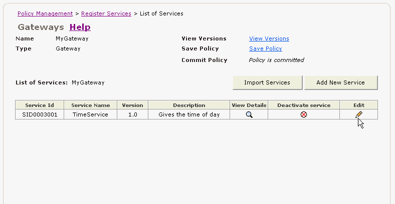

  3. In the List of Services, click Edit for the service (Figure B-1).

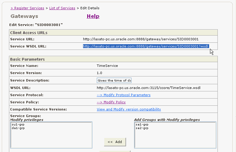

  4. In the Edit Service page, copy the URL in the Service WSDL URL field (Figure B-2).

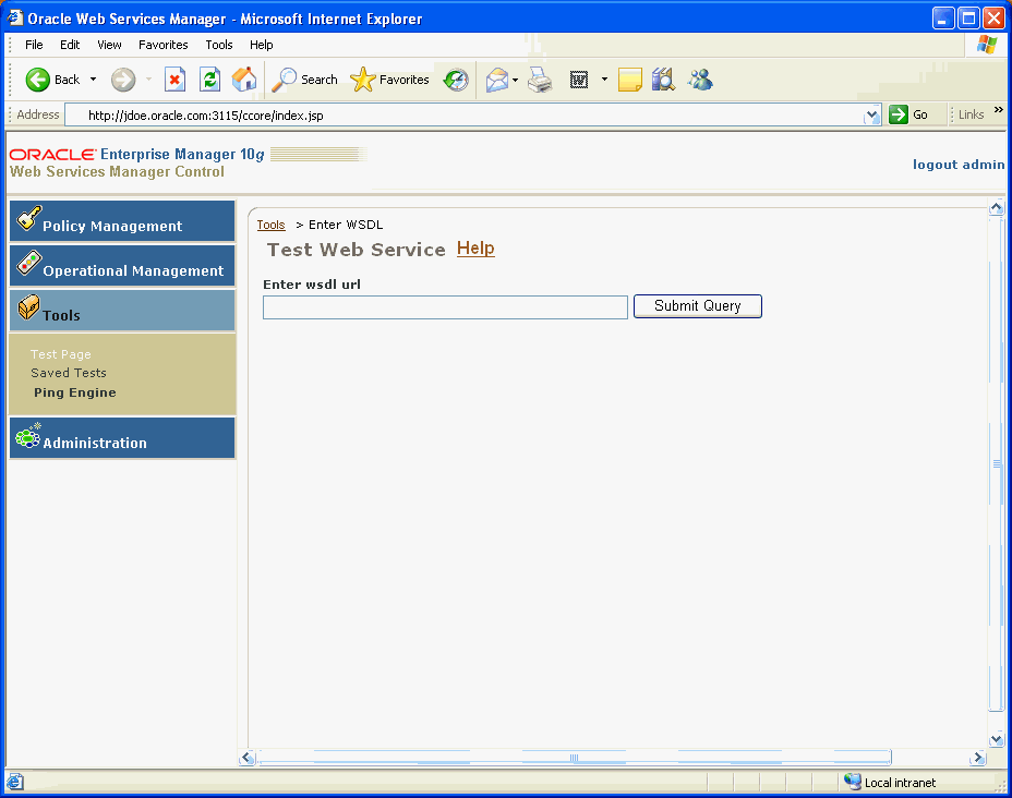

  1. From the navigation pane of Web Services Manager Control, select Tools, then select Test Page to display the Test Web Service page. (Figure B-3).
    Figure B-3 Test Web Service Page
    Description of Figure B-3 follows
    Description of "Figure B-3 Test Web Service Page"
  2. Enter the WSDL URL in the box, and click Submit Query.

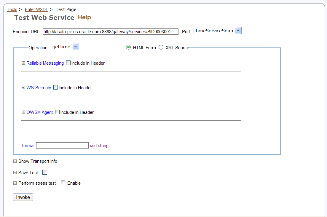

    The page refreshes (Figure B-4) and displays the endpoint URL of the WSDL and the port. Use Port to specify the protocol and network address used to access the Web service. You can configure your test to perform different tasks as described in the sections that follow.

Editing Values in the Test Web Service Page
The Test Web Service page allows you to test any of the operations exposed by a JAX-RPC or REST Web service. By default, the parameters and attributes that can be edited are displayed in an HTML form. Optional parameters and attributes on the form are indicated by a check box.
Select the check box to provide a value for the parameter.
To distinguish attributes from parameters in the HTML Form, attributes are preceded with an at sign (@).
Use the Operation list to select the Web service operation that you want to test.
A plus sign (+) in the form indicates that you can add additional copies of a structure.
The letter X in the form indicates that you can remove copies of a structure that you do not want to use.

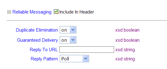

Select the Reliable Messaging check box to indicate that reliability features will participate in the test. A reliability SOAP header will be inserted into the SOAP envelope of the request. Figure B-5 shows the parameters you can set.
  • Duplicate Elimination – Turning this feature on inserts the Duplicate Elimination reliability header into the message. This tells the reliable end point to eliminate duplicates of the messages that will be sent. The default value is on.
  • Guaranteed Delivery – Turning this feature on inserts the Guaranteed Delivery reliability header into the message. This tells the reliable end point that it must acknowledge receiving the message. The default value is on.
  • Reply to URL – Indicates the URL to which acknowledgments and faults will be sent for messages that want asynchronous acknowledgments. The URL is typically the host name of the client, with the port that the listener is on.
  • Reply Pattern – Indicates how the client can interact with the end point. The valid values are: Callback (asynchronous acknowledgment or fault), or Poll (the acknowledgment or fault must be polled for). The default value is Poll.

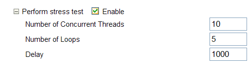

Select the Perform Stress Test check box to display the options to create and configure a continuous series of invocations of the JAX-RPC or REST Web service operation (Figure B-9).
Figure B-9 Stress Testing Parameters on the Test Web Service Page
Description of Figure B-9 follows
Description of "Figure B-9 Stress Testing Parameters on the Test Web Service Page"
When you invoke the test, a stress report page is returned. The report page identifies the service end point and operation being tested, the size of the message sent, the number of concurrent threads on which it is run, the number of times it is run on each thread, and the delay between each operation invocation.
