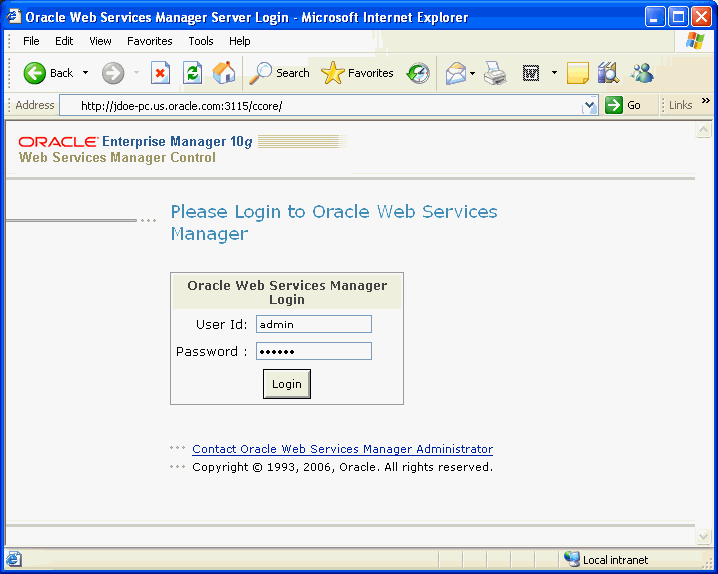

  • If JSSO is not enabled – Oracle WSM displays a login page (Figure 1-1). Enter a user name and password for the Oracle WSM administrator. By default the user name is admin and the password is oracle.
    Figure 1-1 Oracle Web Services Manager Login Page
    Description of Figure 1-1 follows
    Description of "Figure 1-1 Oracle Web Services Manager Login Page"

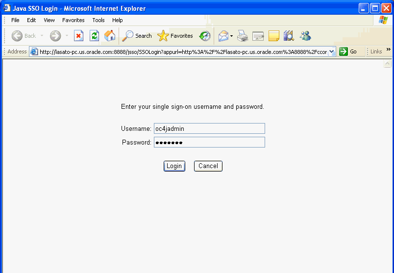

  • If JSSO is enabled – Oracle WSM displays a different login page, one that looks like Figure 1-2. Log in using the OC4J (Oracle Containers for J2EE) administrator user name and password.
Figure 1-2 Oracle Web Services Manager Login Page
Description of Figure 1-2 follows
Description of "Figure 1-2 Oracle Web Services Manager Login Page "

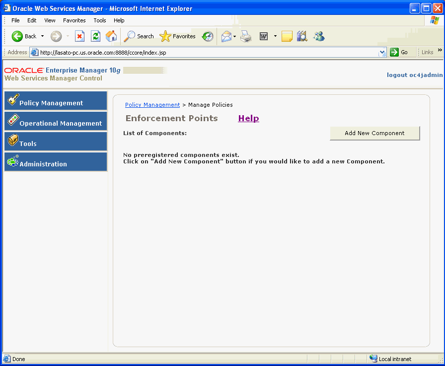

After logging in to Web Services Manager Control, the following page is displayed (Figure 1-3).
Figure 1-3 Web Services Manager Control
Description of Figure 1-3 follows
Description of "Figure 1-3 Web Services Manager Control"
