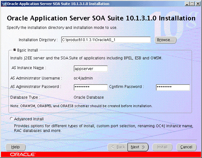

Oracle Application Server SOA Suite 10.1.3.1.0 Installation Screen
Figure 4-1 Oracle Application Server SOA Suite 10.1.3.1.0 Installation Screen
Installation Directory: Enter the directory where you want install Oracle Application Server.
Select Basic Install.
AS Instance Name: The instance name identifies this Oracle Application Server instance. If you have more than one Oracle Application Server instance on the same host, the instances must have unique names.
AS Administration Username: The administration username for Oracle Application Server instances is set to oc4jadmin and cannot be changed. To manage Oracle Application Server instances using Oracle Enterprise Manager 10g, log in as the oc4jadmin user.
AS Administration Password and Confirm Password: Enter the password for the oc4jadmin user.
Database Type: You must use an Oracle Database in the basic installation. If you want to use a Real Application Clusters database, you must perform an advanced installation. The Oracle Database must have the ORABPEL, ORAESB, and ORAWSM schemas installed. See Section 2.9, "Installing Database Schemas" for more information.
Click Next.

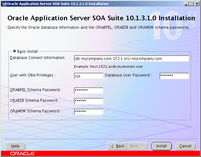

Oracle Application Server SOA Suite 10.1.3.1.0 Installation Screen (Figure 4-2.)
Figure 4-2 Oracle Application Server SOA Suite 10.1.3.1.0 Installation Screen
Database Connect Information: Specify the hostname, port, and service name for the database. Use the format hostname:port:service name.
User with DBA Privileges: Specify the login name for the DBA user.
Database User Password: Enter the password for the user specified in the User with DBA Privileges field.
ORABPEL Schema Password: Enter the password for the ORABPEL schema in the database specified in the Database Connect Information field.
ORAESB Schema Password: Enter the password for the ORAESB schema in the database specified in the Database Connect Information field.
ORAWSM Schema Password: Enter the password for the ORAWSM schema in the database specified in the Database Connect Information field.
