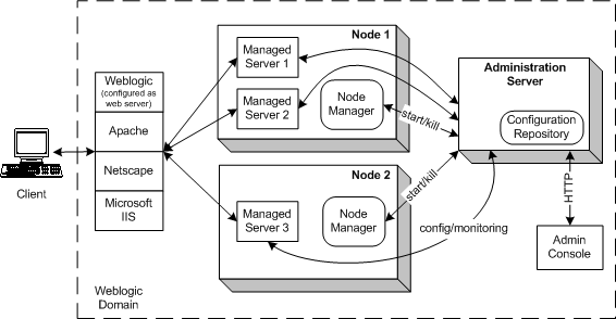

WebLogic Server has several components and concepts peculiar to it. Each WebLogic Server can be configured and deployed either as a Managed Server or an Administration Server. A Managed Server hosts and executes the application logic deployed in it when requests are received from clients. An Administration Server configures and monitors Managed Servers but does not host applications. Figure 2-1 depicts the components in WebLogic Server and their interactions.
In any node, more than one Managed Server can exist. Each Managed Server is a Java process (JVM) executing J2EE containers (Web and EJB). An Administration Server, which is also a Java process, is required to propagate configuration information to Managed Servers when they start-up. The configuration information is stored in the file system on the Administration Server node.
The Administration Server is also used to monitor and log information about individual Managed Servers and the entire WebLogic domain. A WebLogic domain can consist of standalone Managed Servers, clusters of Managed Servers, and one Administration Server. If the Administration Server goes offline, client requests can still be serviced by the Managed Servers. However, configuration information is not available for new Managed Servers to start-up, and monitoring services are not available for server clusters. The Administration Server does not have automatic fail over or replication. Configuration data for the WebLogic domain has to be manually backed up. The Administration Server functions can be accessed through a console GUI (remotely over HTTP) or a command line utility.
In order for the Administration Server to start Managed Servers remotely, a Node Manager must be running on each node where there are Managed Servers. This Node Manager is a Java program executing in the background as a UNIX daemon or Windows service. With the Node Manager, the Administration Server can also kill a Managed Server if the latter hangs or does not respond to commands from the former.
WebLogic Server can also be set up to run as a Web server. In this mode, it supports HTTP 1.1 and resolves client requests to Managed Servers based on the settings in the XML configuration files. Instead of WebLogic Server, third-party proxy plug-ins can also be used for servicing HTTP requests. Supported plug-ins are Apache, Netscape, and Microsoft IIS.

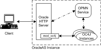

An OracleAS instance is a runtime occurrence of an installation of Oracle Application Server. An Oracle Application Server installation has a corresponding Oracle home where the Oracle Application Server files are installed. Each Oracle Application Server installation can provide only one OracleAS instance at runtime. A physical node can have multiple Oracle homes, and hence, more than one Oracle Application Server installation and OracleAS instance.
Each OracleAS instance consists of several interoperating components that enable Oracle Application Server to service user requests in a reliable and scalable manner. These components are:
Oracle Application Server contains two listeners: Oracle HTTP Server (based on the Apache open source project) and the listener that is part of OC4J, which runs in a separate thread of execution. Each OracleAS instance has one Oracle HTTP Server.
The OC4J listener listens to requests coming from the mod_oc4j module of the Oracle HTTP Server and forwards them to the appropriate OC4J process. From a functional viewpoint, the Oracle HTTP Server acts as a proxy server to OC4J, wherein all servlet or JSP requests are redirected to OC4J processes.
mod_oc4j communicates with the OC4J listener using the Apache JServ Protocol version 1.3 (AJP 1.3). mod_oc4j works with the Oracle HTTP Server as an Apache module. The OC4J listener can also accept HTTP and RMI requests, in addition to AJP 1.3 requests.
The following diagram depicts Oracle HTTP Server and other Oracle Application Server runtime components in a single instance of Oracle Application Server.
Figure 2-2 Components of an OracleAS Instance

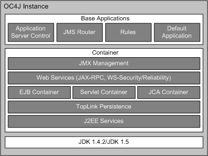

An OC4J instance is a logical instantiation of the OC4J implementation in Oracle Application Server. This implementation is Java 2 Enterprise Edition (J2EE) 1.4 complete and written entirely in Java. It executes on the standard Java Development Kit (JDK) 1.4.2 and 5.0 Java Virtual Machine (JDK 5.0 is installed with Oracle Application Server). It has a lower disk and memory footprint than other Java application servers. Note that each OC4J instance can consist of more than one JVM process where each process can be executing multiple J2EE containers. The number of JVM processes can be specified for each OC4J instance using the Oracle Enterprise Manager 10g Application Server Control Console GUI.
OC4J can be installed and run in standalone configuration. In this configuration, the OC4J listener directly accepts client requests as Oracle HTTP Server is not installed. Another component that is not installed is the Oracle Process Manager and Notification Server, which performs process monitoring and management functions. Hence, in standalone configurations, OC4J is unmanaged.
Figure 2-3 J2EE Architecture in Oracle Application Server
The logical architecture of an OC4J instance, as depicted in Figure 2-3, consists of the following components:
JMX
The Application Server Control Console user interface is built on a JMX-compliant client that can be used to completely manage and monitor an OC4J instance. The JMX functionality provided through Application Server Control Console is enabled through Java components known as MBeans. An MBean, or managed bean, is a Java object that represents a JMX manageable resource. MBeans are defined in the J2EE Management Specification (JSR-77), which is part of the J2EE 1.4 specification as published by Sun Microsystems. For more information on MBeans, see Oracle Containers for J2EE Configuration and Administration Guide and Oracle Containers for J2EE Services Guide.
Web Services
OC4J provides full support for Web Services in accordance with the J2EE 1.4 standard, including JAX-RPC 1.1 (WebLogic Server 8.1 supports up to JAX-RPC 1.0). Web services interoperability is also supported. See Oracle Application Server Web Services Developer's Guide.
EJB, Servlet, JCA containers
OC4J implements the full J2EE 1.4 container functionality for EJB, servlet, and JCA. It provides clustering features to enable container components for availability and scalability.
Oracle TopLink persistence layer
TopLink provides a Java object-to-relational mapping persistence architecture. It provides a highly flexible and productive mechanism for storing Java objects and EJBs in relational database tables enabling developers to focus on pure object-oriented design and methodologies. In this release of Oracle Application Server, EJB container-managed persistence is integrated with TopLink. TopLink container-managed persistence is the default container-managed persistence provider. Rich user interface tools in TopLink Workbench and Oracle JDeveloper 10g allow developers to configure object-relational mapping quickly and easily. For existing container-managed EJBs, a migration utility is provided to automate migration to TopLink container-managed persistence. See Section A.3, "Oracle TopLink", Oracle TopLink Getting Started Guide for more information on TopLink.
