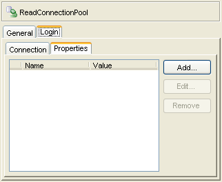

Configuring Properties
For all connection pools, except write connection pools, you can specify arbitrary named values, called properties.
Some data sources require additional, driver-specific properties not supported in the ConnectionPool API. Add these properties to the ConnectionPool so that TopLink can pass them to the driver.
Using TopLink Workbench
To specify arbitrary named value pairs that TopLink associates with a ConnectionPool, use this procedure:
  1. Expand a server session to reveal its connection pools in the Navigator.
  2. Select a read, named, or sequence connection pool in the Navigator. Its properties appear in the Editor.
  3. Click the Login tab. The Login tab appears.
  4. Click the Properties subtab. The Properties subtab appears.
    Figure 86-2 Login Tab, Properties Subtab
    Description of Figure 86-2 follows
    Description of "Figure 86-2 Login Tab, Properties Subtab"
Use the following information to add or edit a login property on the Add Property dialog box to add or edit a login property:
Option Description
Name The name by which TopLink retrieves the property value using the DatasourceLogin method getProperty.
Value The value TopLink retrieves using the DatasourceLogin method getProperty passing in the corresponding property name.
Using TopLink Workbench, you can set only character values which TopLink returns as String objects.
To add (or change) a new Name/Value property, click Add (or Edit).
To delete an existing property, select the Name/Value row and click Remove.
Using Java
Using Java, you can set any Object value using the DatasourceLogin method setProperty. To remove a property, use the DatasourceLogin method removeProperty.

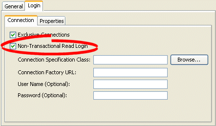

Configuring a Nontransactional Read Login
When you use an external transaction controller (see "Configuring the Server Platform"), establishing a connection requires not only the usual connection setup overhead, but also transactional overhead. If your application reads data only to display it and only infrequently modifies data, you can configure an internal read connection pool to use its own connection specification that does not use the external transaction controller. This may improve performance by reducing the time it takes to establish a new read connection.
To enable the configuration of nontransactional connection information for a TopLink read connection pool, use this procedure:
  2. Select a read connection pool in the Navigator. Its properties appear in the Editor.
  4. Click the Connection subtab. The Connection subtab appears.
    Figure 86-3 Login Tab, Connection Subtab
    Description of Figure 86-3 follows
    Description of "Figure 86-3 Login Tab, Connection Subtab"
To enable a nontransactional read login, select the Use Non-Transactional Read Login option (see "Externally Managed Transactional Data Sources"). Continue with "Configuring Connection Pool Connection Options" to specify the connection information.

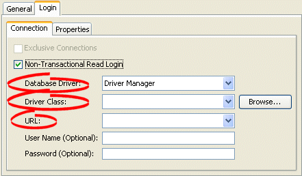

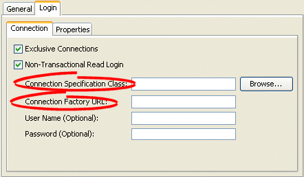

  5. Ensure the Use Non-Transaction Read Login option is selected.
Use the following information to complete fields on the Connection subtab:
Field Description
Database DriverFoot 1  Specify the appropriate database driver:
  • Driver Manager: Specify this option to configure the driver class and URL used to connect to the database. In this case, you must configure the Driver Class and Driver URL fields.
  • J2EE Datasource: Specify this option to use a J2EE data source already configured on your target application server. In this case, you must configure the Datasource Name field.
Note: If you select J2EE Datasource, you must use external connection pooling. You cannot use internal connection pools with this Database Driver option (for more information, see "Configuring External Connection Pooling").
Driver ClassFootref 1 Configure this field when Database Driver is set to Driver Manager. Select from the menu of options. This menu includes all JDBC drivers in the TopLink application classpath.
URLFootref 1 Configure this field when Database Driver is set to Driver Manager. Select from the menu of options relevant to the selected Driver Class and edit the URL to suit your data source.
Datasource NameFootref 1 Configure this field when Database Driver is set to J2EE Datasource. Specify any valid JNDI name that identifies the J2EE data source preconfigured on your target application server (For example: jdbc/EmployeeDB).
By convention, all such names should resolve to the JDBC subcontext (relative to the standard java:comp/env naming context that is the root of all provided resource factories).
Connection Specification ClassFoot 2  Specify the appropriate connection specification class for the selected Platform. Click Browse to choose from all the classes in the TopLink classpath. (For example: if Platform is oracle.toplink.eis.aq.AQPlatform, use oracle.toplink.eis.aq.AQEISConnectionSpec).
For more information on platform configuration, see "Configuring an EIS Data Source Platform at the Session Level".
Connection Factory URLFootref 2 Specify the appropriate connection factory URL for the selected Connection Specification Class (For example: jdbc:oracle:thin@:localhost:1521:orcl).

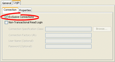

Configuring Exclusive Read Connections
An exclusive connection is one that TopLink allocates specifically to a given session and one that is never used by any other session.
Allowing concurrent reads on the same connection reduces the number of read connections required and reduces the risk of having to wait for an available connection. However, many JDBC drivers do not support concurrent reads.
If you are using internal connection pools (see "Internal Connection Pools"), you can configure TopLink to acquire an exclusive connection from the read connection pool.
By default, TopLink acquires exclusive read connections.
If you are using external connection pools, read connections are always exclusive.
To configure a TopLink read connection pool to allocate exclusive connections, use this procedure:
    Figure 86-6 Login Tab, Connection Subtab, Exclusive Connections Option
    Description of Figure 86-6 follows
    Description of "Figure 86-6 Login Tab, Connection Subtab, Exclusive Connections Option"
Select the Exclusive Connections option to configure TopLink to acquire an exclusive connection from the read connection pool.
Deselect the Exclusive Connections option to configure TopLink to share read connections and allow concurrent reads. Before selecting this option, ensure that your JDBC driver supports concurrent reads.
