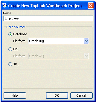

To create a new TopLink Workbench project, use this procedure:
  1. New Project icon
    Click New on the toolbar and select Project. The Create New TopLink Workbench Project dialog box appears.
    You can also create a new project by choosing File > New > Project from the menu.
    Figure 18-1 Create New TopLink Workbench Project Dialog Box
    Description of Figure 18-1 follows
    Description of "Figure 18-1 Create New TopLink Workbench Project Dialog Box"
Use the following information to enter data in each field of this dialog box:
Field Description
Name Enter the name of the TopLink Workbench project. This project name will also become the name of the .mwp file.
Data Source Use these options to specify the type of project to create, and its data source.
    Database Select Database to create an relational project to a relational database.
Use the Platform list to select the specific database platform.
See "Relational Projects" for more information.
    EIS Select EIS to create an EIS project to a nonrelational data source using XML records.
Use the Platform list to specify the J2C adapter to use.
See "EIS Projects" for more information.
   XML Select XML to create a nontransactional, nonpersistent XML project to an XML schema.
Alternatively, you can generate both an XML project and object model classes (see "Creating an XML Project From an XML Schema").
See "XML Projects" for more information.

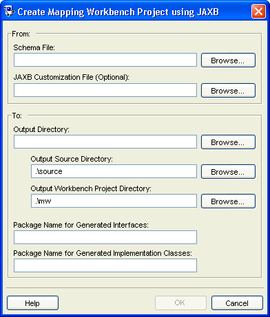

To create a new, mapped TopLink Workbench project from an XML schema using JAXB, use this procedure:
  1. From TopLink Workbench, select File > New > Project > From XML Schema (JAXB).
    Figure 18-2 Create TopLink Workbench Project using JAXB Dialog Box
    Description of Figure 18-2 follows
    Description of "Figure 18-2 Create TopLink Workbench Project using JAXB Dialog Box"
Field Description
From Use these fields to specify your existing JAXB information.
    Schema File Click Browse and select the fully qualified path to your XSD file.
    JAXB Customization File This in an optional setting. It can be used if you have a standard JAXB configuration file that you wish to use to override the default JAXB compiler behavior. The JAXB customization file contains binding declarations for customizing the default binding between an XSD component and its Java representation.
To Use these fields to specify the location and options of the TopLink Workbench project.
    Output Directory Click Browse and select the path to the directory into which generated files are written. All paths used in the project are relative to this directory.
        Output Source Directory Click Browse and select the path to the directory (relative to the Output Directory) into which generated interfaces, implementation classes, and deployment files are written. Default: directory named source in the specified output directory.
        Output Workbench Project Directory Click Browse and select the path to the directory (relative to the Output Directory) into which the TopLink Workbench project files are written. Default: directory named mw in the specified output directory.
    Package Name for Generated Interfaces The optional name of the package to which generated interfaces belong. This defines your context path. If it is not specified, a package name of jaxbderived.<schema name> is used where <schema name> is the name of the schema specified by the Schema File field.
    Package Name for Generated Implementation Classes The optional name of the package to which generated implementation classes belong. This defines your context path. If it is not specified, a package name of jaxbderived.<schema name> is used where <schema name> is the name of the schema specified by the Schema File field.

    Yes
    -schema
    The fully qualified path to your XSD file.
    No
    -targetPkg
    The name of the package to which both generated interfaces and classes belong. This defines your context path. To specify a different package for implementation classes, set the -implClassPkg argument.
    Default: a package name of jaxbderived.<schema name> where <schema name> is the name of the schema specified by the -schema argument.
    Yes
    -implClassPkg
    The name of the package to which generated implementation classes belong. If this option is set, interfaces belong to the package specified by the -targetPkg argument. This defines your context path.
    Yes
    -interface
    Generate only interfaces. This argument is optional.
    Default: generate both interfaces and implementation classes.
    Yes
    -verbose
    The interfaces and classes generated. This argument is optional.
    Default: not verbose.
    Yes
    -customize
    The fully qualified path and file name of a standard JAXB customization file that you can use to override default JAXB compiler behavior.
    Yes
  3. Optionally, open the generated TopLink Workbench project (see "TopLink Workbench Project") in TopLink Workbench, customize the generated mappings and descriptors, and reexport the TopLink project XML.
    Before you compile your generated classes, be sure to configure your IDE classpath to include <ORACLE_HOME>\lib\xml.jar. For example, see Chapter 6, "Using an Integrated Development Environment".

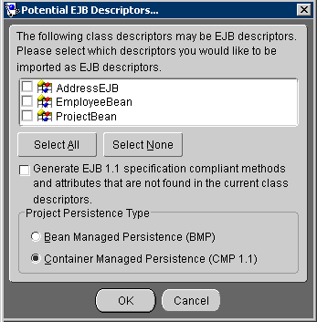

    If you open a TopLink Workbench version 3.n project that contains EJB information, the Potential EJB Descriptors dialog box appears.
    Figure 18-3 Potential EJB Descriptors Dialog Box
    Description of Figure 18-3 follows
    Description of "Figure 18-3 Potential EJB Descriptors Dialog Box"
  3. Select which of the descriptors should be imported as EJB descriptors, the project persistence type, and click OK.
You can also specify whether or not TopLink Workbench generates methods and attributes that comply with the EJB specification, if they are not found within the current class descriptor(s).

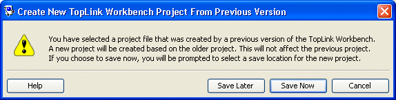

If you open a TopLink Workbench version 9.0.3 (or later) project, the Create New TopLink Workbench Project from Previous Version dialog box appears.
Figure 18-4 Create New TopLink Workbench Project From Previous Version Dialog Box
Description of Figure 18-4 follows
Description of "Figure 18-4 Create New TopLink Workbench Project From Previous Version Dialog Box"
To convert the old project to the current format and view the project immediately, click Save Later.
To convert the old project to the current format and save it to a new location and then view the project, click Save Now.

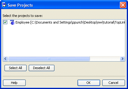

  2. If you close TopLink Workbench while there are currently unsaved changes, the Save Project dialog box appears.
    Figure 18-5 Save Projects Dialog Box
    Description of Figure 18-5 follows
    Description of "Figure 18-5 Save Projects Dialog Box"
  3. Select the project(s) to save and click OK.
    Click Select All to select all the available projects.

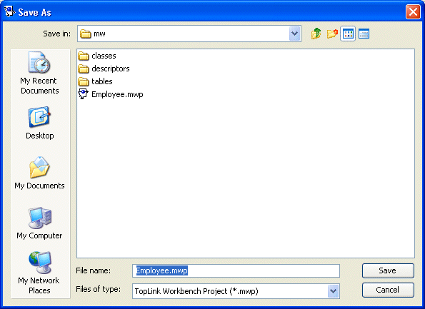

Saving Projects With a New Name or Location
To save your project with a different name or location, use this procedure:
  1. Save As button
    Choose File > Save As. The Save As dialog box appears.
    Figure 18-6 Save As Dialog Box
    Description of Figure 18-6 follows
    Description of "Figure 18-6 Save As Dialog Box"
  2. Select a name and location, then click Save.
Caution:
Do not rename the .mwp file outside of TopLink Workbench. To rename a project, use the Save As option.

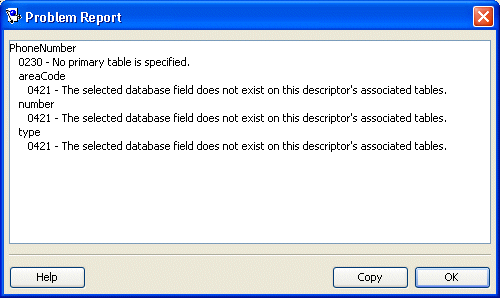

Use the project status report to display a list of all warnings and errors in the TopLink Workbench project. This report is similar to the Problems window (see "Working With TopLink Workbench"), but lets you easily copy and paste the errors into documents or messages. To generate the project status report, use this procedure:
  1. Project Status Report button
    Right-click the Problems label above the Problems window and select Problem Report. The Project Status Report dialog box appears, displaying the status of each TopLink Workbench project.
    You can also generate the project status report by selecting Tools > Problem Report from the menu.
    Figure 18-7 Problem Report Dialog Box
    Description of Figure 18-7 follows
    Description of "Figure 18-7 Problem Report Dialog Box"
See Chapter 14, "TopLink Workbench Error Reference" for information on each reported error.
To copy the report to another application, click Copy.
