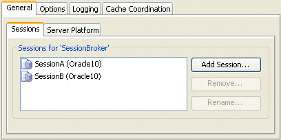

To add sessions to, remove sessions from, or rename sessions in a session broker, use this procedure:
  1. Select a session broker in the Navigator. Its properties appear in the Editor.
  2. Click the General tab. The General tab appears.
  3. Click the Sessions subtab. The Sessions subtab appears.
    Figure 79-1 General Tab, Sessions Subtab
    Description of Figure 79-1 follows
    Description of "Figure 79-1 General Tab, Sessions Subtab"
To manage the sessions in this session broker, choose one of the following:
  • To remove a session, select the session in the Sessions tab's list and click Remove.
  • To rename a session, select the session in the Sessions tab's list and click Rename. The Rename dialog box appears. Enter a new name and click OK.

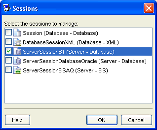

  • To add a session, click Add Session. The Sessions dialog box appears showing a list of all the sessions currently configured in the session configuration that owns this session broker.

    Check the sessions in the Session dialog that you want to add to the session broker and click OK.
